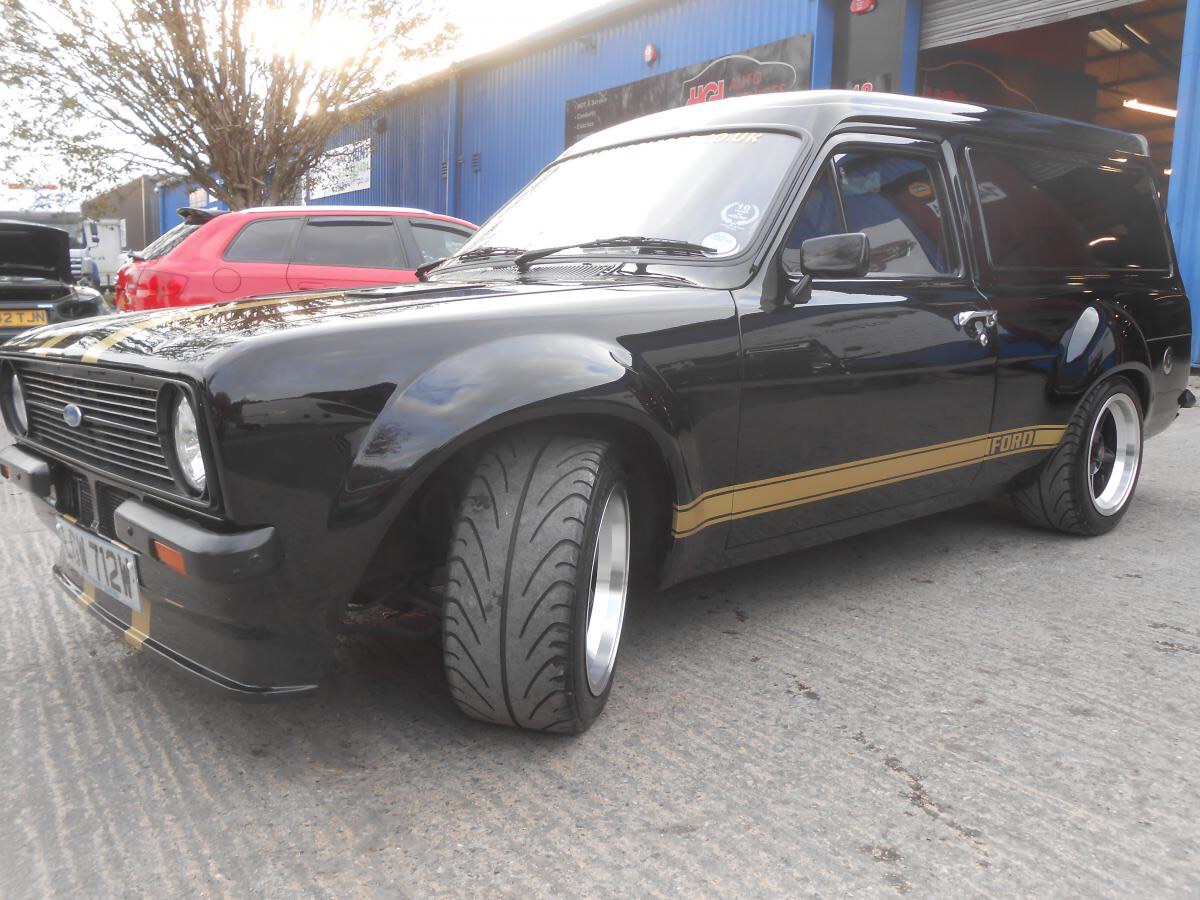

Seeing as Jo mentioned things need improving I decided to update again.
Since my last post I bought another Rs2000 propshaft. Which also failed. So I bit the bullet and bought a Grp4 Fabrications new one. Expensive but I am sick of problems with em.
And the exhaust needs a skid on the silencer as it catches and pulls the pipe loose. Did that today.
Will make a wee bit of clearance between the gearbox bellhousing and the bulkhead while under it.
Photos when I figure out how.
Comments welcome.
Thanks.

Seeing as it is as low a a low thing, the leading edge of the silencer catches stuff.
This I have decided is why the damn thing keeps cracking, leaking and trying to fall off.
So I welded a wee skid on.
Nothing sexy but it should help.

Well it's only worked. So far no issues with it catching.
On to next project.
Replacing my borrowed twin 40 webers with the carbs off a Zzr750rr!
