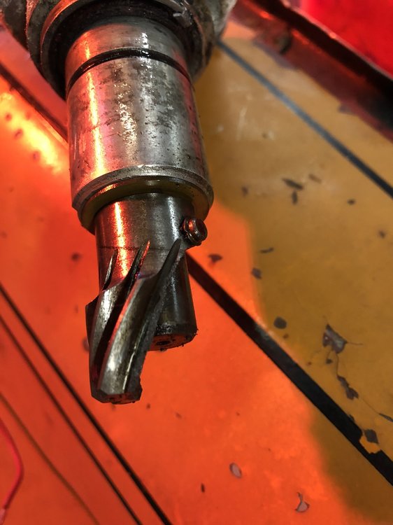

Wow, that engine really clean inside, not done many miles since build.
What happened to the dizzy drive, never had one snap like that, where is the broken bit !!??.
Have scrap dizzy here if you need a drive.
Keep up the updates.
In the sump
