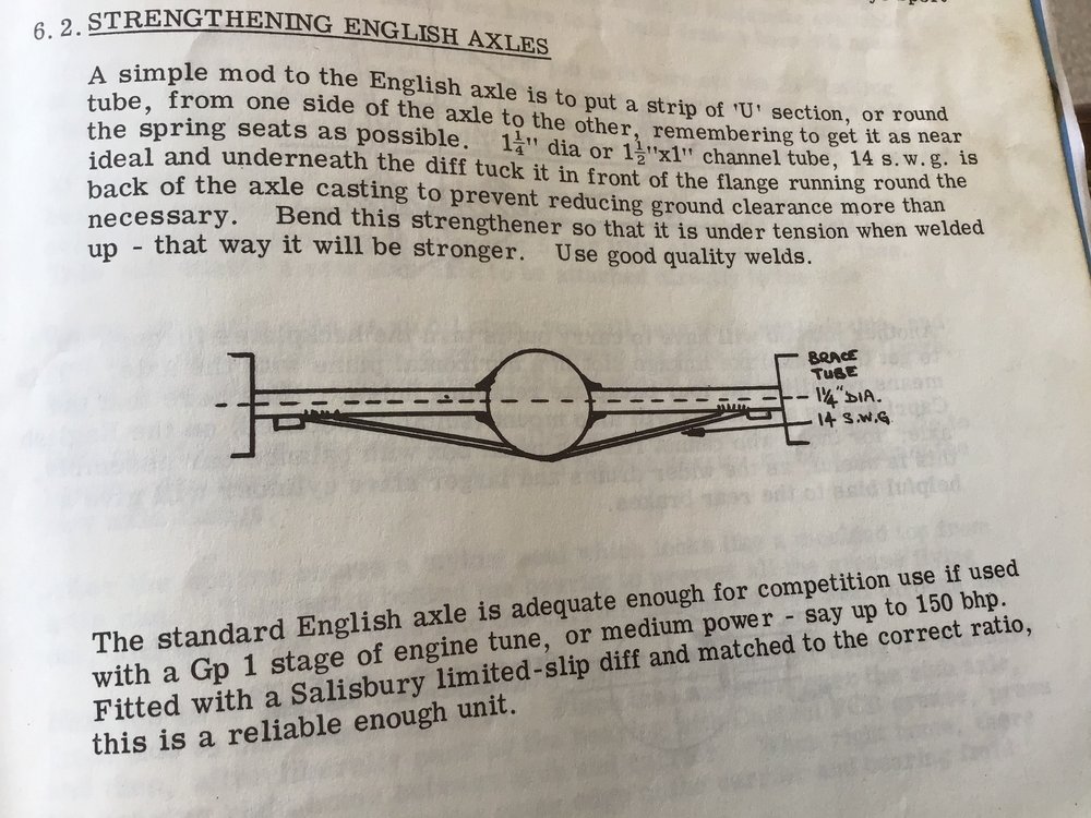

As per the escort rally prep book my english has a piece of 3/4in cds tube welded from the  spring hanger under the diff bowl to the outher side spring hanger.  Carnt hurt it !!!
Any pix?
Share this post
Link to post
Share on other sites

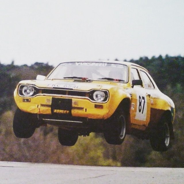

15 hours ago, colr6 said:
Whilst bearing in mind this mod was specifically for Rally cars - jumping, yumping Rally Cars! Never seen it done like this on a road or track focused car - no point as for 99.99% of the time it does nothing!
Share this post
Link to post
Agreed, it clearly states that in the lower paragraph.
Share this post
Link to post
Depends what you want to do with your escort !!!! In my eyes it carnt hurt it by fitting it and being on the safe side. I only did that mod to mine as i had the axle off at the time on the bench at work and thought why not.
