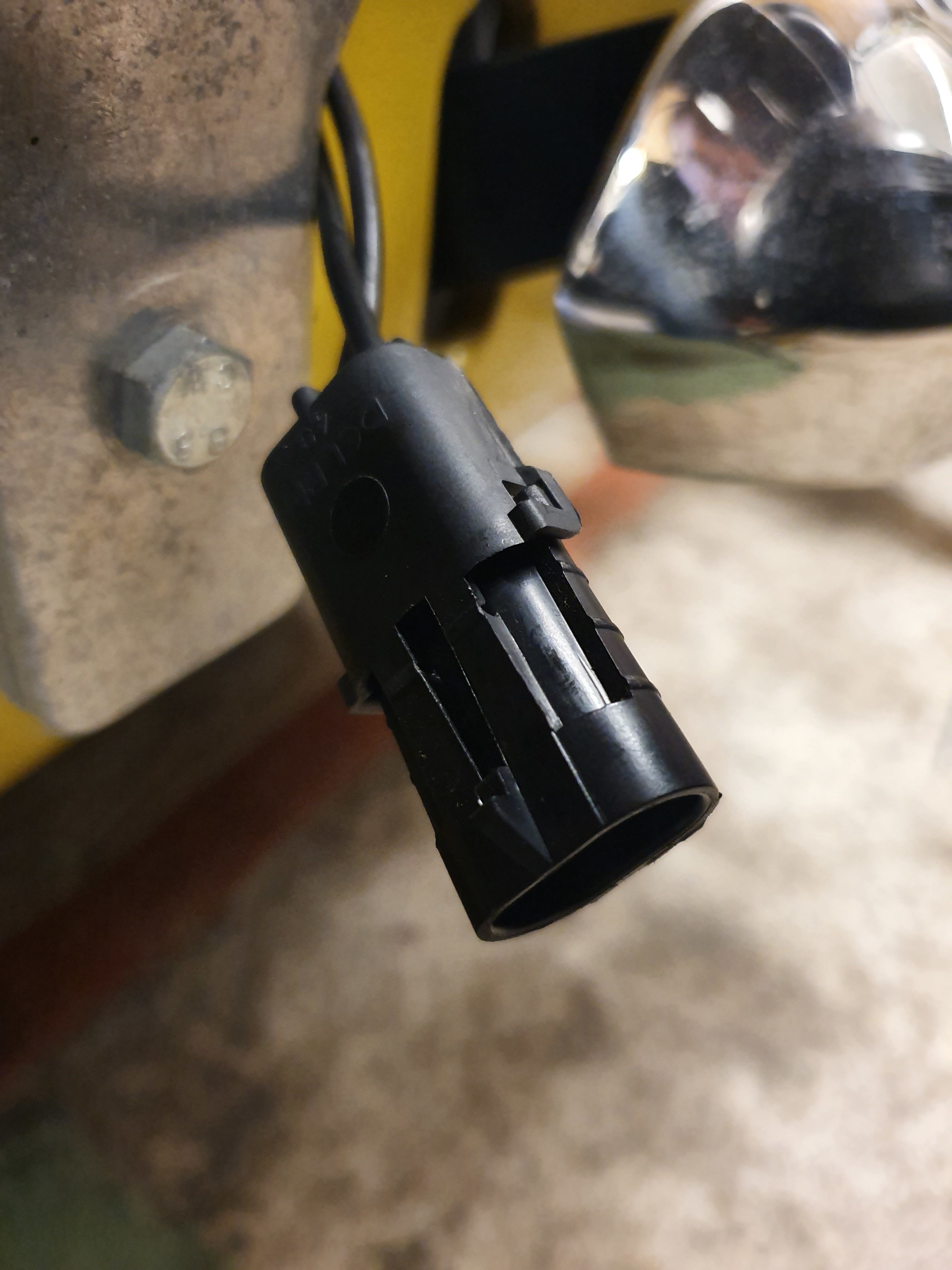

Mexican Gerbil Posted July 18, 2019 Report Share Posted July 18, 2019 Hello. I have attached some pics of the ones I have. Meant to be water tight. Sadly I cant find the packets they came in Link to comment Share on other sites More sharing options...
Mexican Gerbil Posted July 18, 2019 Report Share Posted July 18, 2019 Found them on demon tweeks but come with a bulk head connector now which I didn't have. Also don't remember paying that much. https://www.demon-tweeks.com/uk/atl-clubman-electrical-connector-set-bulkhead-and-quick-release-fittings-atlel-aa-001/ Link to comment Share on other sites More sharing options...
DT36 Posted August 3, 2019 Report Share Posted August 3, 2019 Not sure if you've bought any yet, but these are basically AMP Superseal Connectors. Get them from RS Components or online. Just been looking for some myself, as I've just acquired a nice set of genuine Super Oscars. Link to comment Share on other sites More sharing options...
colr6 Posted August 3, 2019 Report Share Posted August 3, 2019 Got plenty if you need some Dale, use them on my trucks. Supposedly ip67 so watertight. Not the make you’ve quoted bu5 same thing. 1 Link to comment Share on other sites More sharing options...
