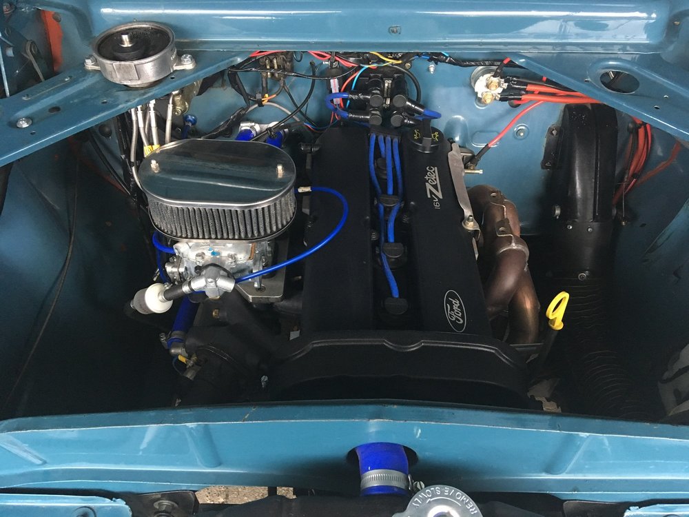

It was built with a 2 litre Zetec with a single carb, discs on the front and drums on the back. The axle is an English axle from I think an Anglia. I had no info with the car, just the receipt for the engine and log book.

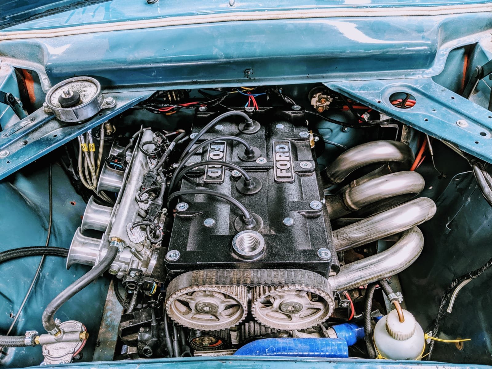

This is where things went a bit west, I promptly blew everything on the back axle. So last winter it had custom made updates half shafts an LSD and new crown wheel, I’ve also lowered the front a little and it’s in the process of having Jenvey throttle bodies added and new free flowing manifold.
The picture below is with bike carbs but have decided against these and have gone with Jenvey’s.
What bike carbs have injectors fitted then? You are unlikely to see a big improvement swapping to Jenvey's unless those have REALLY small throats - just saying like!

The Throttle body kit was from danst engineering and consisted of ZX10r throttle bodies with 330cc injectors. I swapped to Jenveys for drivability reasons rather than power reasons. More gradual throttle response.
I took the advice of a company who build Zetecs for Ginetta race cars.

LOL's - you missed the point - you said CARBS ie carburetor but the picture shows Throttle Bodies, no doubt off a bike. Whilst the ZX10R TB's response may not suit a car, its a big stretch, to imagine that the actuation (usually a quadrant / lever arrangement) couldn't have been adjusted / adapted to give a linear opening rather than swapping out the whole set at not a small expense I imagine! As a biker I know how responsive bike throttles need to be and how they vary - a hand is so much more delicate at control than a foot, and full closed to full open is usually a 1/4 turn at the handlebar grip. The devil on my shoulder says 'what does a race car engine builder know about drivability when majority of time the engine is WOT?' LOL!
The installation pictured admittedly doesn't look 'pretty' but with some work it could work as well as the Jenvey's will. This post isn't intended to change your mind but clarify the position that Jenveys aren't the 'be all & end all' devices compared to alternative throttle bodies when budget is a requirement. They are all, at the end of the day, a tube with a flap and a squirty device!
On my Zetec install, I used Jenvey twin TB's only as I wanted a bolt on solution that was better than a std Zetec single TB and plenum. On my turbo bike, I have 4No. individual 50-46mm taper bored Jenvey bodies, 4 linkages, 4 cables into one cable to twist grip - only because when the project started bike injection wasn't a 'thing' and TB racks weren't abundantly plentiful or as sophisticated as now (i'd use Hayabusa TB's now - cost pennies in comparison!)

Hi again, I did some research online and went for throttle bodies as they seemed to give better performance than carbs but in hindsight I wish I had gone the twin carb route.
Im not mechanically minded so put my trust in recommended people, which quite frankly has bitten me in the arse. Luckily I found a decent set of second hand Jenveys also the garage that did such a bad job on the install will hopefully refund me as they have a good rep and want to keep it.
Your right about the budget though that is why I went for the bike throttle body kit. Unfortunately it hasn’t worked out this way for me. You live and learn.
