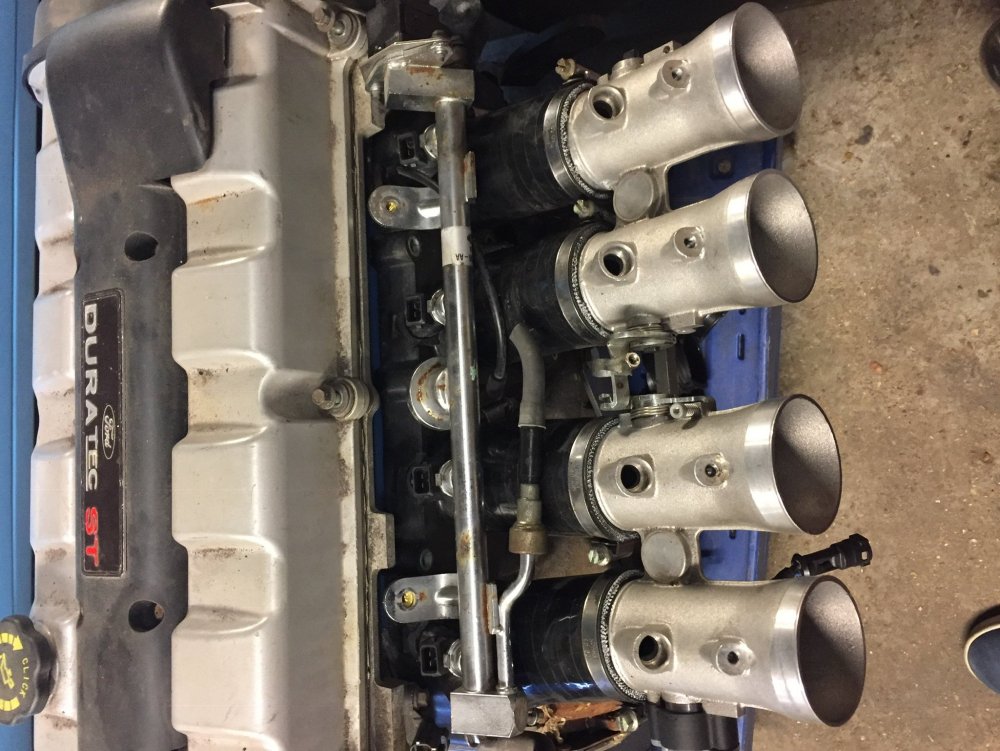

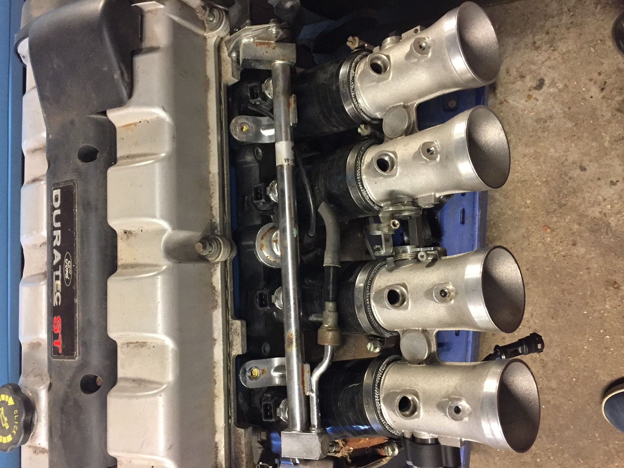

Hi Bavant.
I bought st lump complete for 195. Sent it off. Work req
Hone bores. new rings. Port head. Build back up cost 1300. It's a strong lump the st.
Hope this helps4c137aff62a3b59d48260f27d7106fed.jpg06dc84f6d86c2918a58380d85d6f5d53.jpg
