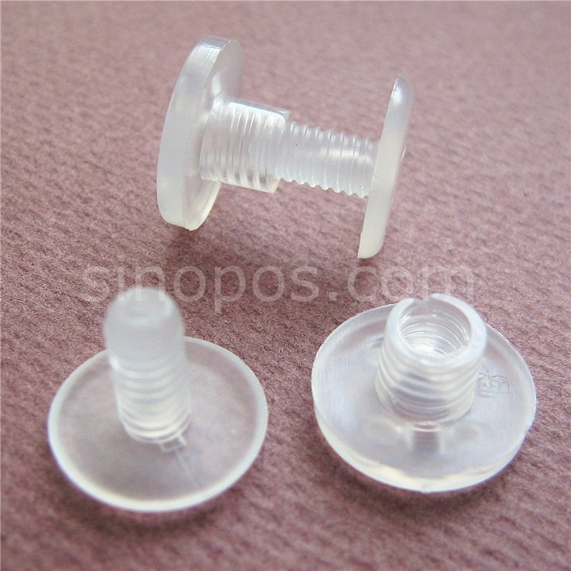

Im trying to find some trim clips to attach a trim panel that insulates the cabin from the boot and sits behind the rear seat.
I was looking for a form of plastic male/female book binding screws preferably in black. I can see pictures of them around but now real sellers I have access too. Thanks

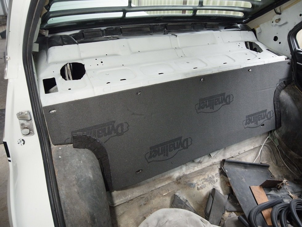

My replacement boot partition. with a black textured vinyl on the boot side to make it look original and Dynaliner on the other side to reduce cabin noise. The cardboard originals dont last all that well so it was time to replace it.
Use the search term "Chicago Screws".
If you can't get any on that, look on e.bay for a UK buyer and I'll get them for you.
  • Thanks 1
Share this post
Link to post
Share on other sites
Thats the sort of tip im looking for as I didnt know what you would call them! I only seen them in small metal form for book binding but I need much bigger. Thanks

Im getting heaps of searching under the Chicago Screw tag but they seem to have no more than 10mm wide heads. I really need a bit bigger than that maybe 15 or 20mm?

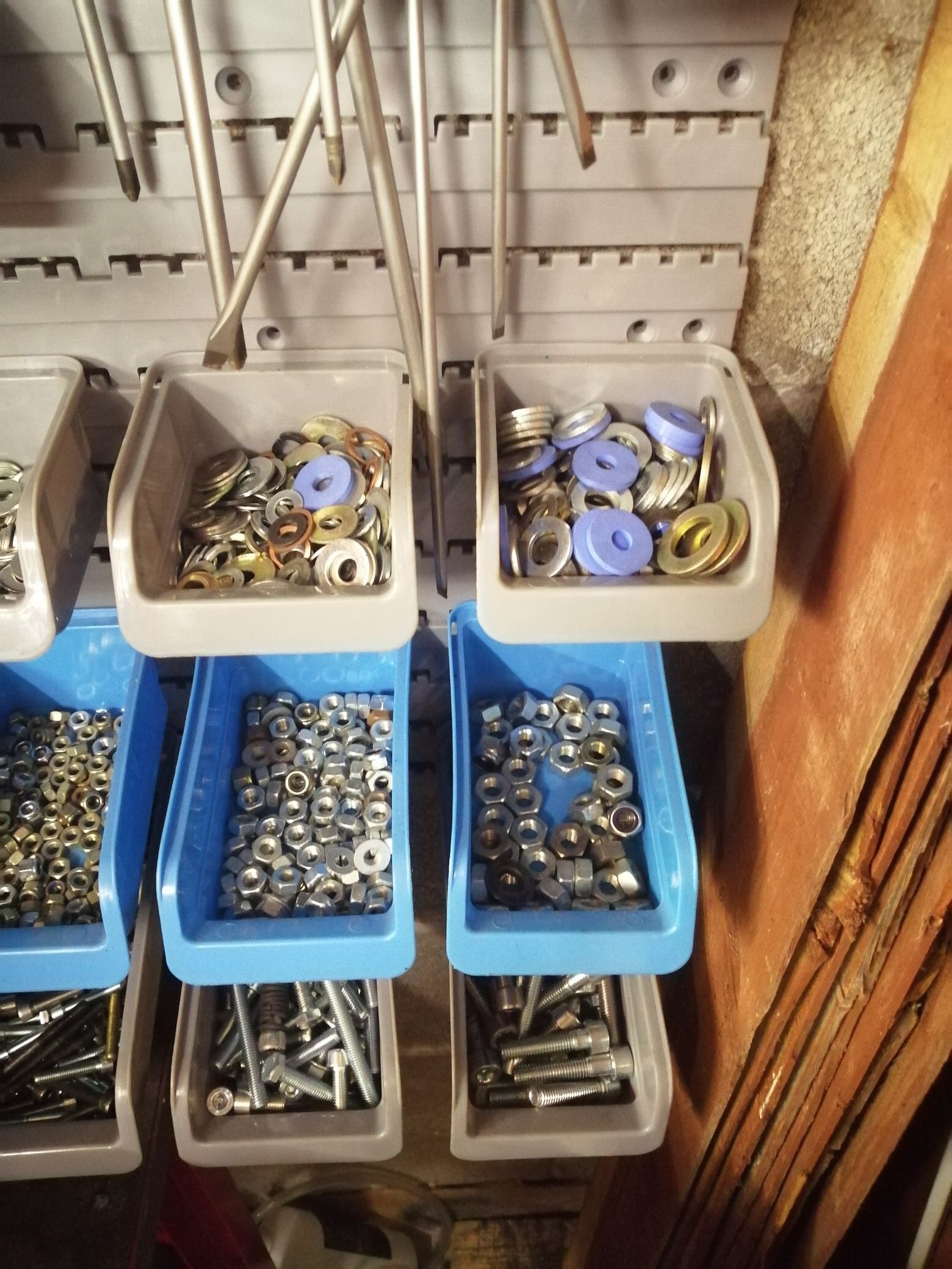

11 hours ago, Rally Pack 2000 said:
Why not use washers under the head?
I have some rubber washers here that look like they might do the job.
Colour is blue, but they'll be out of sight anyway. I also have various large metal ones with a small inside diameter.
That is an option if I cant find any with a wide enough head. My reasoning is that I wanted it to look like flat smooth trim clips not bolts and washers. They would need to be black nylon if I went down that route which is easy enough to find.
The original panel was mounted by tabs on the inner rear bulkhead however one flex upwards to remove the panel and off they broke. One had even broken off on its own over the years. Between them and the cardboard panel itself I dont think Ford ever envisaged them to last as long as they have. With the tabs gone It leaves a reasonable size tear-drop shaped hole hence the need for the wide head. I was just trying to make it look as standard as possible. The shelf panel itself has large headed flat plastic screws that hold it down and that's what gave me the idea to look for plastic ones similarly shaped but slightly smaller in diameter so that it all appeared of the same factory design.

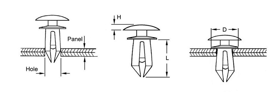

25 minutes ago, Rally Pack 2000 said:
Most seem to be 10mm but thats almost the size of one direction of the teardrop hole, so 15 to 20mm would be great.
This was the type I was thinking about, available in various sizes
49B92EEF-9A9B-463C-98BE-DD778800AF15.jpegKnown as push rivets panel and trim
Share this post
Link to post

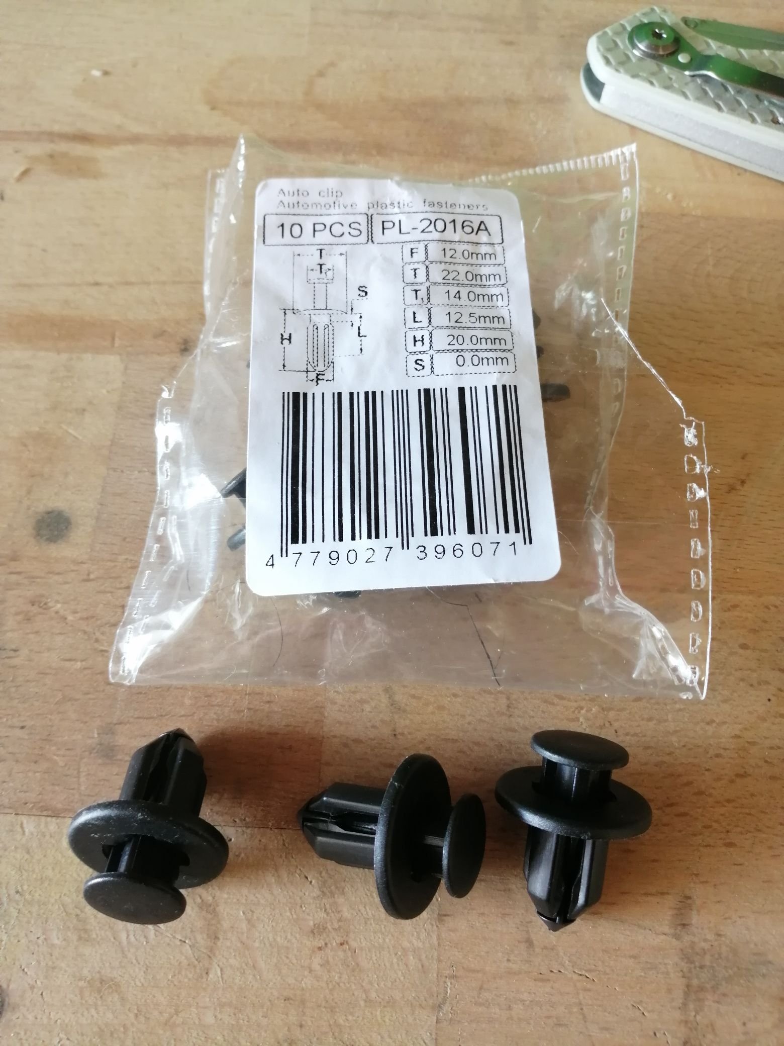

I have a bag of those here, Col. They're good and very strong. Totally forgot about them and just found them in a tray in my bench draw.
James, these have 22mm heads and a 12mm rivet spread.
Got them on eBay, but I can post these if you want them.
Do they spread open when you tap the head down?
Share this post
Link to post
Yes, it's basically a re-usable plastic Rivet. You can push the head down with your thumb.
Share this post
Link to post
That's interesting. If I pushed it in from the boot side you wouldn't see the expanded prongs of the clip and on the visible side you would have a neat head. I would just have to be sure that the rear seat doesn't butt up at that point. It would need to go into an open part of the seat. What are the dimensions of those things?

I was mainly just curious about the variations. I saw a pic once that didnt have any supports at all. The new panel has already been made with textured vinyl on one side and dylaliner sound proofing on the other and the fibre seals around the wheel arches from the original have been removed from it and replaced on the new one. So its all set to go with holes matching the original. There are matching holes where the original clips once were so no need to permanently bond it in when factory looking clips should do the job..
