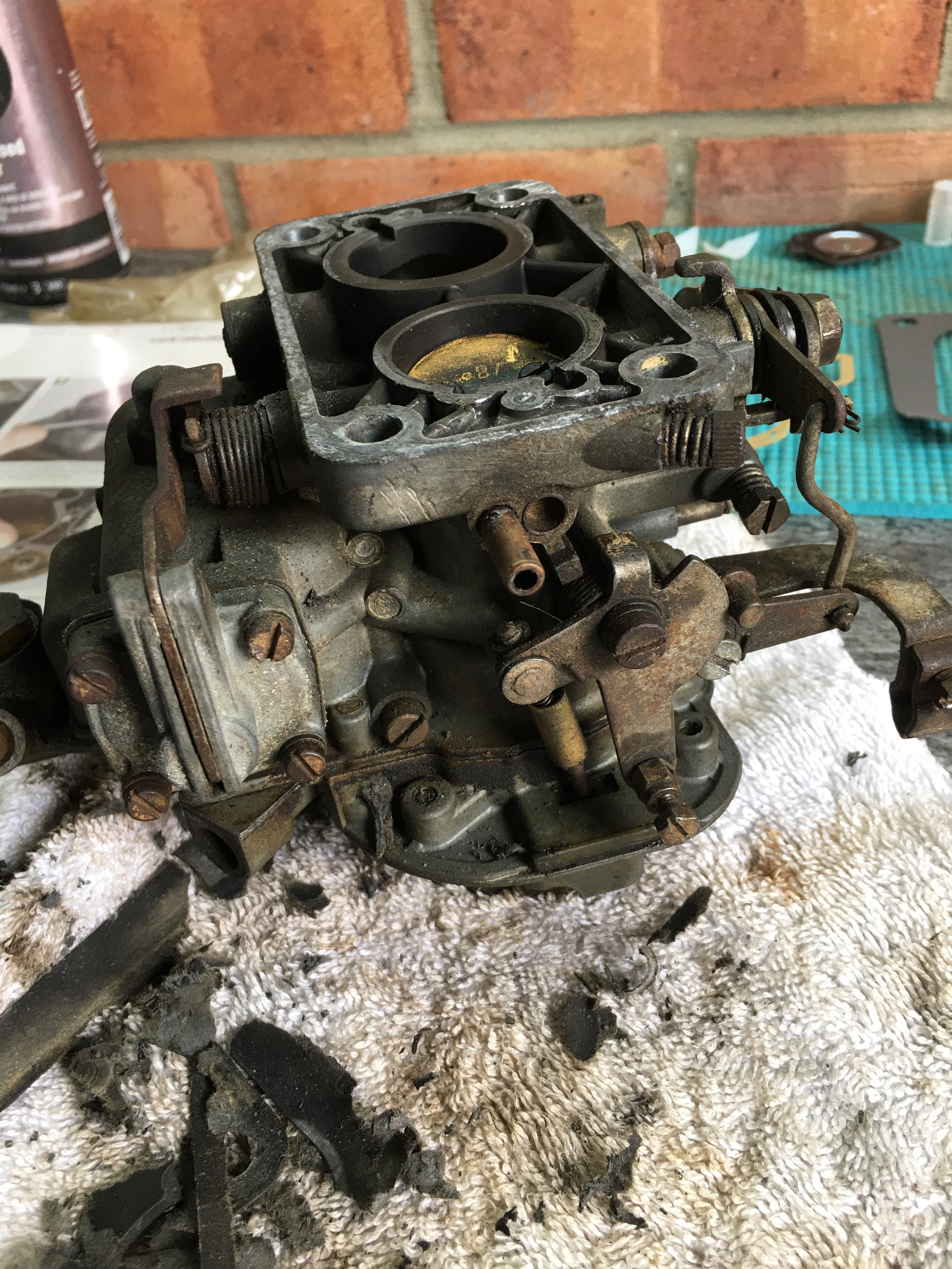

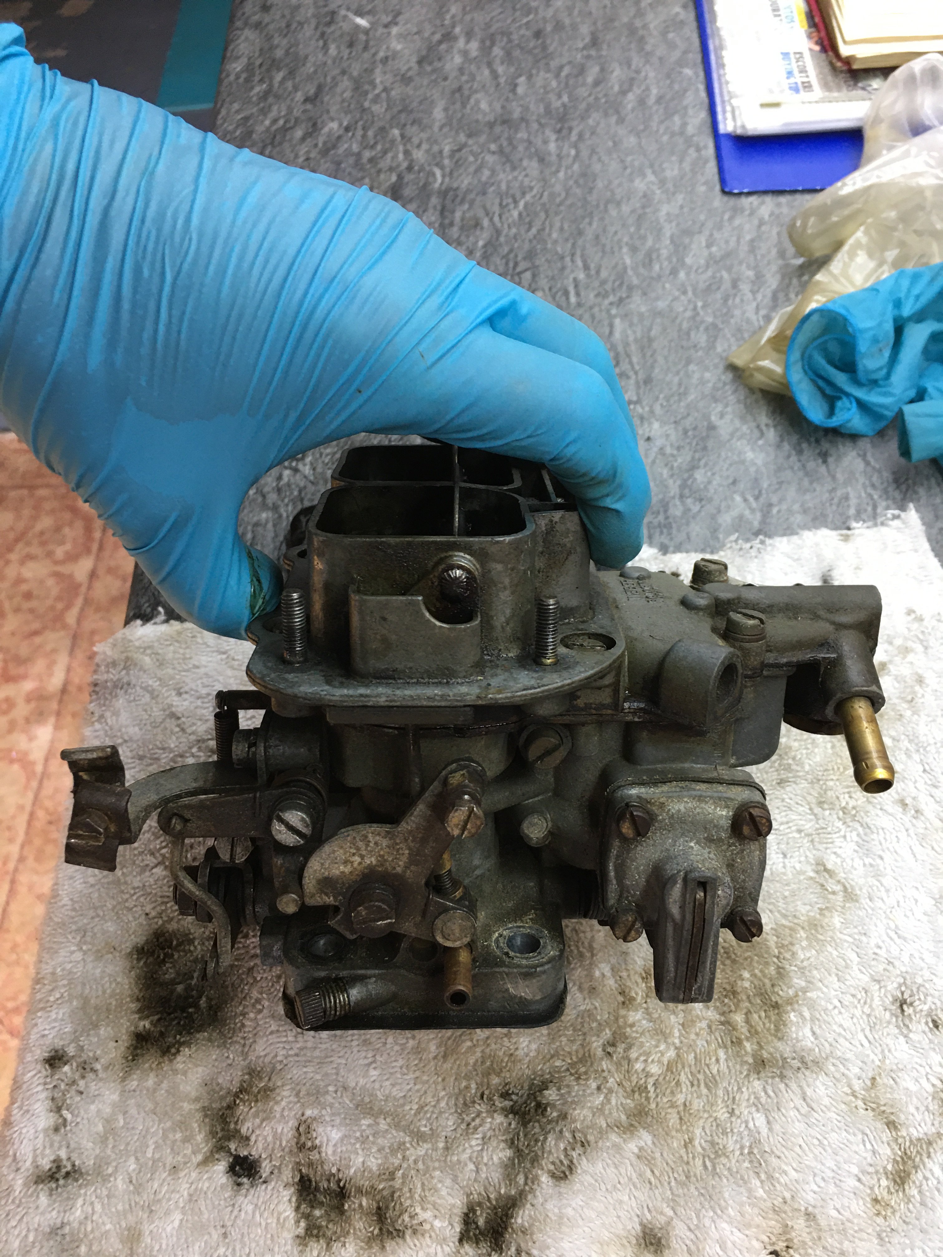

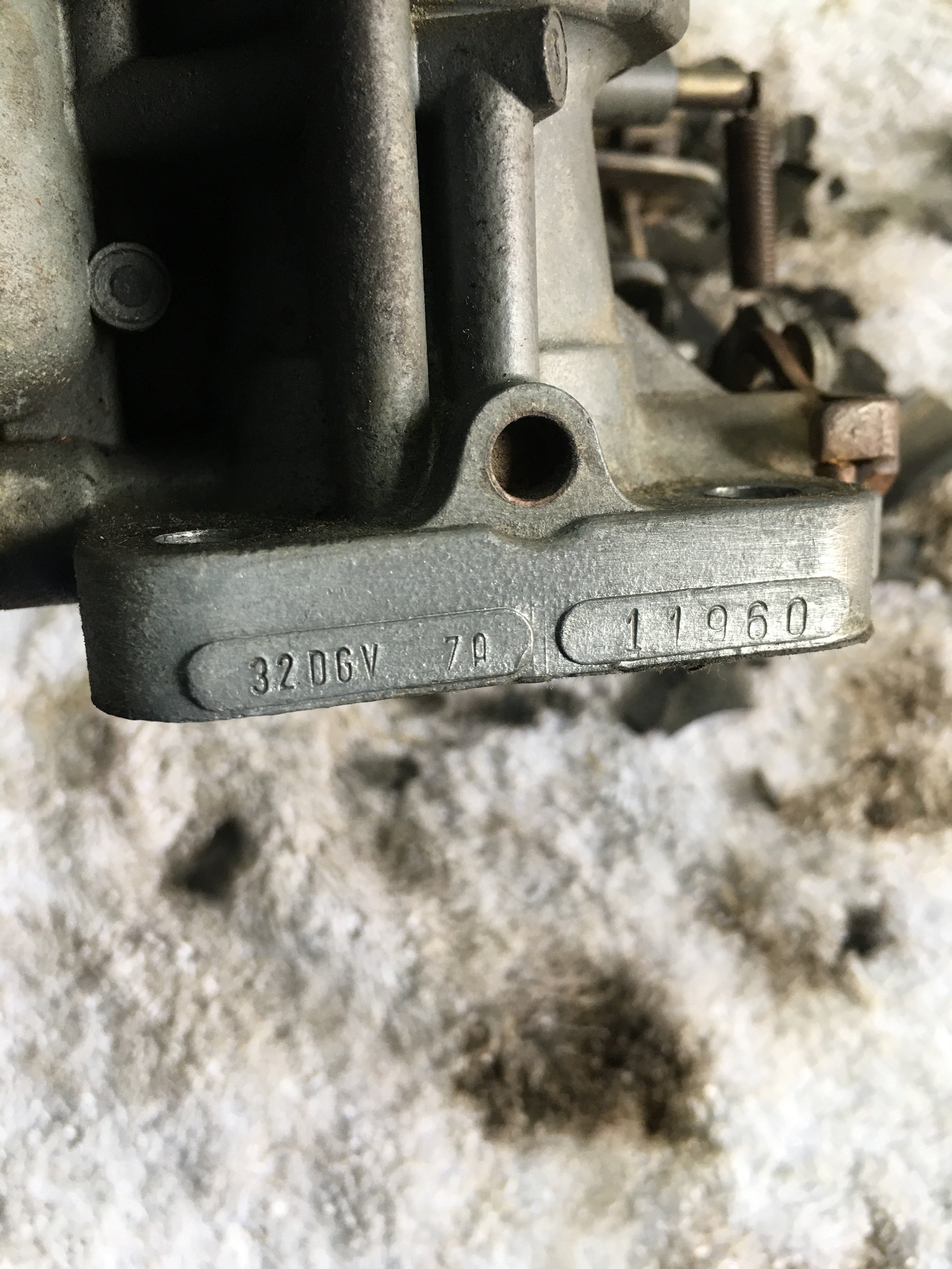

Hello this morning I’ve taken off my Weber 32 DGV 7A for a clean up & fit service kit never taken one off b4 or cleaned it & carb looks ‘orrible!!

Cellulose thinners cleans carbs up well, don't get it on rubber/plastic bits, blow the jets out, and the carb body orifices with compressed air, fit the service kit.

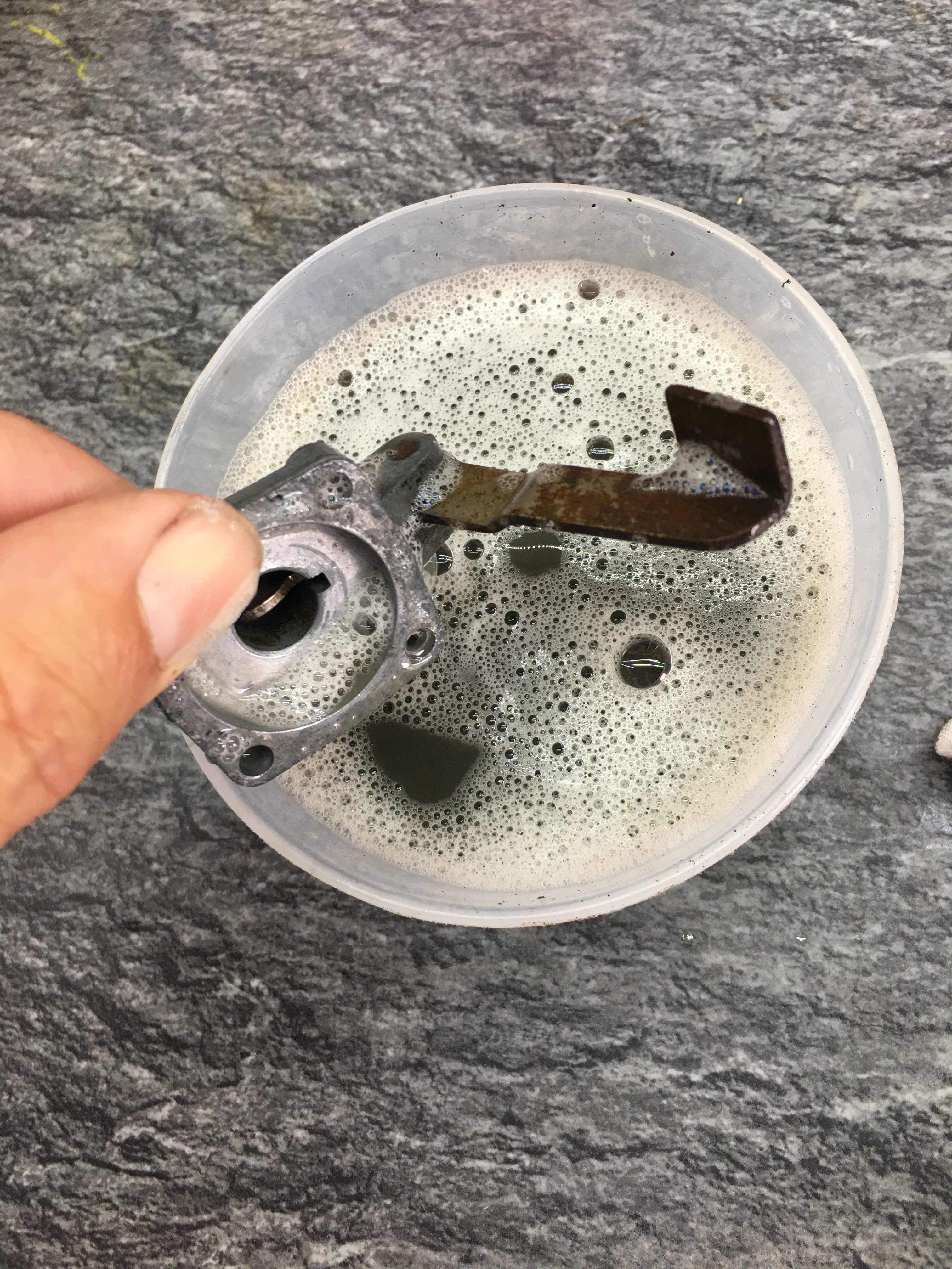

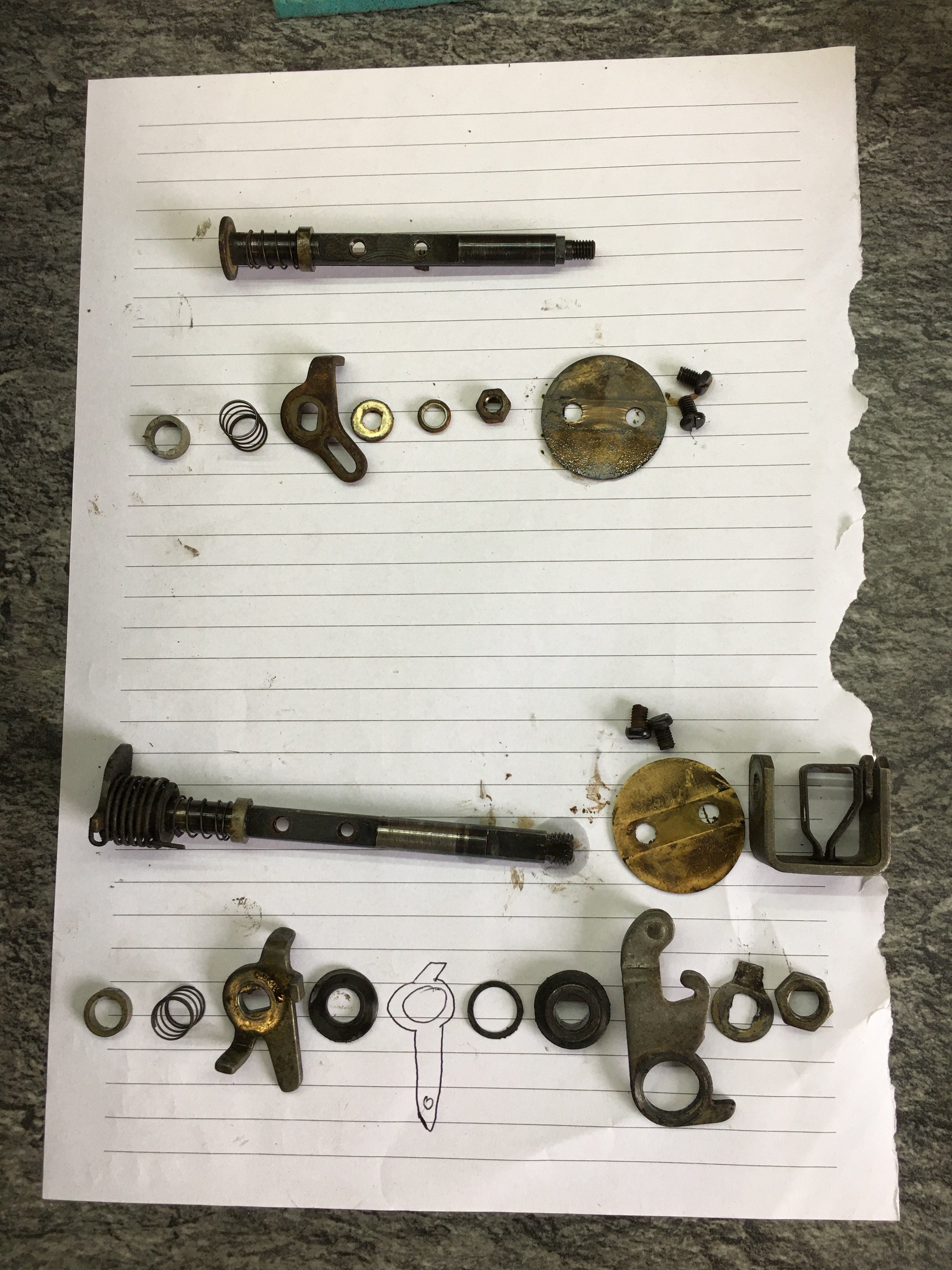

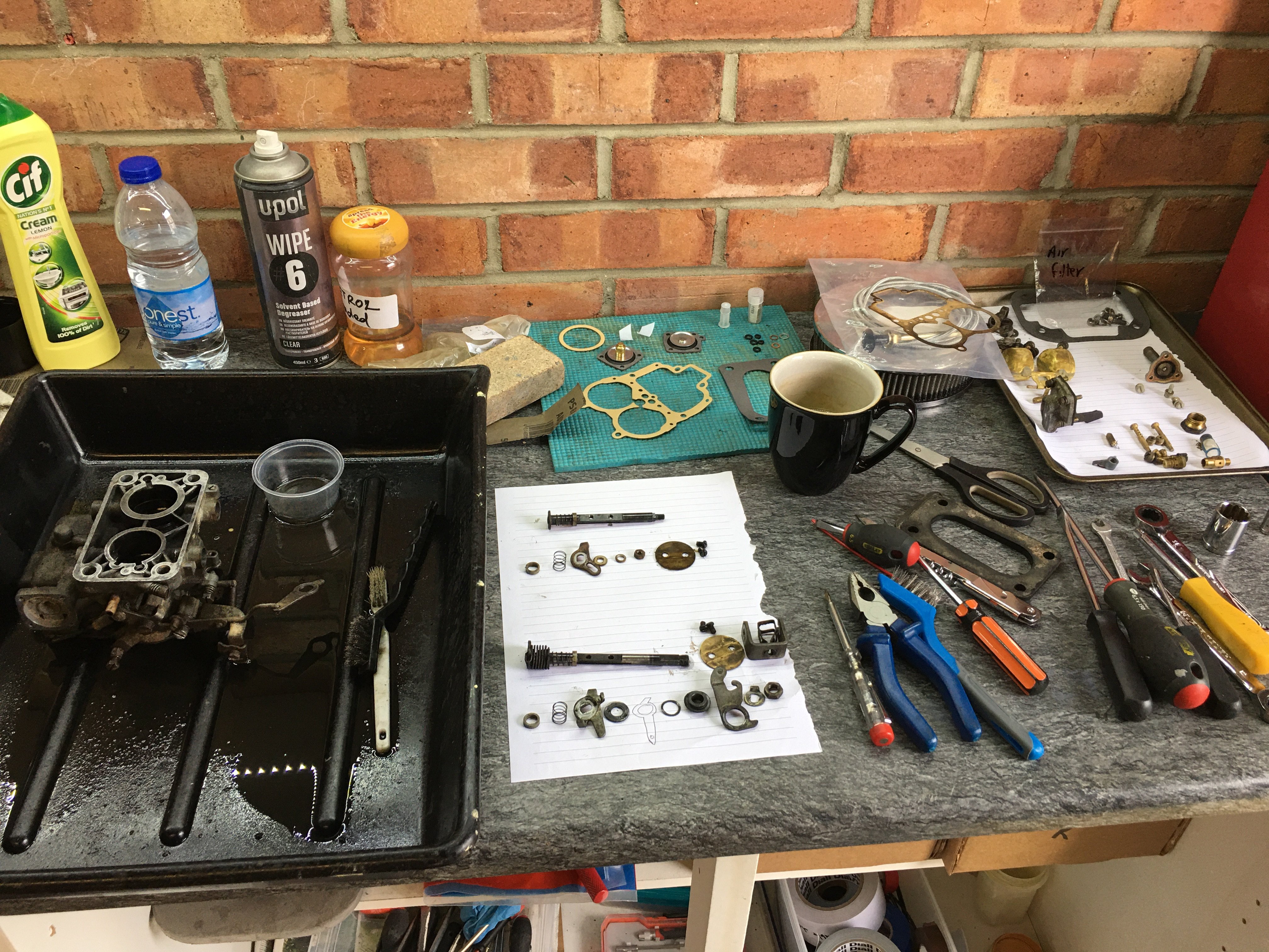

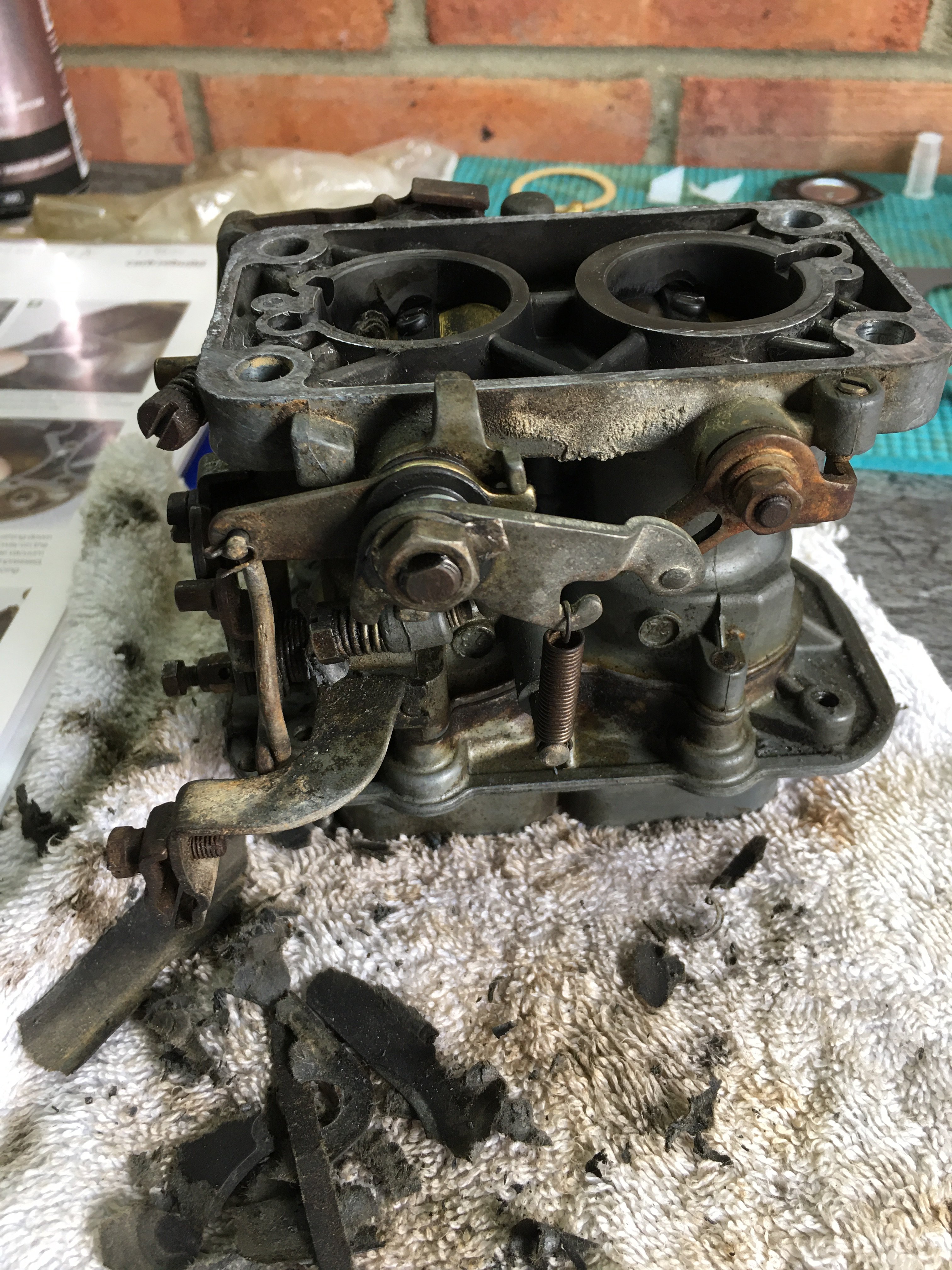

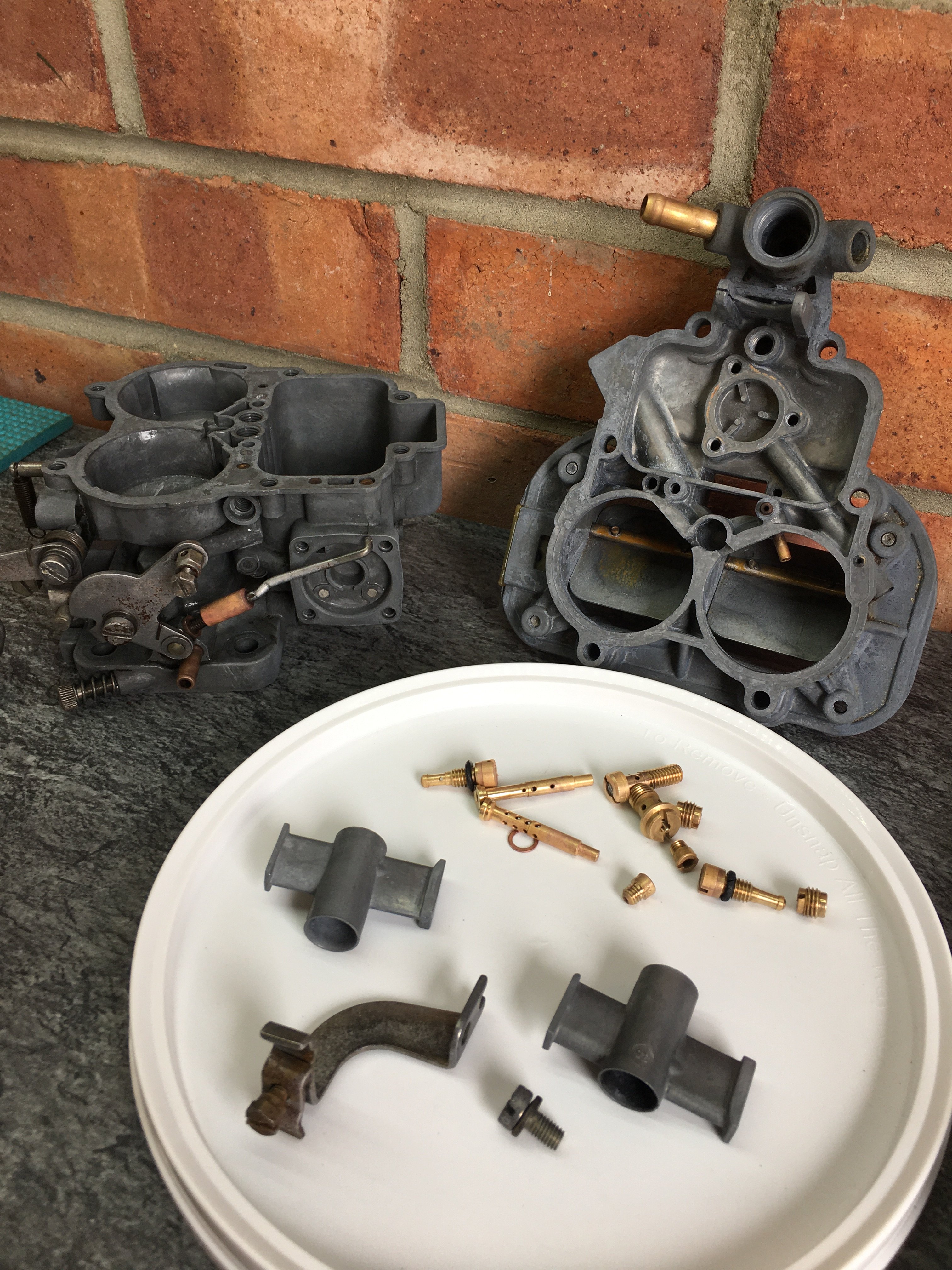

Some pics of 32DGV refurb progress 👍 now thinking I need some sort of Air Compressor / media blast cabinet etc & to research ultrasonic  to become self sufficient???

Believe me, i've seen an awful lot worst. But agree, without air assistance the process will be 'harder'
Old Skool ghetto air source for such a job was - don't larf! - a truck inner tube with about 50-60psi in it, its enough when used through a narrow airline and nozzle - takes some work with a bicycle pump though LOL!
  • Haha 1
Share this post
Link to post
Share on other sites
It doesn't have to be clinically clean outside or inside, it just needs a clear filter, all the orifices clear, and no lumps of crud inside.
aerosol carb cleaner, is a good alterative to compressed air.

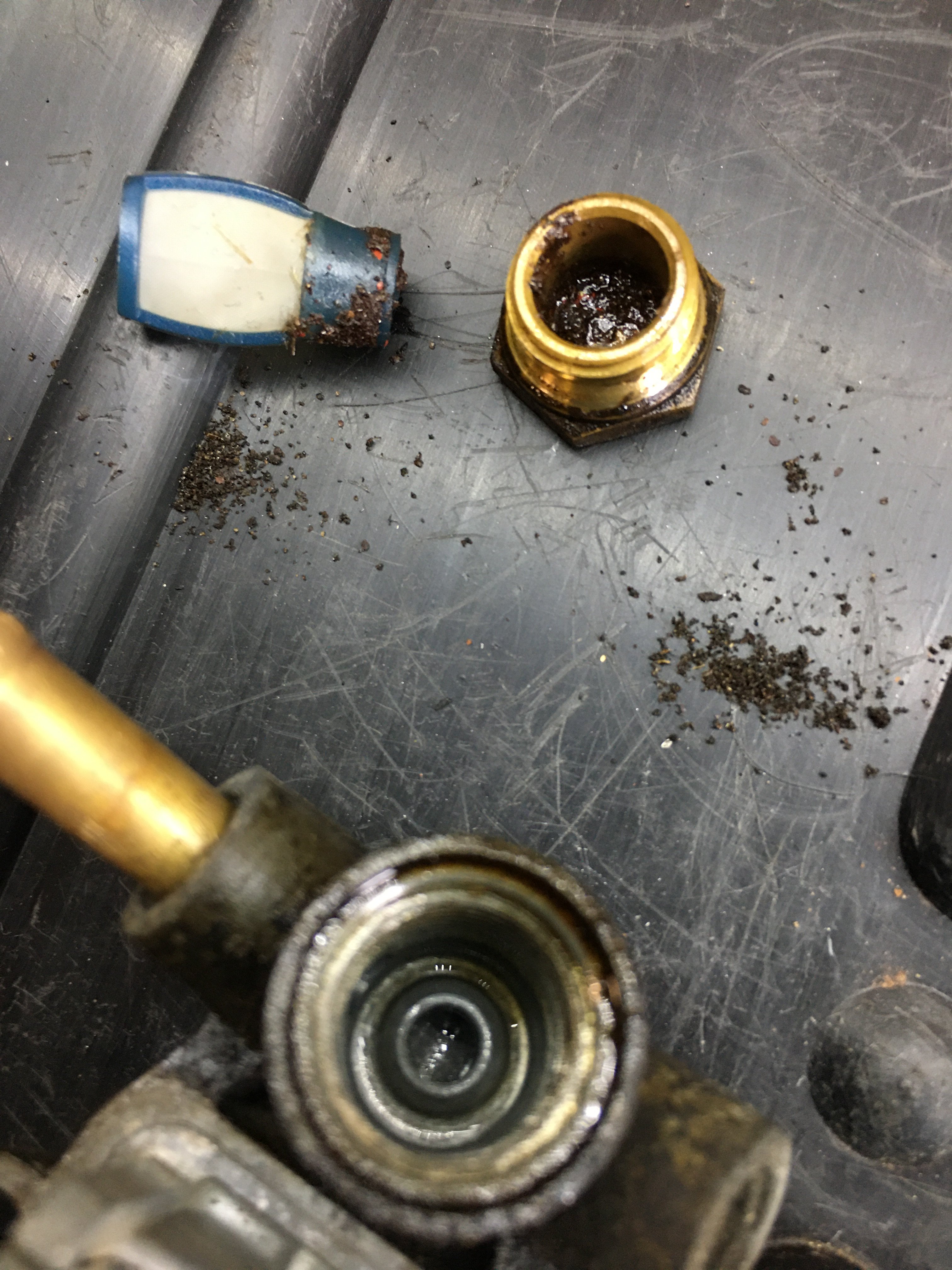

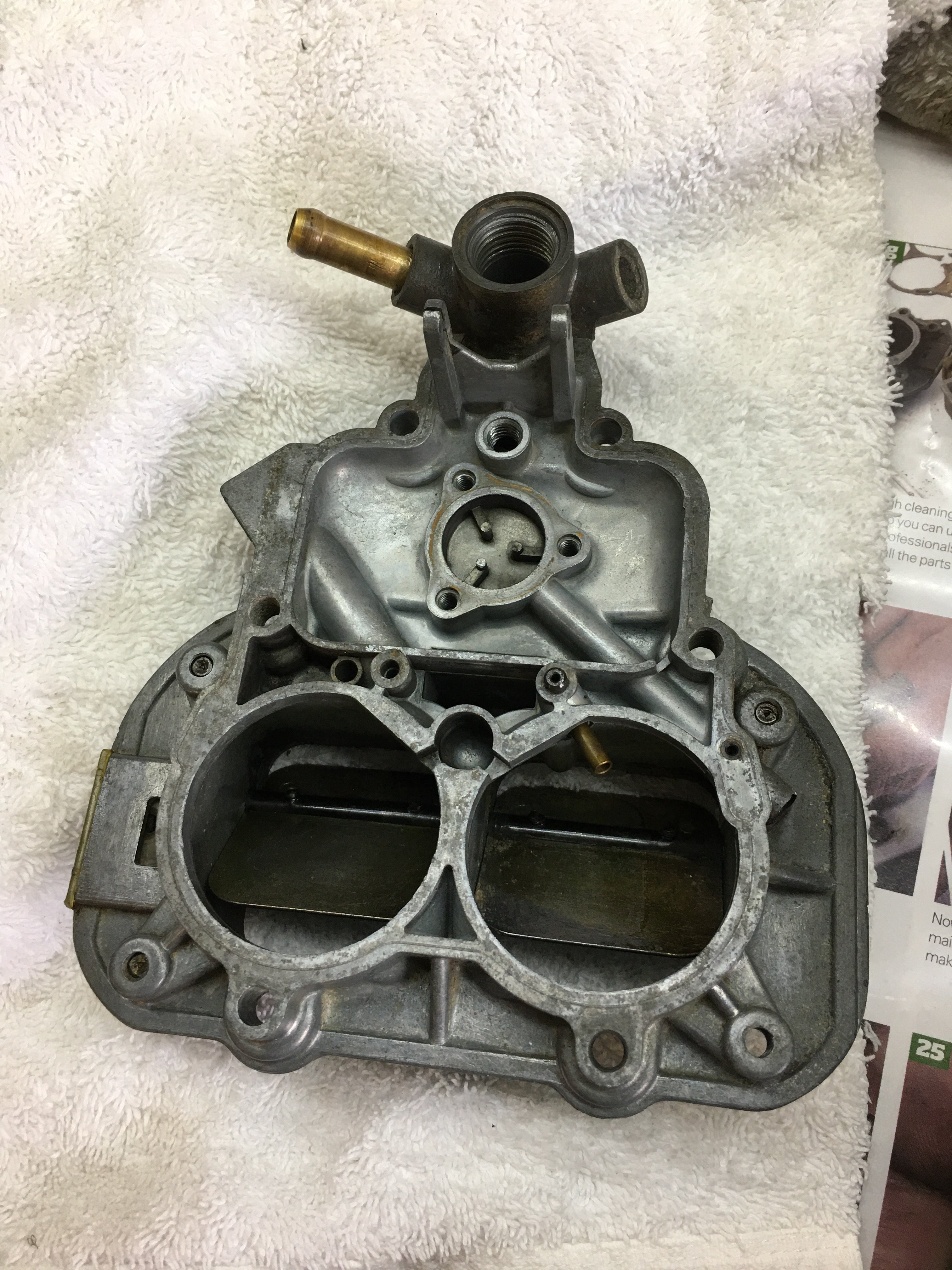

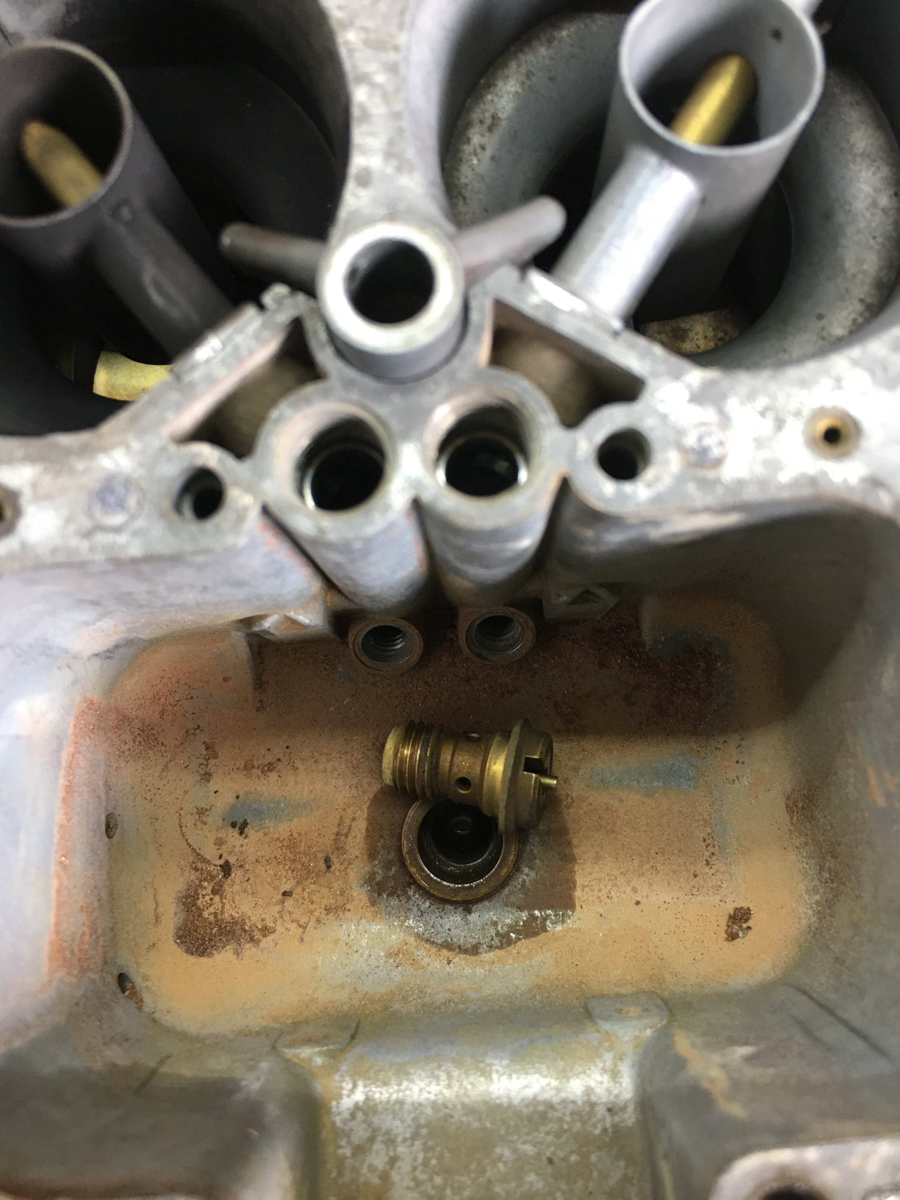

Nice one think I’ve been trying to sterilise it! Carb is clean now but the service kit contains an all brass needle valve whereas the one I’ve taken out of the carb has a rubber Viton tip - should I replace it?
Share this post
Link to post
That looks very clean.
I would keep the viton one , or replace with viton , they are a bit more forgiving that the brass ones.

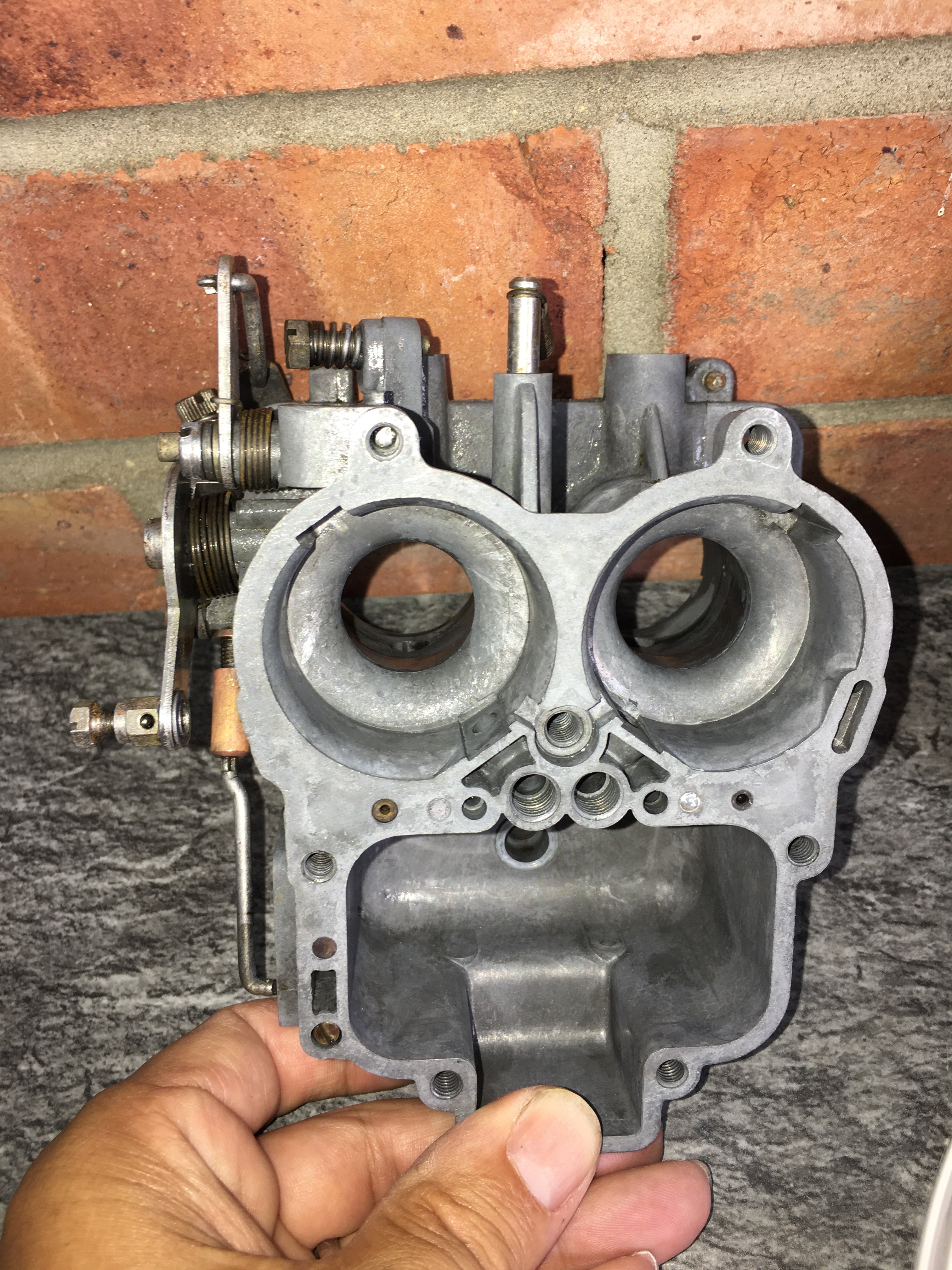

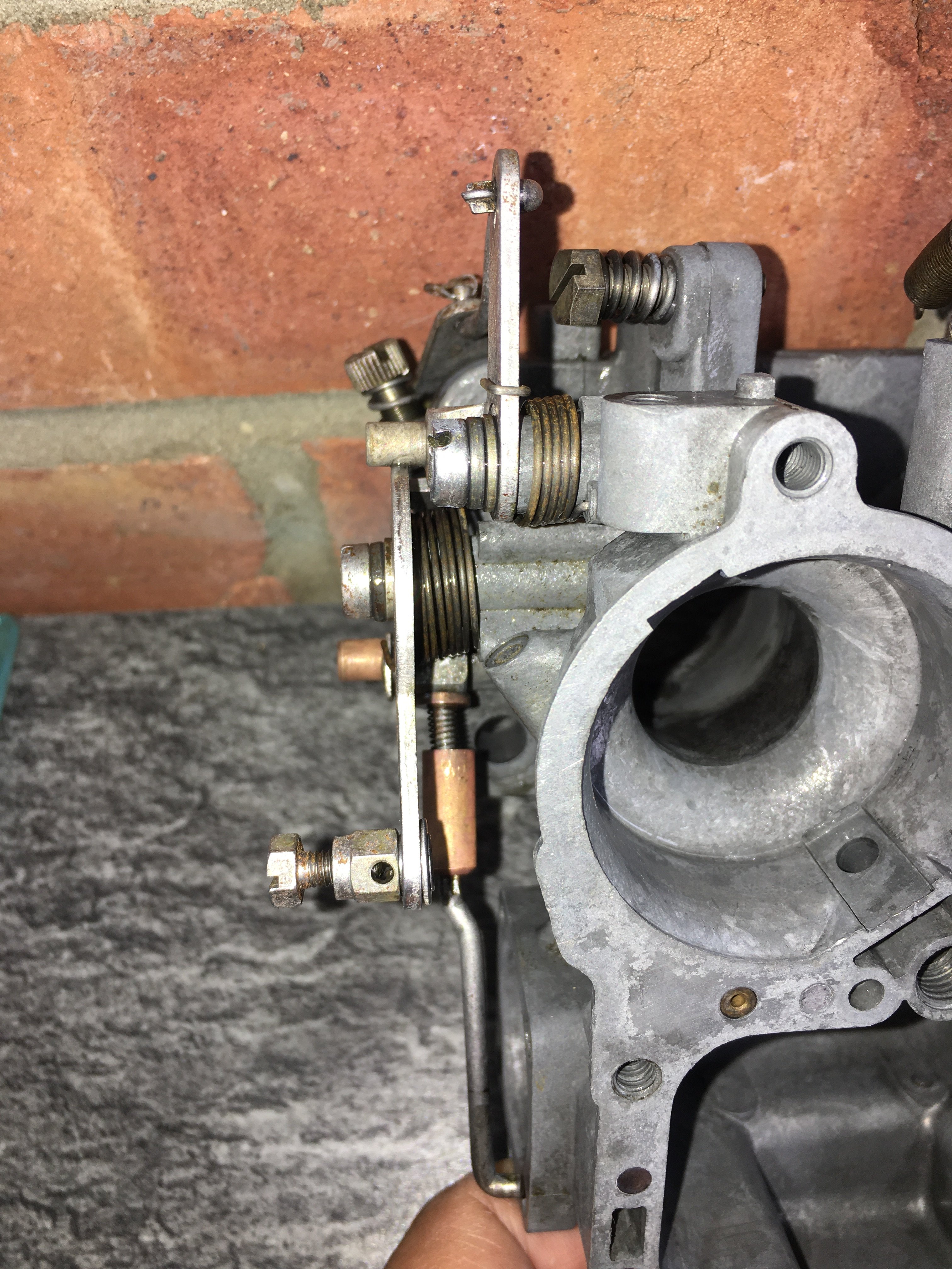

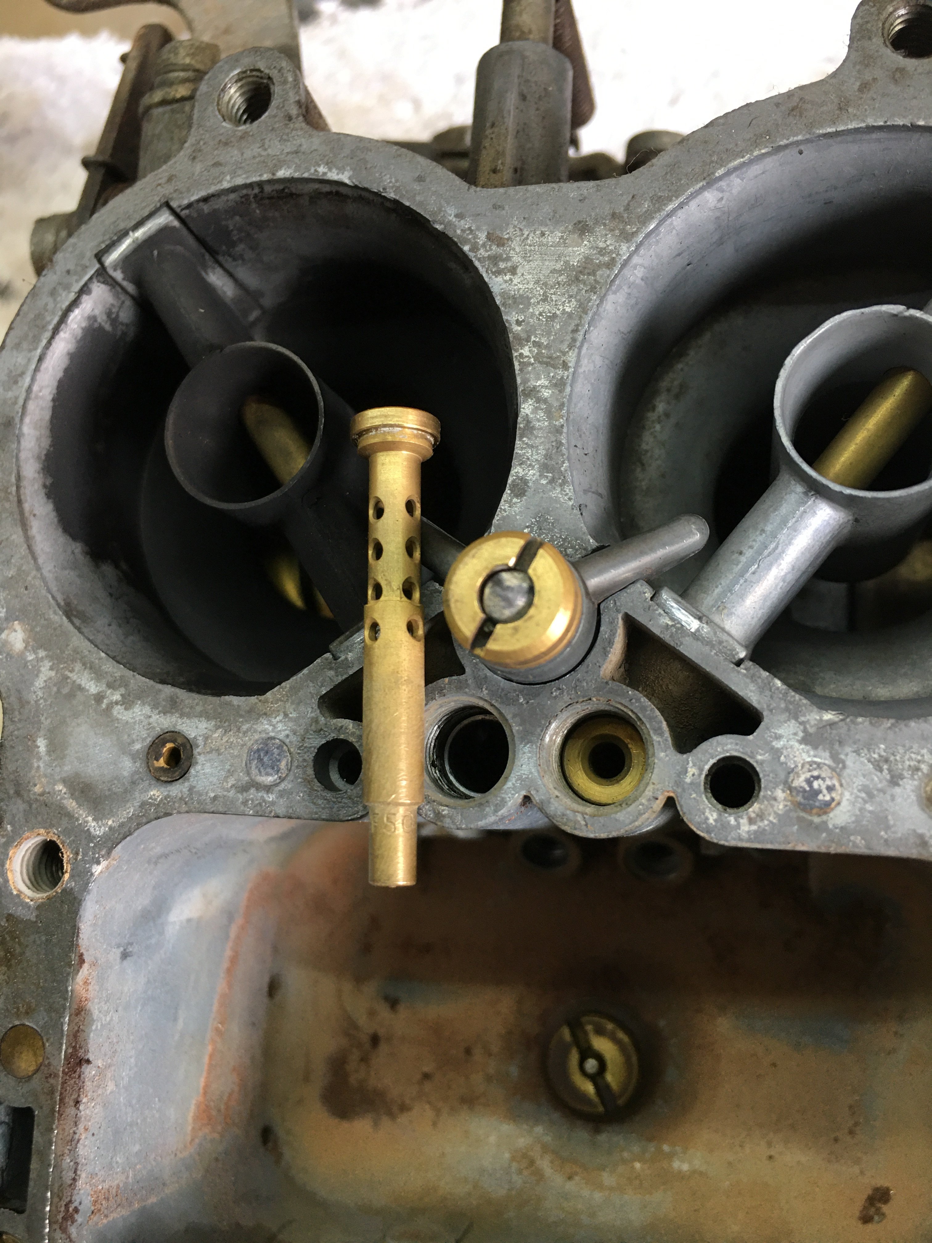

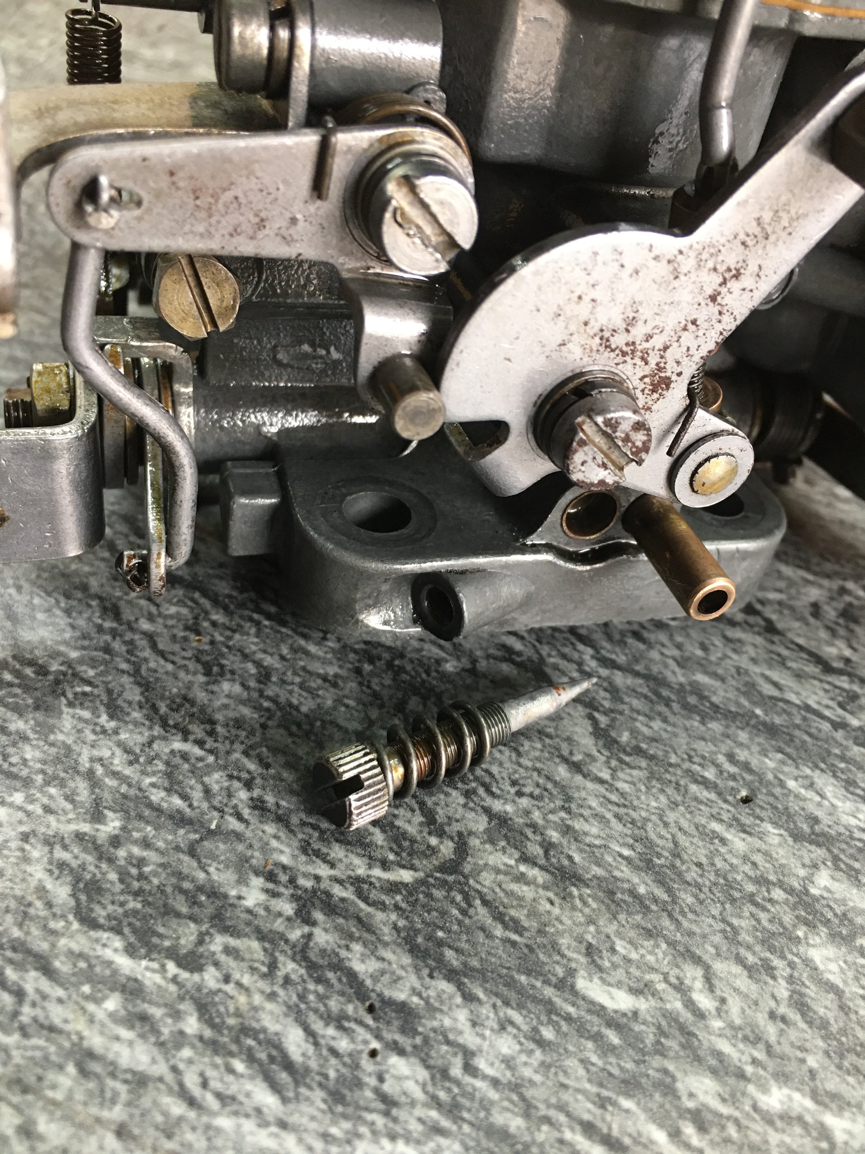

Ok - Carb re-built got a couple of questions. Can someone please confirm this is the Mix screw? (Pic 2) Any advice b4 actually trying it? Thanks
Share this post
Link to post
Yes that's the mix screw, set it at 1 1/2 turns out from right in, as a base setting.👍

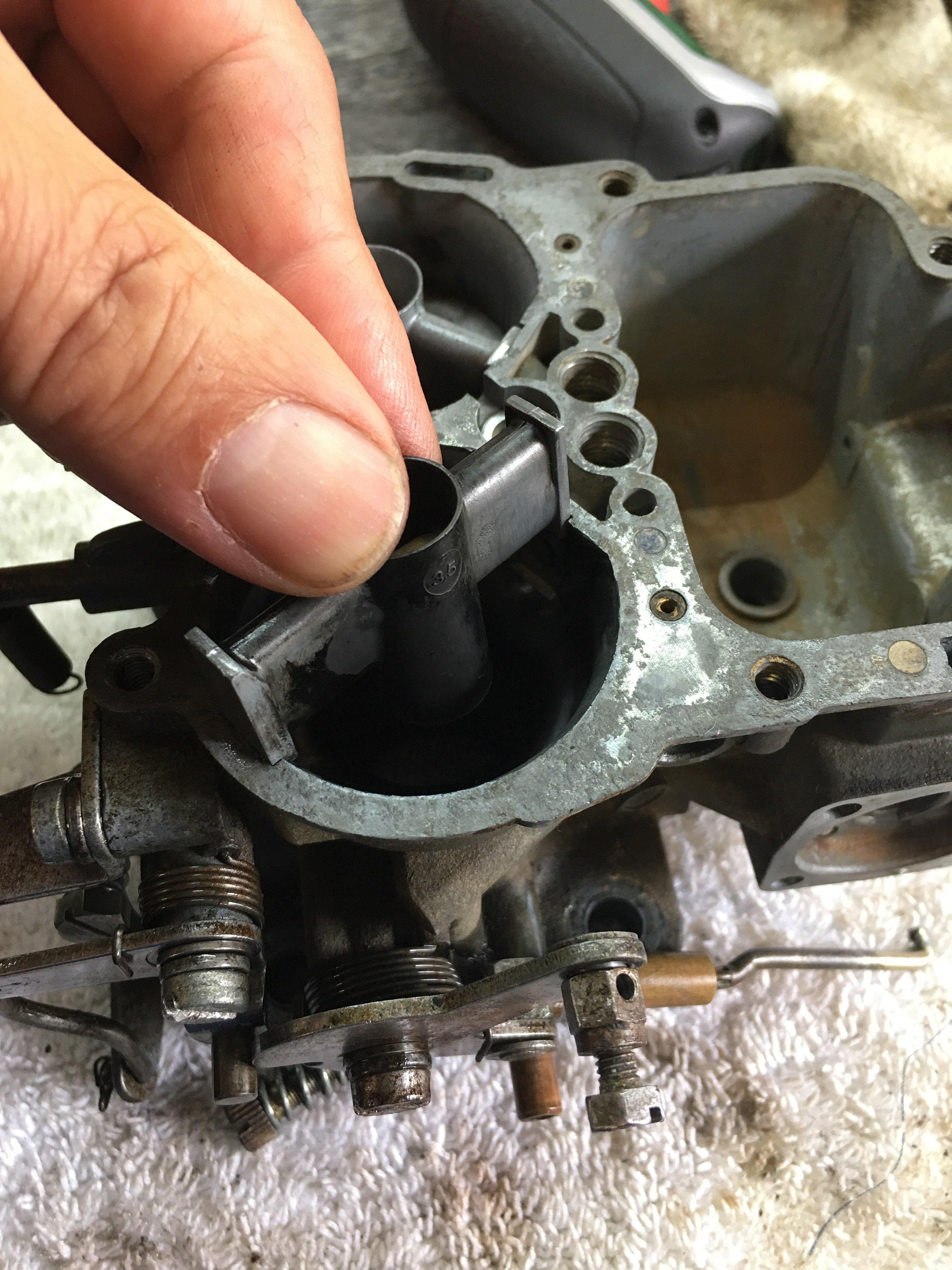

Help please.....Carb refitted & car started! Sounds fab BUT on starting the engine revs go straight to 3000RPM and won’t come down!!
Share this post
Link to post
Check for air leaks, and check if you put the Venturi flaps back correctly, and check the tick over screw.
Most likely to be Venturi flaps not fitted correctly , and a bit open , or the favourite is air leaks.
Share this post
Link to post

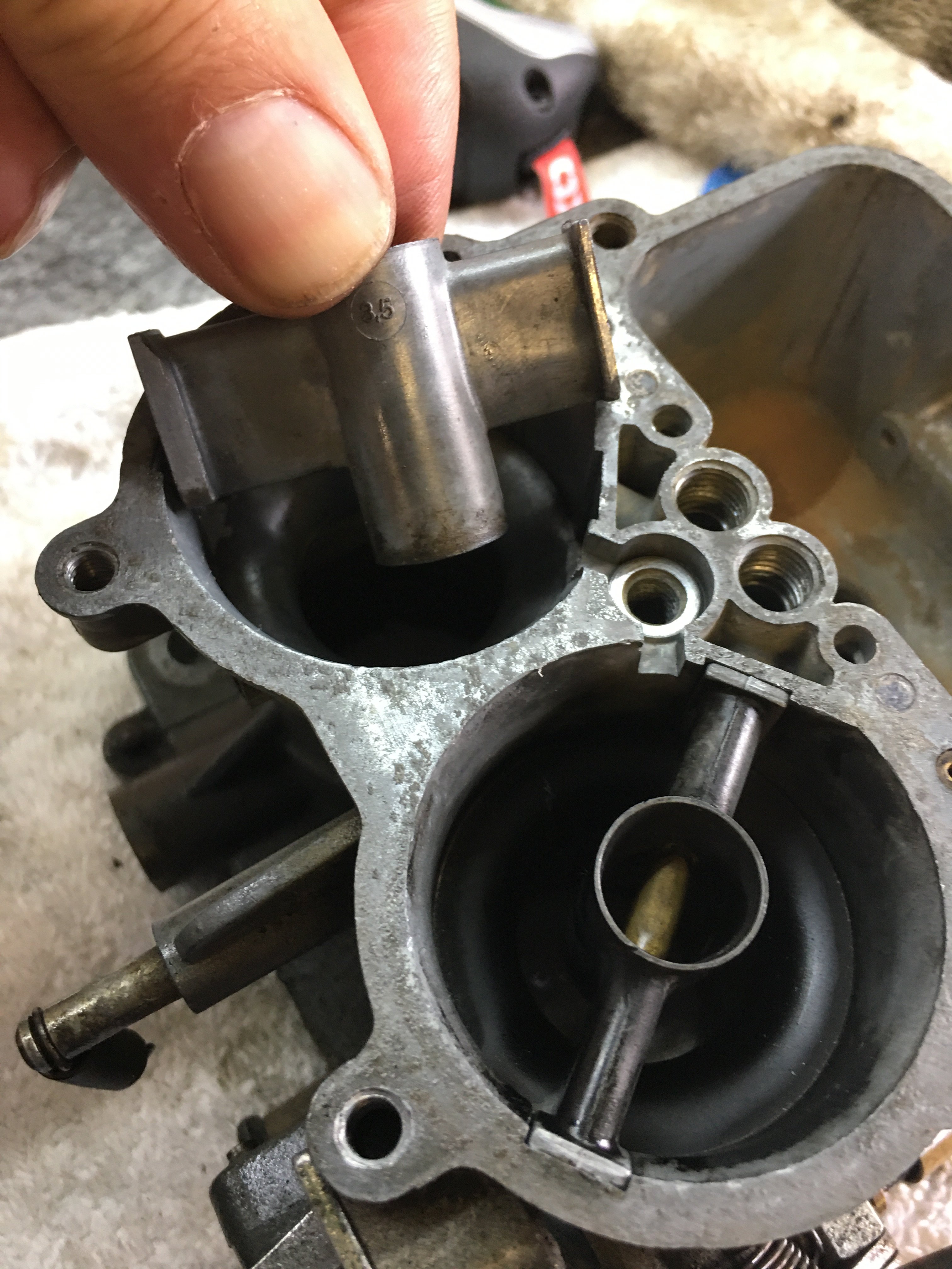

Just put the torch down the chambers & the Venturi flaps are at a slight angle and open by a couple of Mill they are not flush 🤔
Share this post
Link to post
If the throttle stop screw is wound right off, both flaps should be closed .
There is probably a setting for them, but I don't know what it is.
Certainly the 2nd choke flap won't open untill the 1st one is 3/4 open.
So I guess it's the second choke flap being slightly open that's your problem.
  • Thanks 1

Thanks Johnny Boy you were spot on! Just taken the carb off & taken both Venturi flaps out & re-fitted them this time more precisely and more central. Car started & revved normally. Proper looking forward to a toad test tomorrow - Thanks again Huge

Glad I could be of help.
Make sure the screws that hold them can't come out.

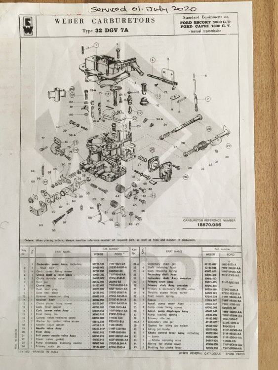

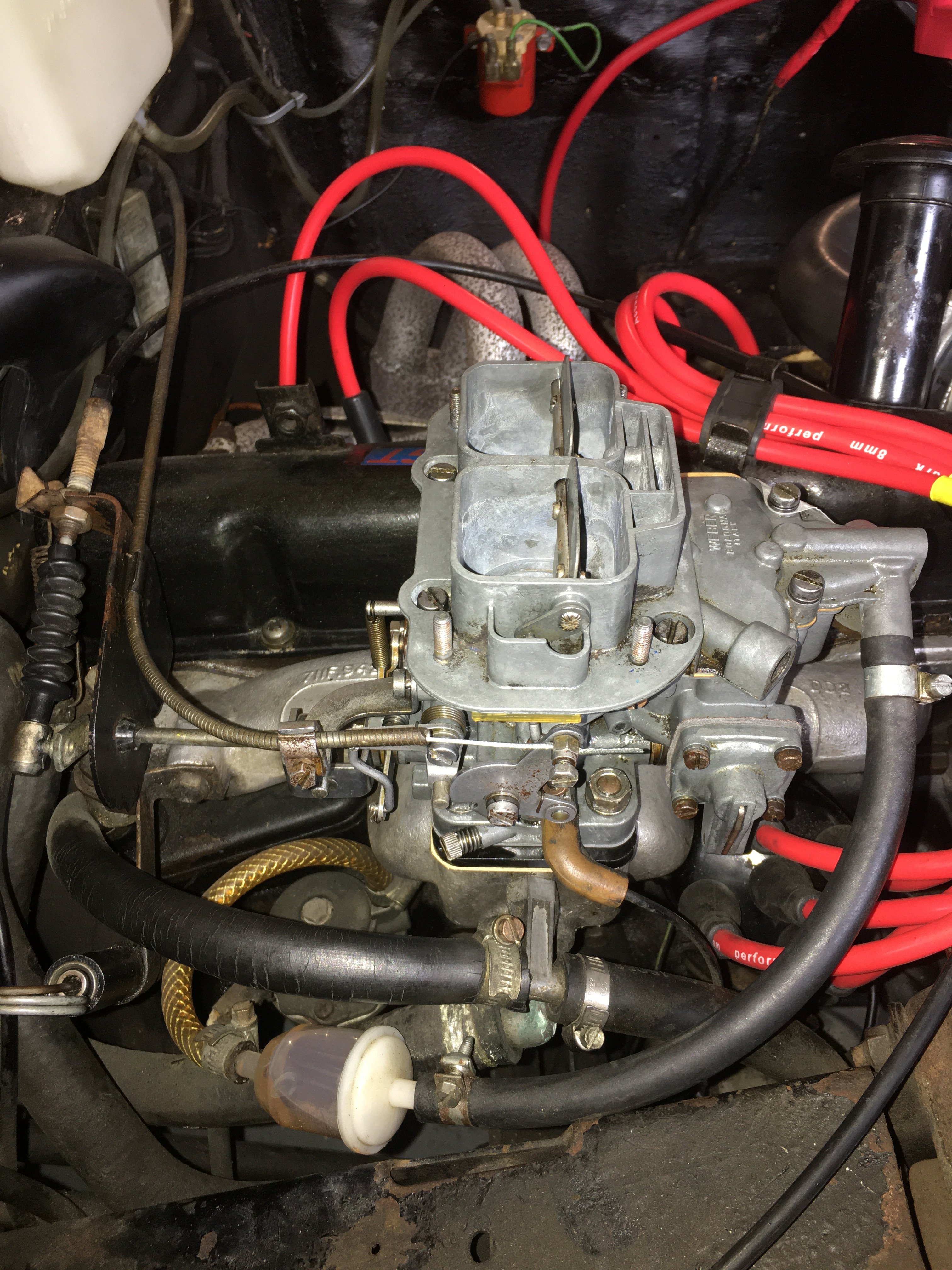

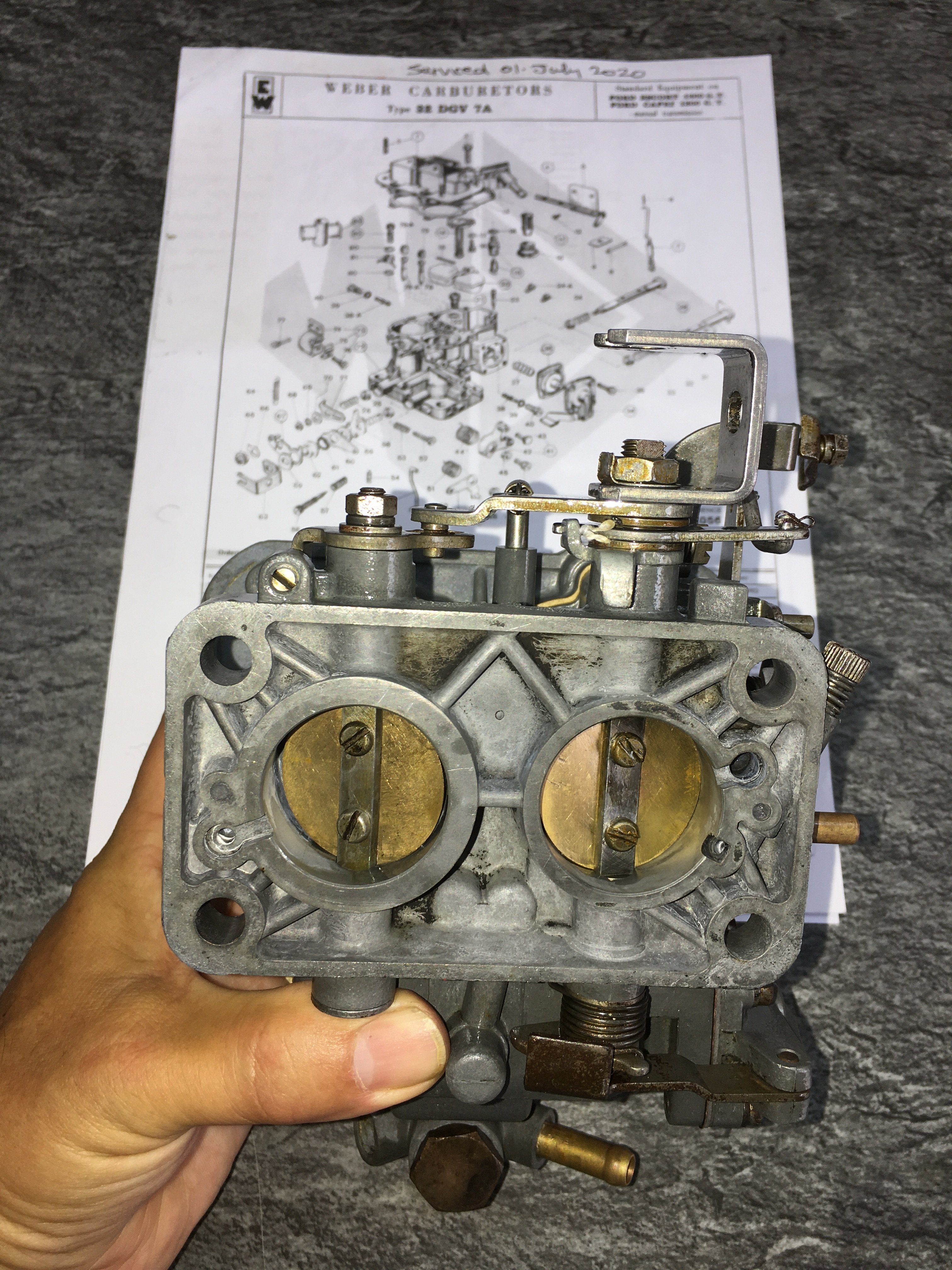

A couple o road tests & carb tuning sessions completed & the car has never accelerated as quick! Not 100% smooth running yet but that’s WIP. Thanks to all for help here’s the finished Carb + schematic. Huge

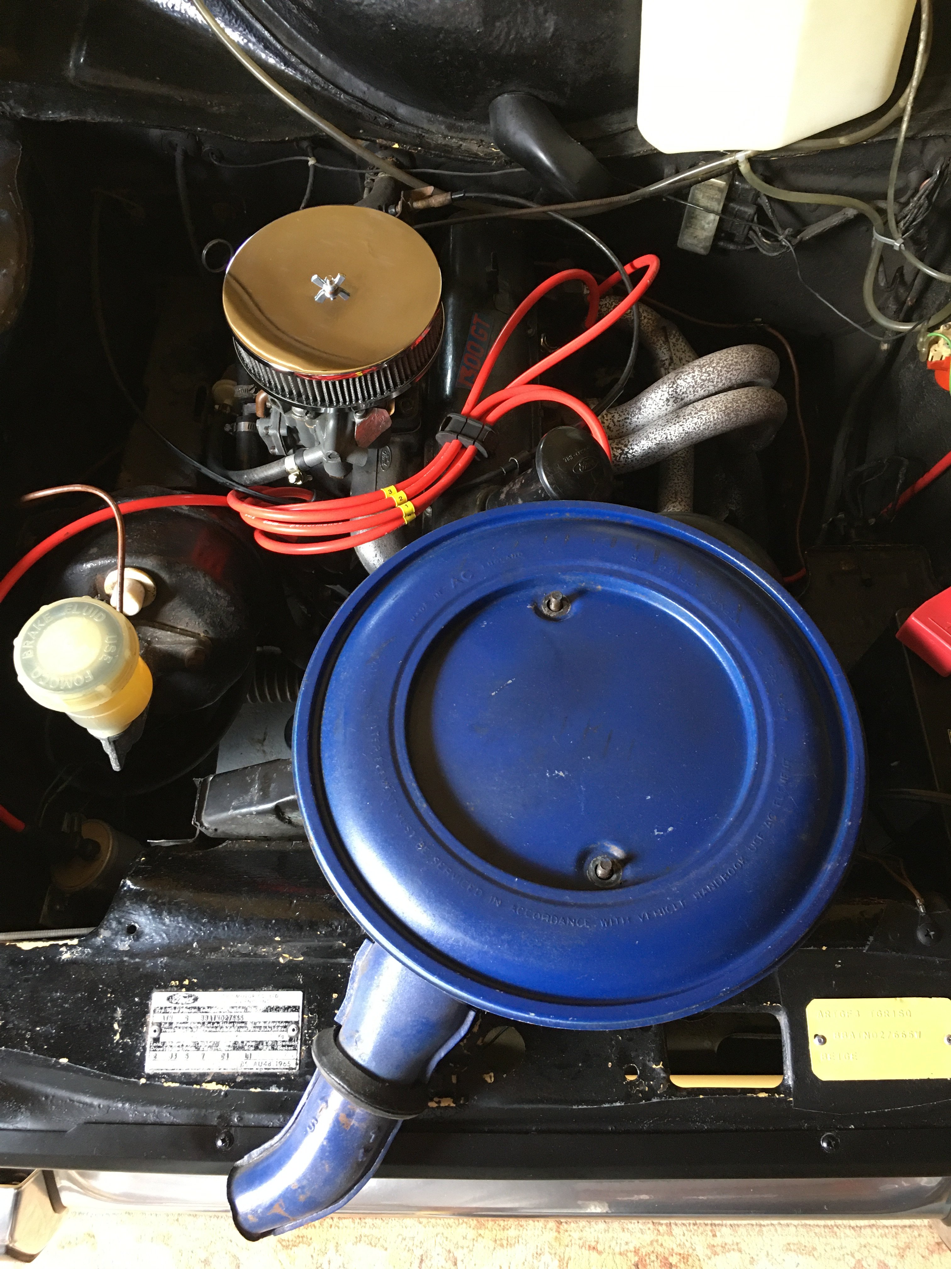

Advice please Re carburettor- since servicing it the performance has been really good ...but my mixture screw is fully in, would changing back to original air filter work?
