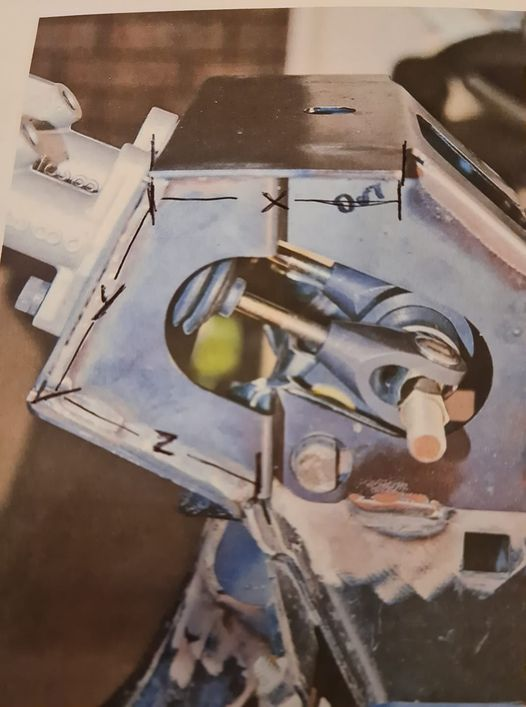

Nibor1 0 Posted Wednesday at 11:24 Report Share Posted Wednesday at 11:24 Hello first apologies to admin I did post else where on forum before seeing that we are ment to put first post one this page. I am based in Hailsham East Sussex and working on a 100E What I'm trying to find is X. Y. Z.. measurements so that I can convert and escort pedal box to a bias type box I know that I can bye one ready done as someone suggsted but where's the fun in that when you have a workshop full to tools and a spare pedal box. So if any body could take a coulpe of measurements I would be Gratefull. Cheers Nibor 1 Link to post Share on other sites

notenoughtime 614 Posted Thursday at 19:32 Report Share Posted Thursday at 19:32 Hi and welcome Nibor I suggested buying one as you didn’t explain what you was doing? Could you not convert the original 100e pedal box as that will mount in the correct position? Link to post Share on other sites
Nibor1 0 Posted Saturday at 10:51 Author Report Share Posted Saturday at 10:51 Hi I've have had a look at my 100E one and started some conversion work on it but at the moment it looks like i'll end up with the cylinders pointing at my legs ( not good ) and has i've a escort pedal one spare I thought I'd see if I can get measurements to convert it I dont necessarily need it to be bias system just need to bring cylinders in to car ( need the room under bonnet ) Cheers Link to post Share on other sites
