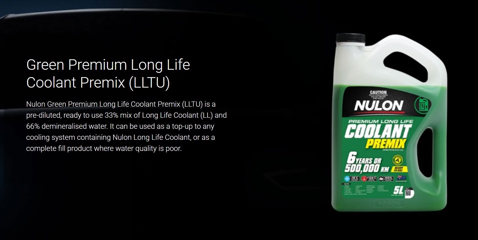

Our local offerings are of course different from yours but we do get differing qualities. The better ones are premium pre-mixed with de-mineralised water and some state they are "long life". I have had cheaper ones that crystallised inside the engine after I left it standing for a couple of months and I had to take the inlet manifold off, change the water pump and thermostat and housing and stick a pressure hose directly into the block to wash it out as well as the expected radiator removal and reverse flush. The crap went everywhere and all the grass died around the driveway where I did it! While I have heard it said that they are all much of a muchness I totally disagree. Look for known brands you have heard off, and the "Premium", "Long Life" and "De-Mineralised Premix" tags.
