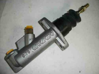

im debating which master cylinder to use on my mk2 escort , il be running a 1660 crossflow with twin 40 webers so there wont be room for a servo , so which master cylinder would be best  and size, il be running std pedal box , front discs and rear drums, front calipers are willwood four pots  any thoughts ,replys much appreciated
I am running a single 0.75 wilwood master cylinder retaining the standard pedal box with princess four pots and 9 inch drums after removing the servo.
I adapted a remote reservoir by cutting off the flared end of the thread and used a copper washer to seal it.
Alternatively you can use a push on reservoir bottle and use the AP inlet push on kit.
The integral cylinder capacity is on the small side.
This is how my looks on the car.
