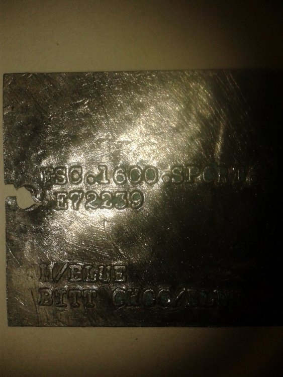

Sorted, no name or code but got a colour chip to match. Thanks. -

Thanks, will have to try that although the car had been recently re painted in its original colour (late last year in SA) prior to my purchase and has been garaged since so not exposed to any sunshine. Still would like to find a paint code for Cologne Blue. -

Thanks for replys, had it paint scanned (polished with G3 before scanning), aerosol made but still too light, tried 2 paint shops neither had colour chips for old fords. Need a paint code before Custom paints can do anythig. -
Hi Guys, need assistance again, trying to find some suitable rattle can paint to colour code the front spoiler on my V reg 1600 Sport recently imported from South Africa. The Paint Verf. on the Vin plate shows OP which I have found to be a Ford SA oiginal Factory colour of Cologne Blue however I am unable to get a paint code for this. Googling 'Cologne Blue (OP)' just gets hits on mens aftershave!! I have taken the boot lid to a paint shop and they used a Digital Colour Analizer thingy but the colour given was too light. I know the colour is available as my local parts shop supplied me with an aerosol from old ford colour chips which was a good match, unfortunetly I used all of that and the business is no longer trading. Tried a few local paint sprayers but no one seems to have old Ford paint chips around. Anyone help with a code ? Cheers, Jeff.
