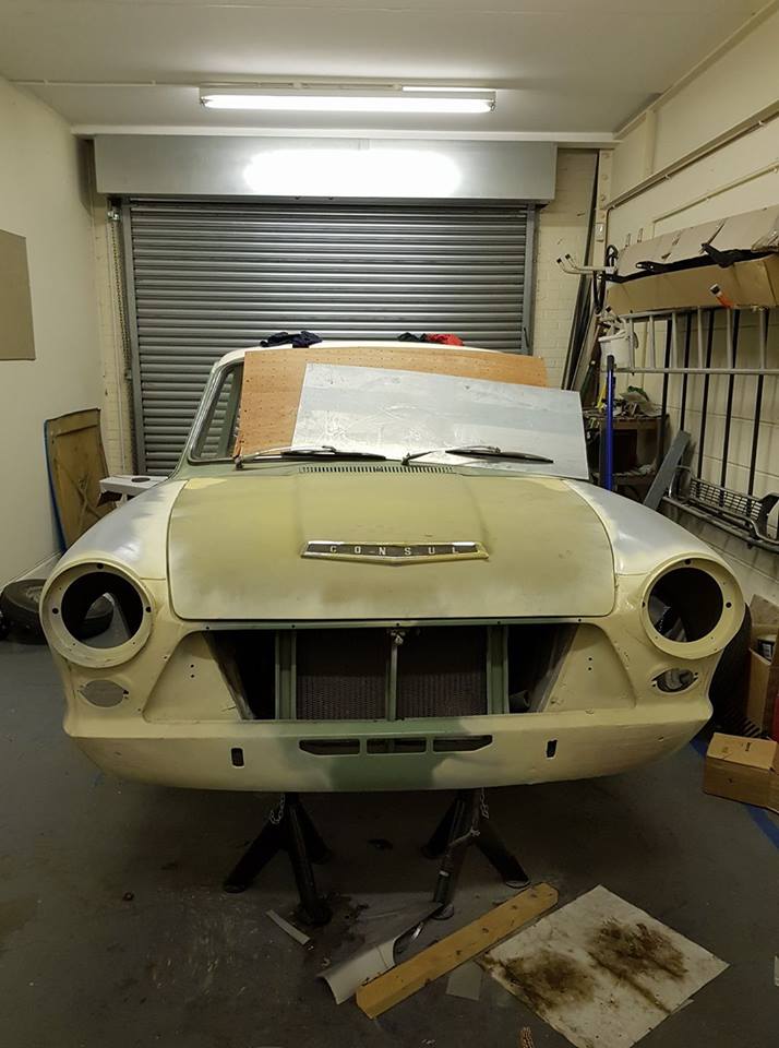

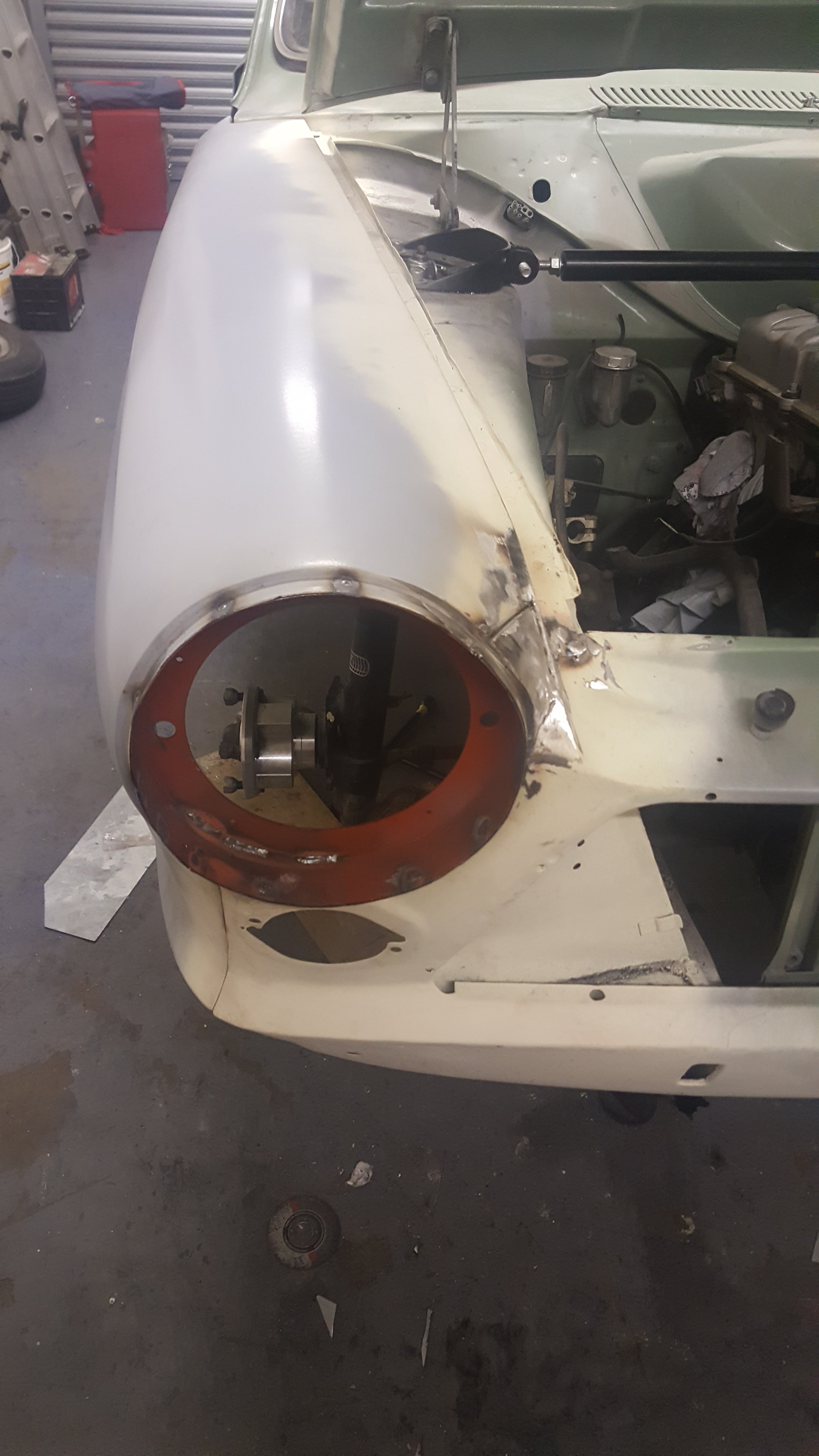

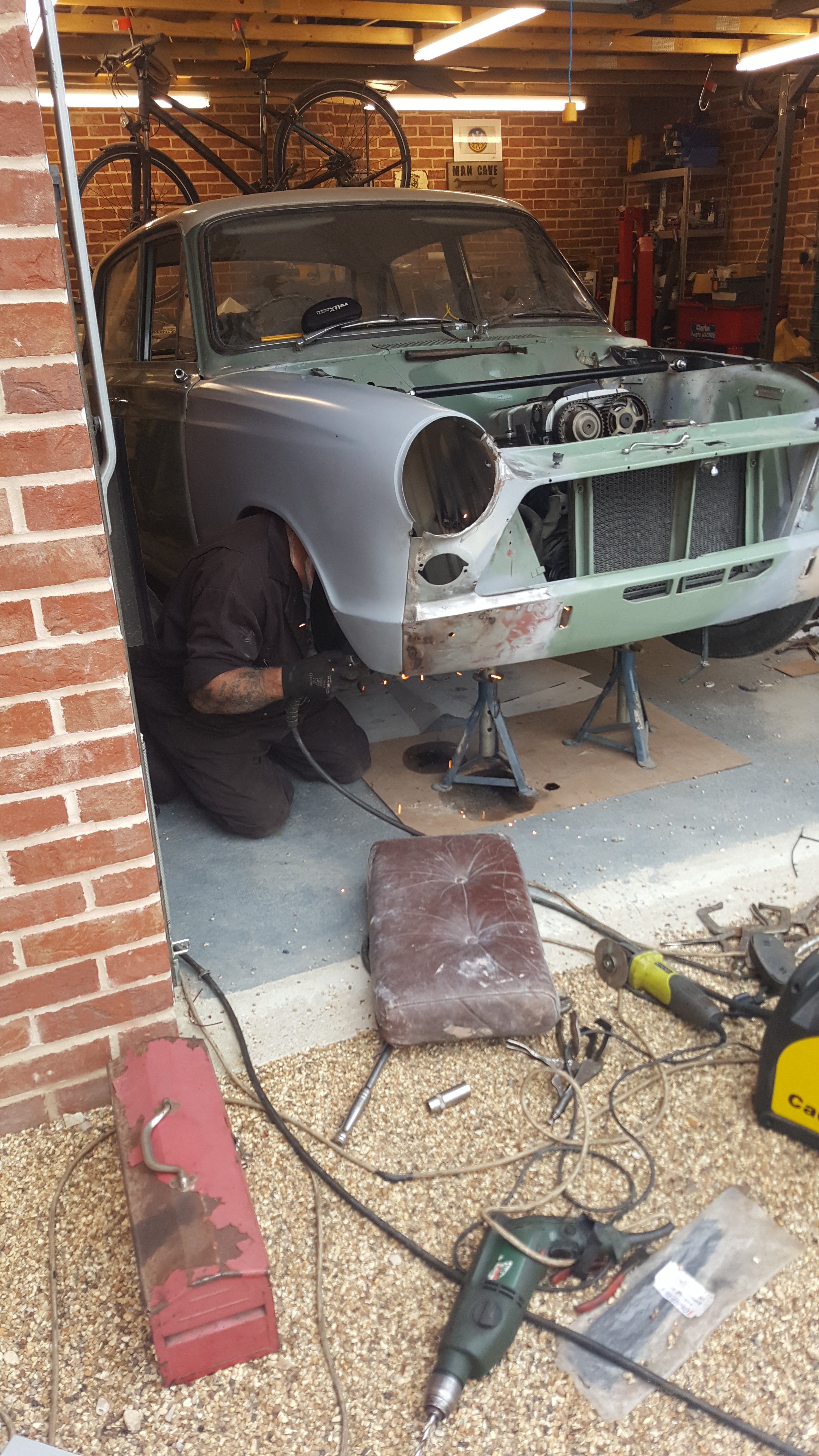

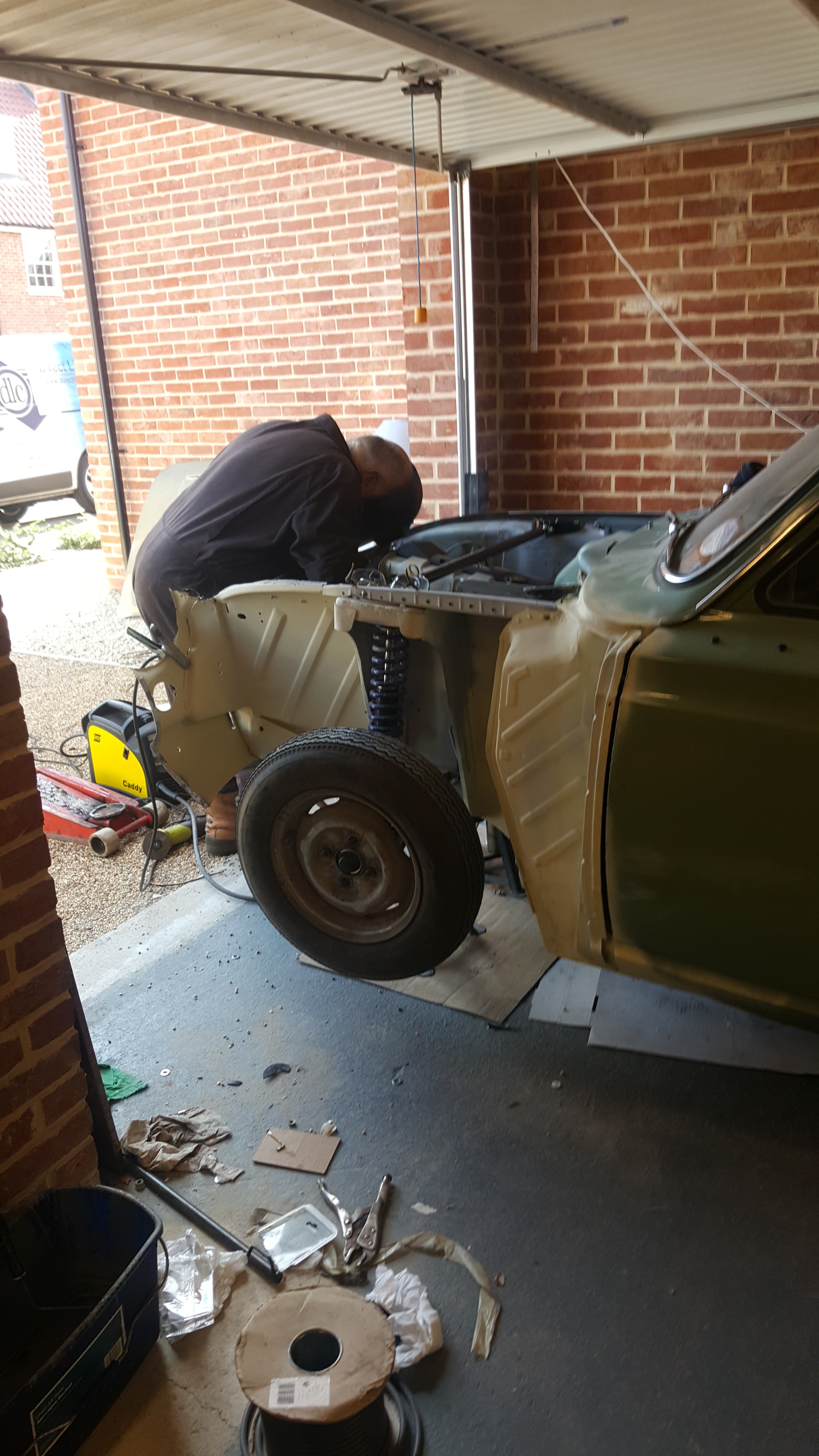

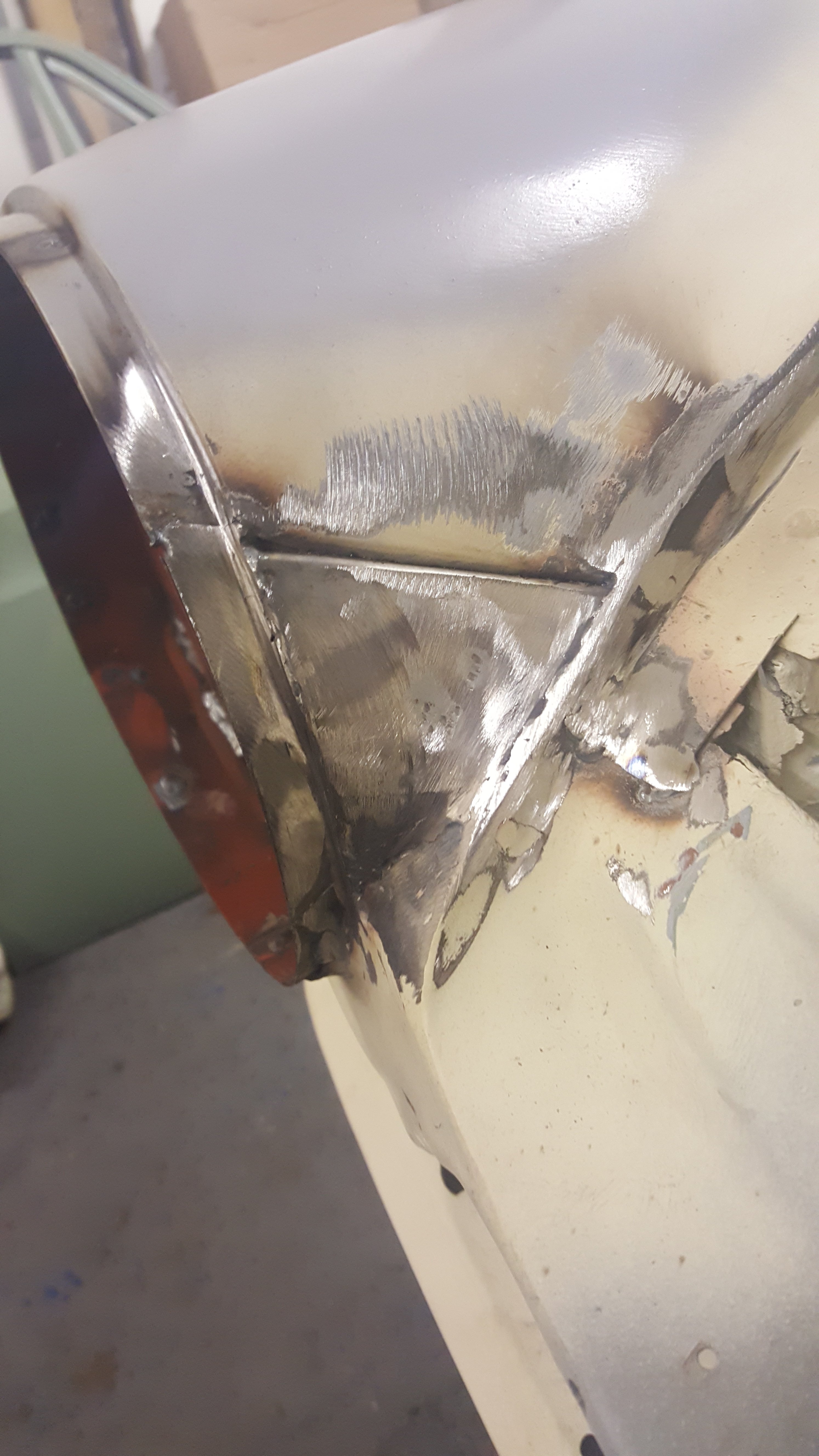

  2. Well that is the front end done now for the body work and the fun bit.

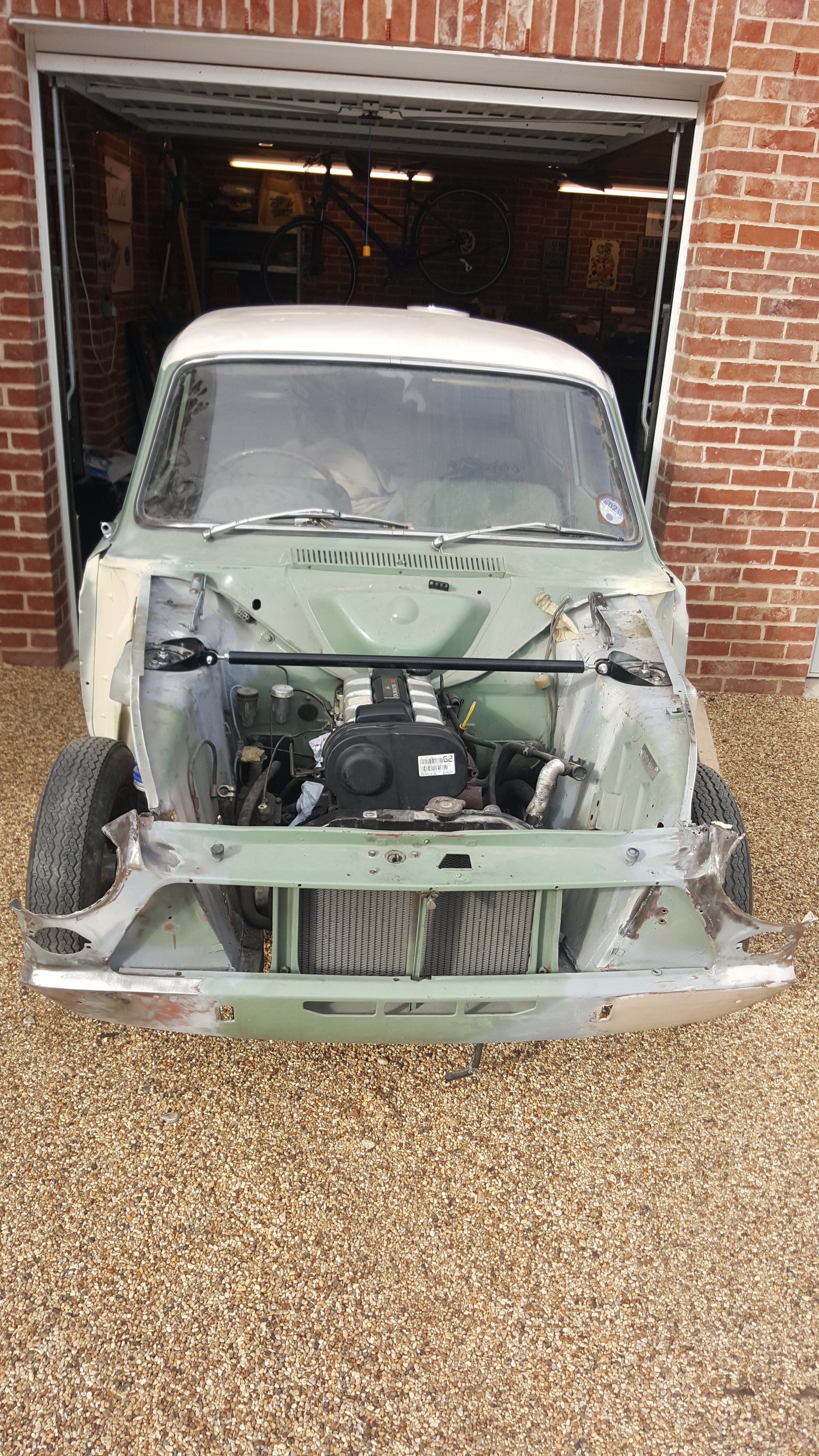

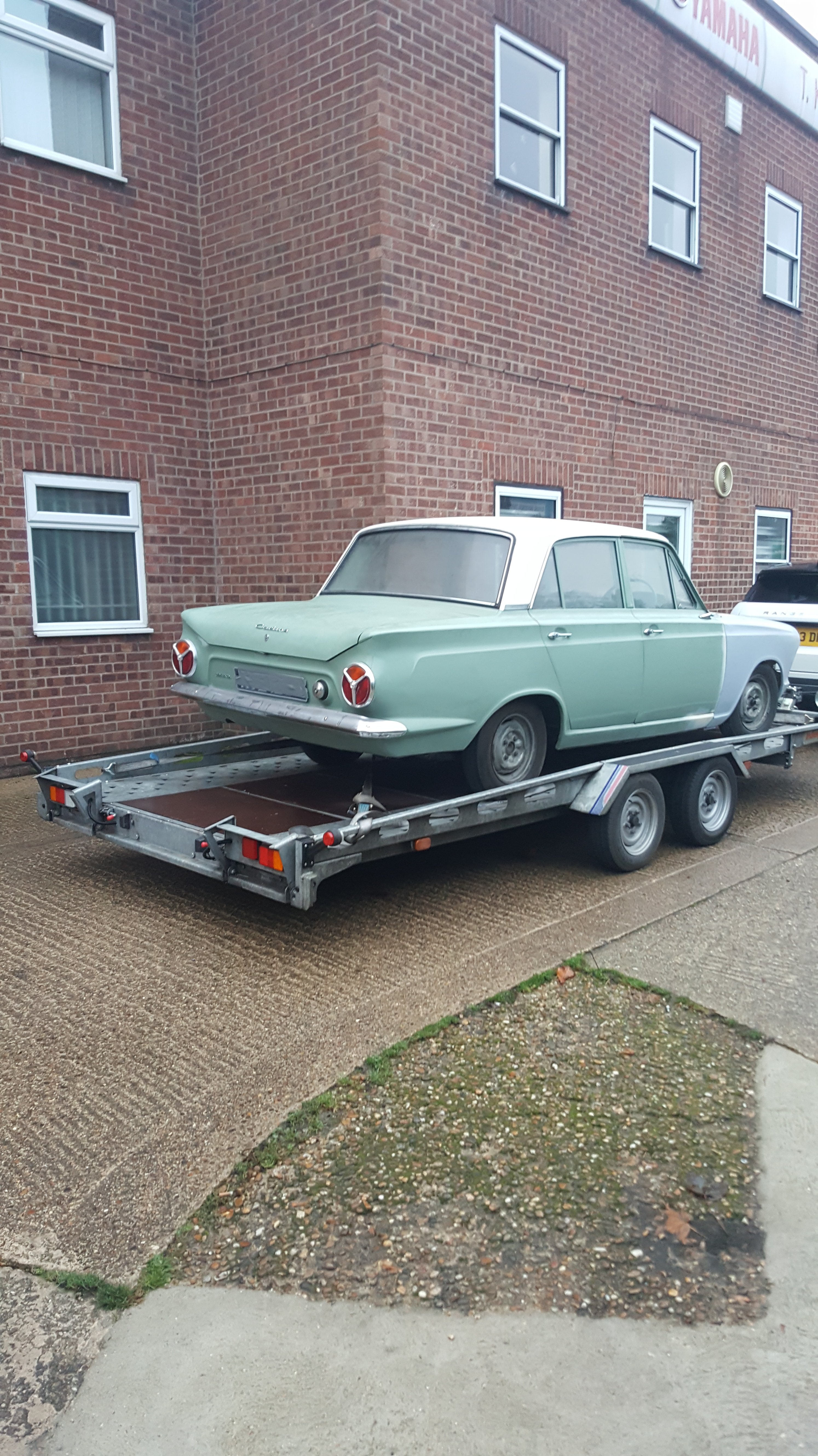

  3. here you go the spec at the mo is st170 zetec rebuilt type 9 box retro ford mk1 tina to type 9 bell housing gaz adjustable coil overs up front group 1 big brake kit with vented discs eccentric top mounts strut bar original cross member and steering box to make it fun lol and to comply with new 8 point system the work at the mo has been all up front as the rest of the car was done years ago by pre owner so it has had new inner wings new inner kick plates new strut tops new inner strut supports basically everything you see in primer and white etch is new i bought it with all this done all have had to do is put the new wings on but i am trying tor replace the bits that are not right like the driver sill is good but not the same shape as the passenger so trying to make as clean and original as the factory made but with a modern engine that will be fun to drive and it will haul ass as going to rebuild engine with forged pistons ect and turbo so a sleeper lol
  4. well here is my mk1 STina bought it with all matching numbers original 1200cc pre xflow and box had been fully rebuilt buy pre owner who worked for ford in the engine assembly part history is as follows 2 owners from new i am the third first guy ordered the car from new with all the extras the second guy whom worked at ford i bought it off was the son of the first owner full service history with ford up to 1989 then car was taken off road for restoration and repair after a crash then put back on road 1997 then taken off road again in 2012 to restore some more the guy lost heart in it after all the bad bits were done and now to me picking it up 5 months ago. were i am putting the new wings on that came with car and swapping the engine for the st170 lump and rebuilding the car and going through it to repair anything that needs it. will be uploading pics as i go
  5. hi guys sorry for late reply i could not access account as i cant remember username password or email address LOL and i have just sold the 300e and brought a all matching numbers mk1 cortina deluxe i am now squeezing the st170 lump in funny how life works o and the car has no rot and the price i paid you could not buy a two front wings for lol it was a bargain
