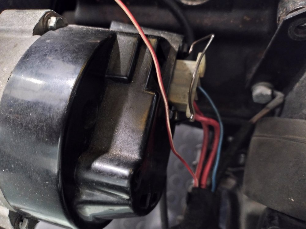

  10. Yes, bearings ok as were the brushes. The alternator didn't look that old so must have been a failed rectifier or regulator.
  11. Thanks for this. In the end I got a repair kit which I fitted this morning and pleased to say that my alternator is working properly now. Thanks again for everyone's advice!

  15. Thanks vista for the useful advice. I've now taken the alternator off and found that the the lower bracket is about 6mm shorter than the lug spacing on the alternator. There's some extra washers etc to make up for this. It also has two separate bolts rather than one long one going through both lugs. Is this normal?
  16. I I mean a Lucas substitute
  17. So the view is that it's better to get a refurbished Lucas?
  18. I think you are right that it's a Lucas!
  19. I'm pretty sure my alternator needs replacing. I've tested the output both at the battery and also at the two red wired terminals on the alternator itself. They measure 12.5 volts at tick over and there's no change when the engine is revved. There's no markings on my existing alternator so I'd like to know what specification I need. Details are: 1979 Escort currently fitted with a 1600 xflow (now1700cc). 70 Ah battery in the boot. Current alternator has 3 terminals, two thick red wires and a thinner blue one (which I assume goes to the ignition light?) Recommendations on make would be welcome too.
