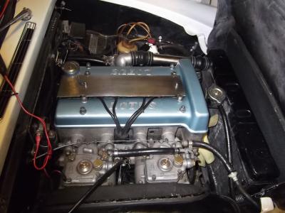

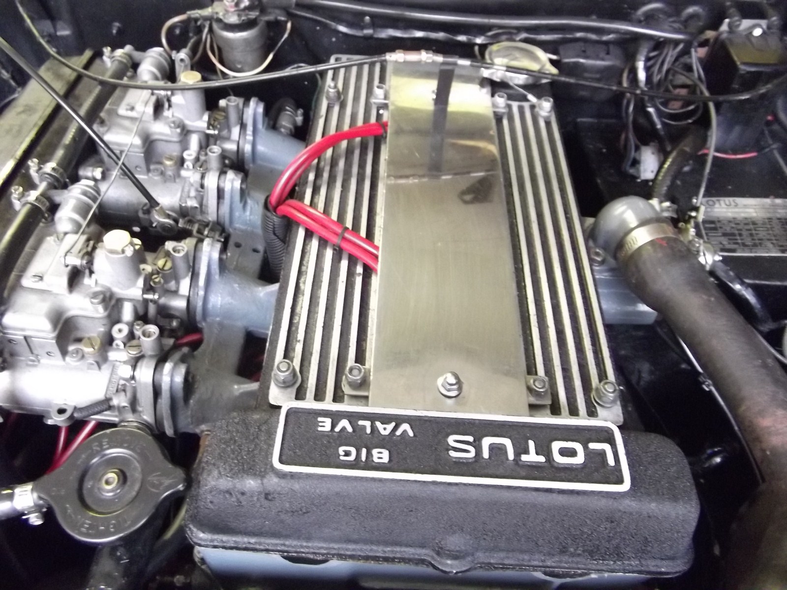

  3. I have done this modification before and have two cars running with valves I "modified" to suit although in their cases I used VW Transporter Inlet valves (40mm) and Nissan Exhaust valves (35mm) I just did not want to buy CVH valves only to find later that they were not 8mm stems. BTW what plans to you have for your Lotus head? Regards Brian.
  4. Thanks, my Lotus head is not standard and has bigger valves (41 & 37) so I will be ok on that score, did you manage to get a measurment on the RS turbo stem size? if as you say they only go in a little befor going tight then it sounds like they are 8mm and with a little reaming will probably work Regards Brian.
  5. Thanks, I would appreciate that Regards Brian.
  6. Thanks, yes I know the length and that is one of the reasons I want them,it is for a modified Lotus Twin Cam and it is no problem to change the length and machine a new cotter grove. I need a 37mm Exh Valve and a 41mm inlet, the XR3i has a 37 and 42 but I may be able to use the 42 inlet as well, it is the stem than I am bothered about. Regards Brian.
