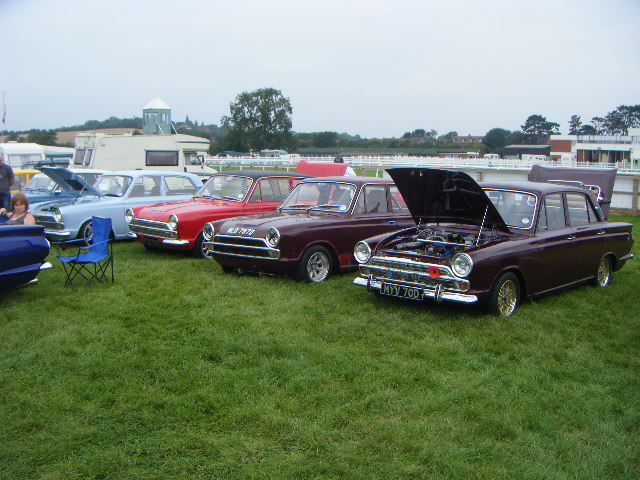

puddy Posted August 25, 2012 Report Posted August 25, 2012 I have, lowered and on 7x13 superlights. Modified the rear arch lips a bit,but they still rub over bumps, but I am on 185/60/13's ,I think it would be ok on 175/50's.

puddy Posted August 26, 2012 Report Posted August 26, 2012 i have been told 175/50/13s and 195/45/13 well be ok but not to sure as i dont want to get them and then have to mod the body I spoke to a guy at the mk1 cortina nats a couple of weeks ago, who was on 7x13 superlights and 175/50's who said they did not rub but he had cut the arch inner lips back. puddy
