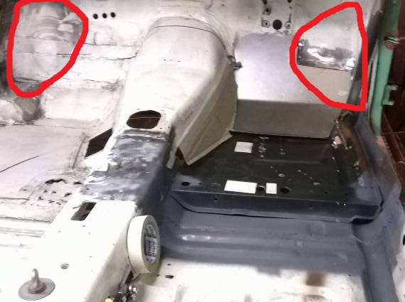

5tox Posted January 31, 2014 Report Posted January 31, 2014 What are the bits circled in red called, can they be bought from anywhere if not are there any cars with a similar size / shape that i can pop down the scrap yard and chop out? mine are shit on the mk1 escort and need replacing
over_head_cam Posted January 31, 2014 Report Posted January 31, 2014 I'd call them upper footwels, but not sure of their proper name, or if they're available. The last one I did I had to make
Escort Mk1 4 Door Posted January 31, 2014 Report Posted January 31, 2014 i had to make my own as tbh u cant see them when its finished
5tox Posted January 31, 2014 Author Report Posted January 31, 2014 i have no idea how id make these, dont you need one of those rolling machines (whatever there called)
5tox Posted January 31, 2014 Author Report Posted January 31, 2014 do you have any useful pics that could help me if i have a go myself at copying / making them
Escort Mk1 4 Door Posted January 31, 2014 Report Posted January 31, 2014 i flat sheeted them ill get some if i can tomorrow

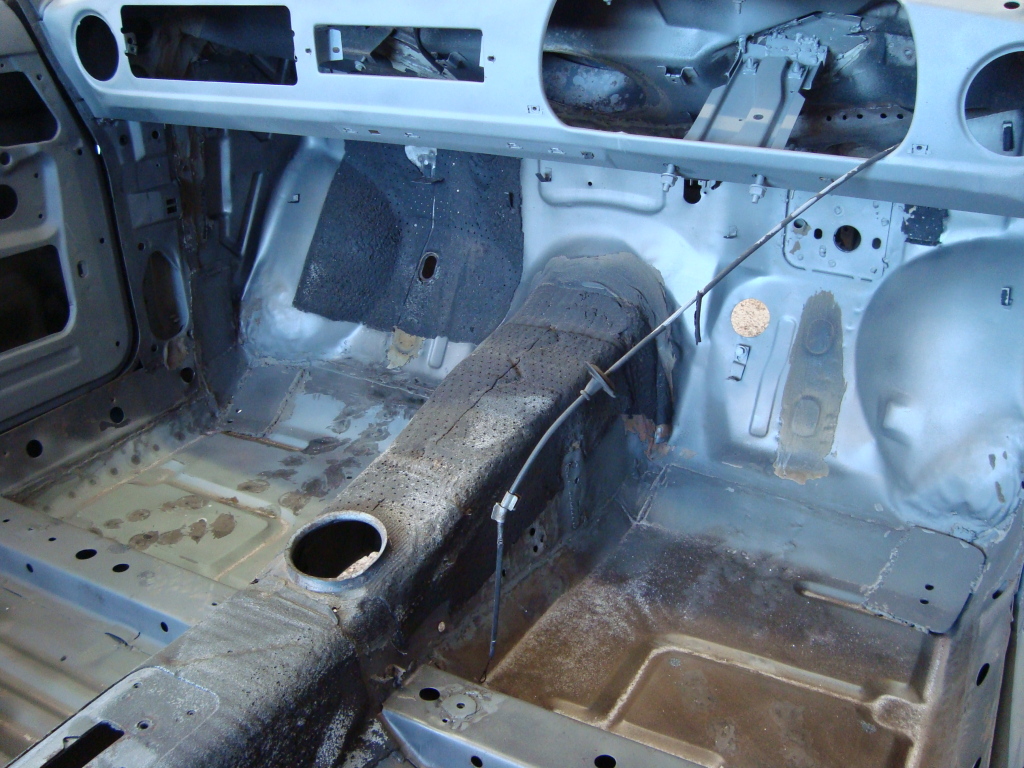

katana Posted January 31, 2014 Report Posted January 31, 2014 What - you mean the bulbous looking bits in attached photo? They are the inner wheel wells and they are part of the engine bulkhead pressing..............and no they aren't available separately that I can find!
5tox Posted January 31, 2014 Author Report Posted January 31, 2014 yup thats what i need, i have an oil drum up the end of the garden which ill cut up and try to modify tomorrow
PaulMags Posted January 31, 2014 Report Posted January 31, 2014 You should be able to get them out of a mk2 old 4 door scrapper they'll be the same.why dont you try escort tec.mk1 mk2 floors are the same.
5tox Posted February 1, 2014 Author Report Posted February 1, 2014 ill see how much escort tec want for a pair, although im still quite keen to have a go myself
deadly456 Posted February 5, 2014 Report Posted February 5, 2014 Ye there part of inner arch and sort of a bubble shape,should be able to get them from GS ESCORTS
