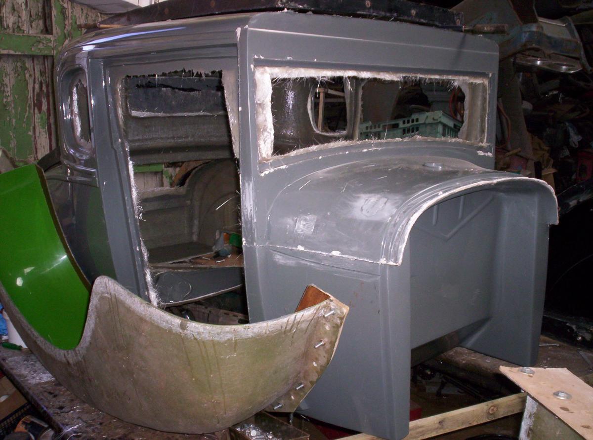

eeb43 Posted December 21, 2016 Report Posted December 21, 2016 as i said glass is easy!!!!!! made this for a customer earlier this year 1
