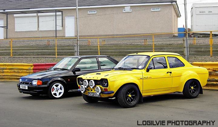

Old Skool Member
Old Skool Member (3/15)

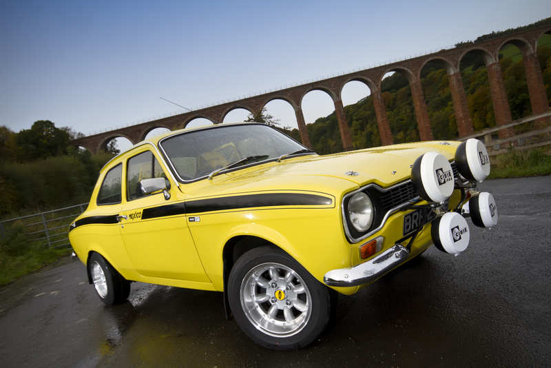

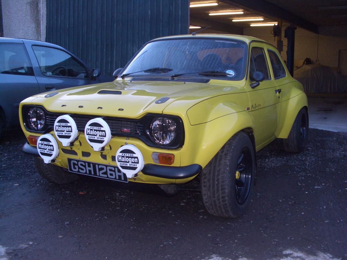

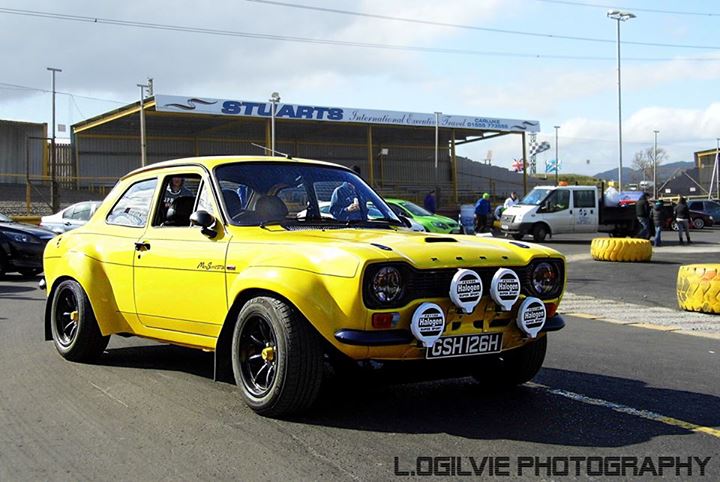

  2. Well that's it all done also road tested today and it's simply stunning, up and till now with the rear axle configuration I have on this car I thought I had a lot of grip, but now it's a handful just to keep it in a straight line

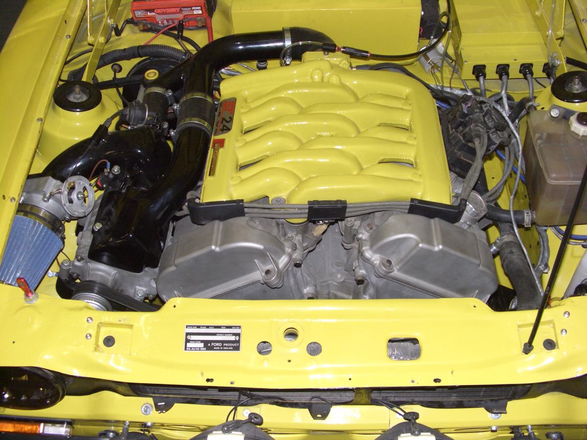

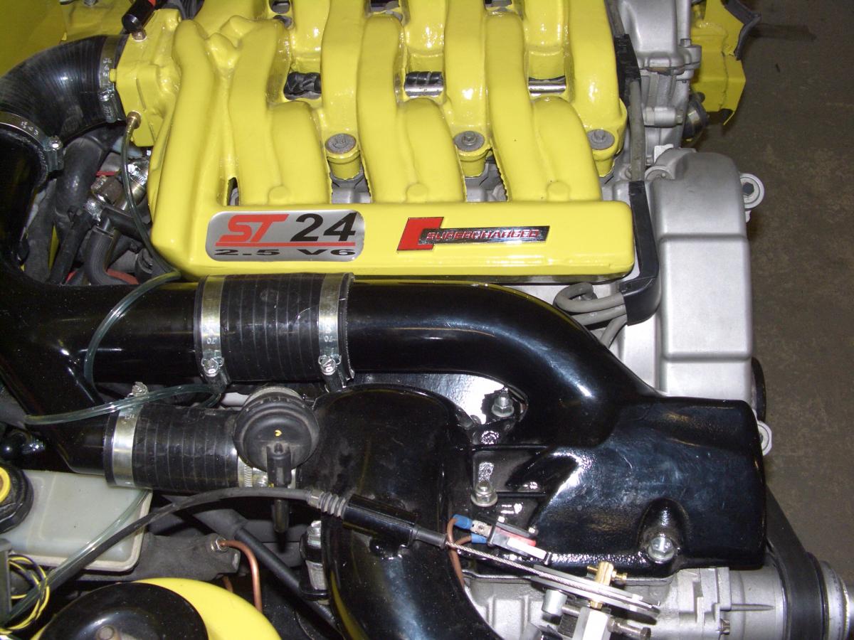

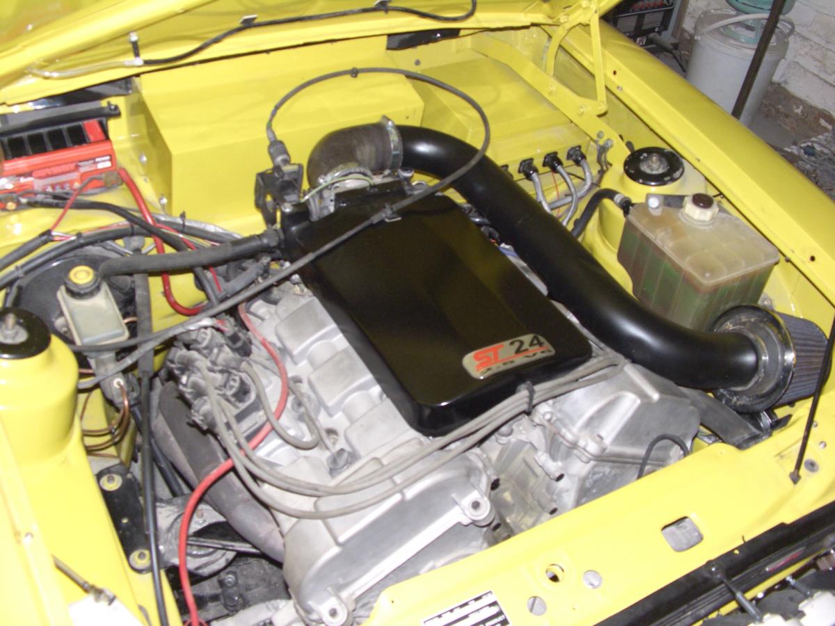

  3. Now that the car has been well tested over the summer months with no major hic-ups, it was always my intention to upgrade the engine to Supercharged over the winter months, yet another delve into the unknown. For the techy minded: using a blower from a Merc SLK230, using a by-pass system from a Mini Cooper, also going to try water/methanol injection to keep the charge temp down on WOT as I have no room for an ugly inter-cooler system

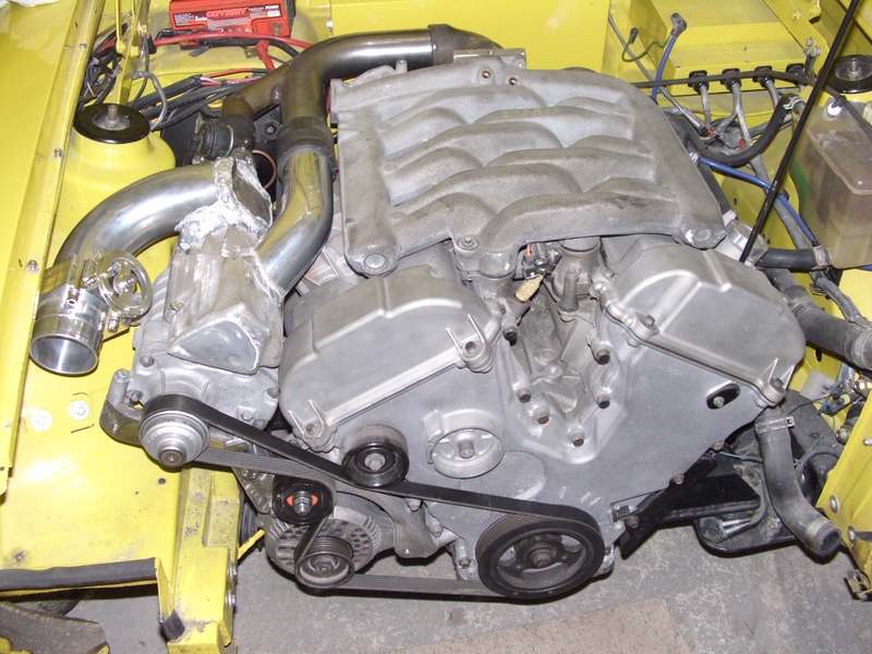

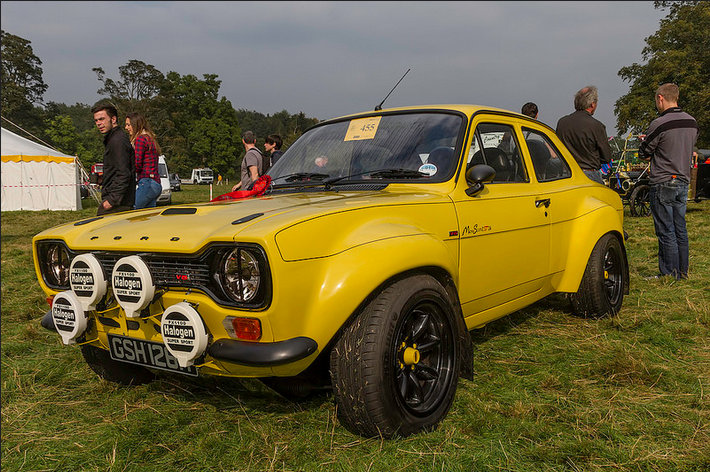

  4. Last pics for the year, its now off to hibernation til April. The plan is to upgrade her to a Supercharger

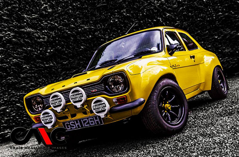

  5. A young lad starting out doing car photoshoots, had a practice shot with my Escort at the weekend, have a look at his web site: www.cmc-images.com

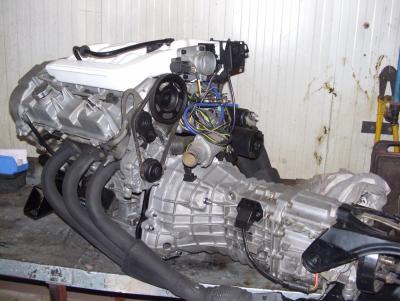

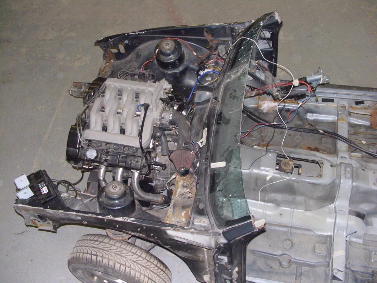

  6. £600 all in with wideband controller, 240hp & 215lbs @ 5500, a lot of head scrathing to get all working but interesting work, worth it in the end
  7. It's a 2.5 V6 Duratec from a Mondeo, the only mods are: I removed all planet saving stuff from the engine and fitted up a Microsquirt engine management system. Cheap as chips and goes very well

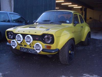

  9. They are 100mm wider than normal all round made from steel
  10. Yeh, when you see this in yer mirror, you make way

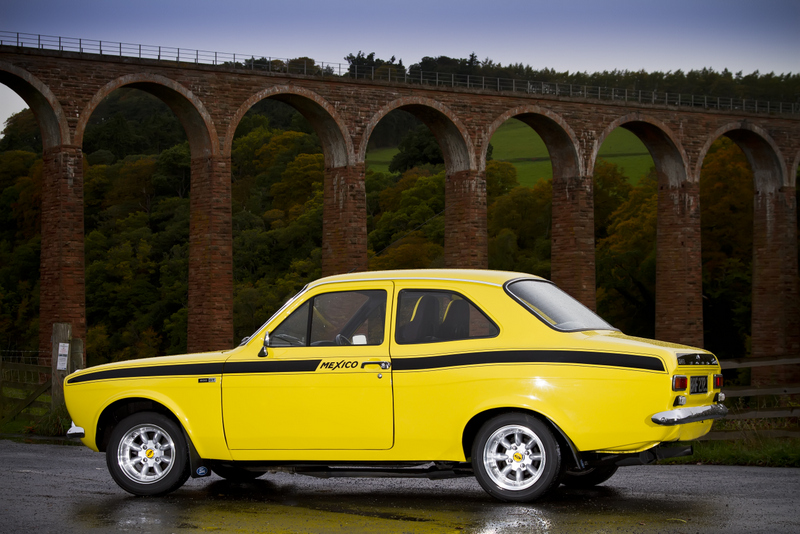

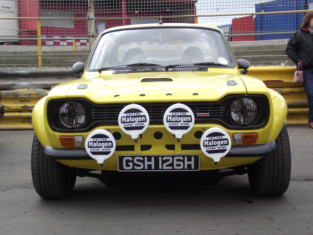

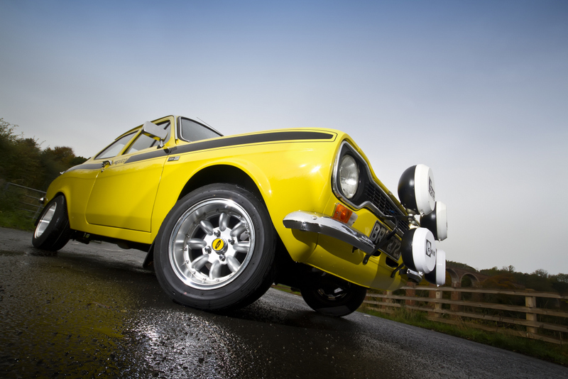

  12. This pic was taken at a local meet night, I think it shows off the classic Mk1 body lines?
