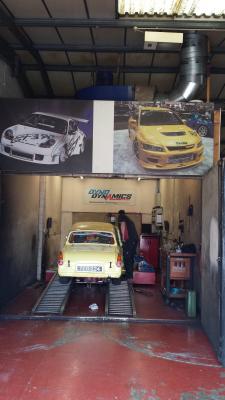

aardvark101 Posted May 21, 2014 Report Posted May 21, 2014 So after my Z-tec install, i took Keith down to Redline Tuning in Basildon today to get him mapped, last time i was this nervous i was in the maternity ward Well pleased with the results BHP 160.00 Torque 150.00 May have to give the Pod a go @ Classic Ford 1
bigbadsquare Posted May 22, 2014 Report Posted May 22, 2014 What set up are you running ? Engine? Induction? Ecu? Cheers Paul
aardvark101 Posted May 22, 2014 Author Report Posted May 22, 2014 Yeah bit of tidying up and a sort out on the exhaust, and im good to go. 2.0 Blacktop (crate) GSXR 750 TBs on an ST170 manifold Retro furd manifold Omex 600 Dyno was £350 + a couple of hours labour sorting out linkage,cable etc
