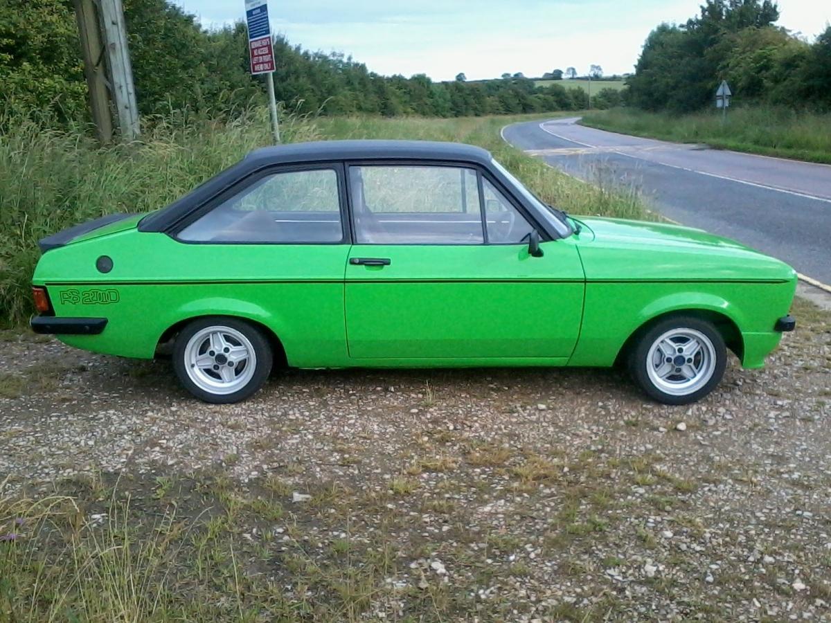

PeteRS8084 Posted January 25, 2015 Report Posted January 25, 2015 Hi all, quick question and I am sure your advice will come flooding in. I have 6x13 RS alloys, with 175/50/13 yokohams. These alloys really could do with a refurbishment, but I am toying with the idea of getting some 7x13 either superlights/minilights. I would put on the tyres from the RS alloys. So the question is: will these fit without having to have the arches rolled, you can see a picture of my flatfront on my profile/garage to give you an idea of the gaps I have to play with. Any advice greatly received, Cheers Pete.
RossMK2 Posted January 25, 2015 Report Posted January 25, 2015 If they are the usual -7 offset, you may get away with front depending on front spring rate. But i would advise rolling rears at that height 1

mk1del Posted January 25, 2015 Report Posted January 25, 2015 Got 7x13 rs copy from midland wheels with 185/60+13 on mine clear fine check photos,, my arches are rolled slightly and lowered 1 1/2 inch 1
RossMK2 Posted January 25, 2015 Report Posted January 25, 2015 Got 7x13 rs copy from midland wheels with 185/60+13 on mine clear fine check photos,, my arches are rolled slightly and lowered 1 1/2 inch The differance is they are +6 offset, giving a instant 11mm more clearance from arch 1
Benjy✌ Posted January 26, 2015 Report Posted January 26, 2015 On my mk2 to get 7s on I had to roll the rear! Only a little bit tho as it rubbed when you went over a bump in the road
mk2 mike Posted January 26, 2015 Report Posted January 26, 2015 My 7x13s (et-7, 175/50/13) rubbed slightly on the near side when going over BIG bumps and the car was 2 up. Fitted a pair of Gaz adjustables to the rear, stiffened 'em up a bit and all is good now. [emoji106] I've not rolled the arches and my car is dropped by 2 inches. 1
Admin Mk2Jo Posted January 26, 2015 Admin Report Posted January 26, 2015 I have 7 x 13's on mine but had to have my arches rolled as they kept scrubbing

PeteRS8084 Posted February 9, 2015 Author Report Posted February 9, 2015 Checked her this weekend and she's got 2 inch lowering blocks on......... So its either full removal and back to standard rear end height, or may be because I will be fitting my rubber bands, 175/50/13s I might change to 1 inch lowering blocks...............decisions decisions lol. Pete
Bonsai78 Posted February 24, 2015 Report Posted February 24, 2015 I have 7x13 minilites et0 on 175/50s, standard arches, lowered about 3 inches - no rubbing. 1
