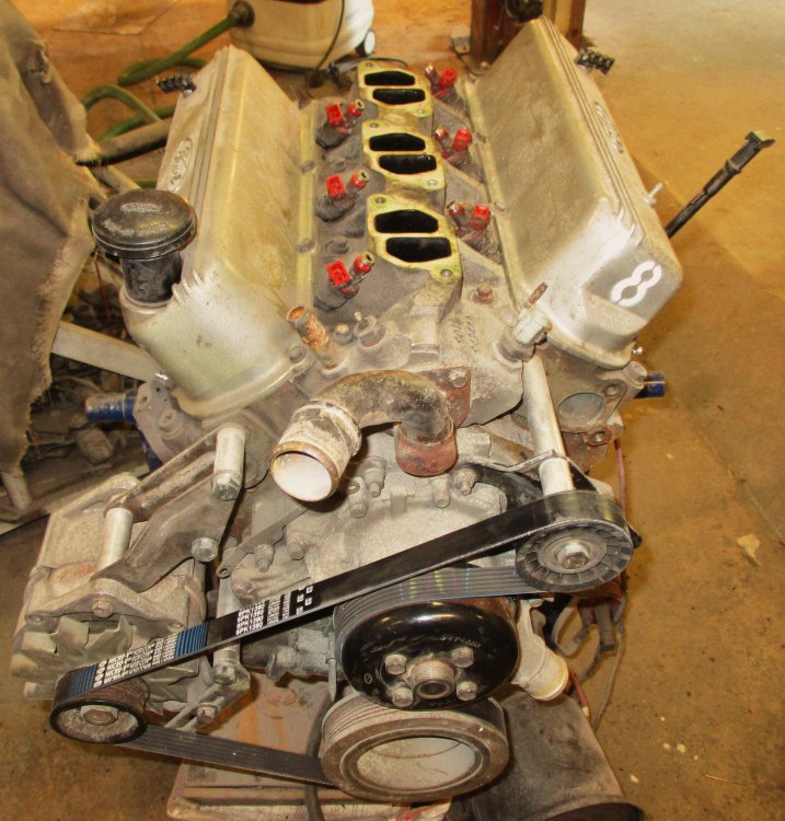

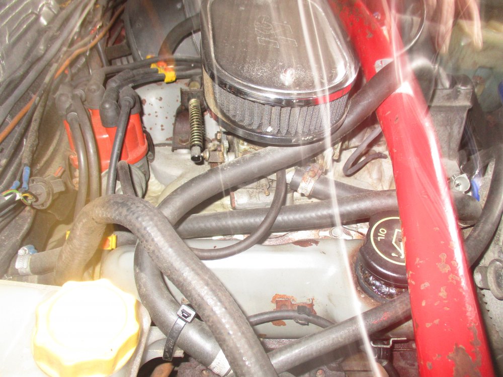

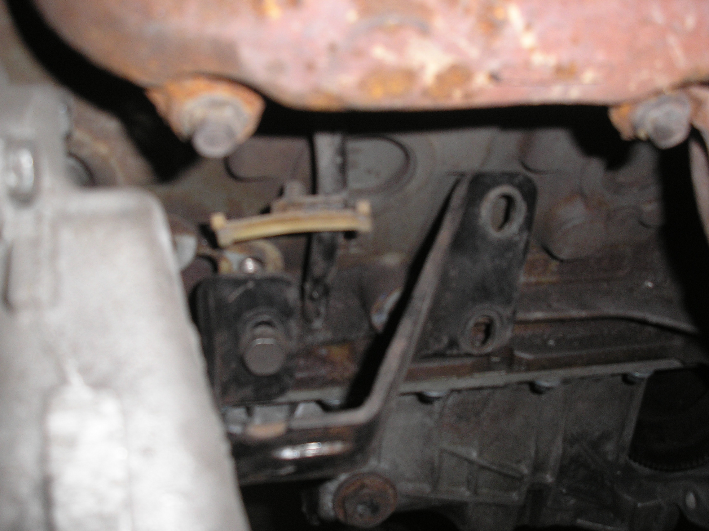

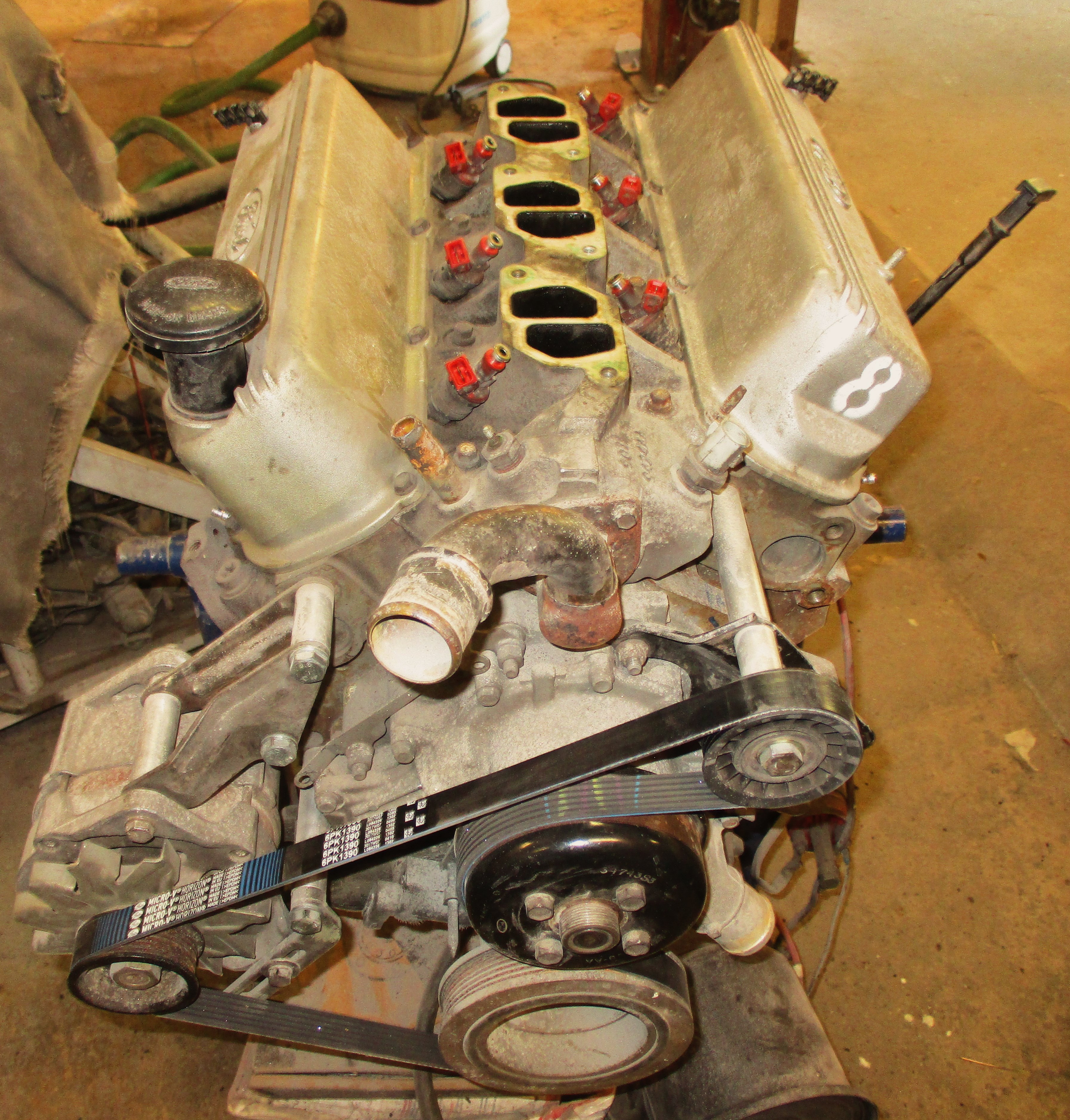

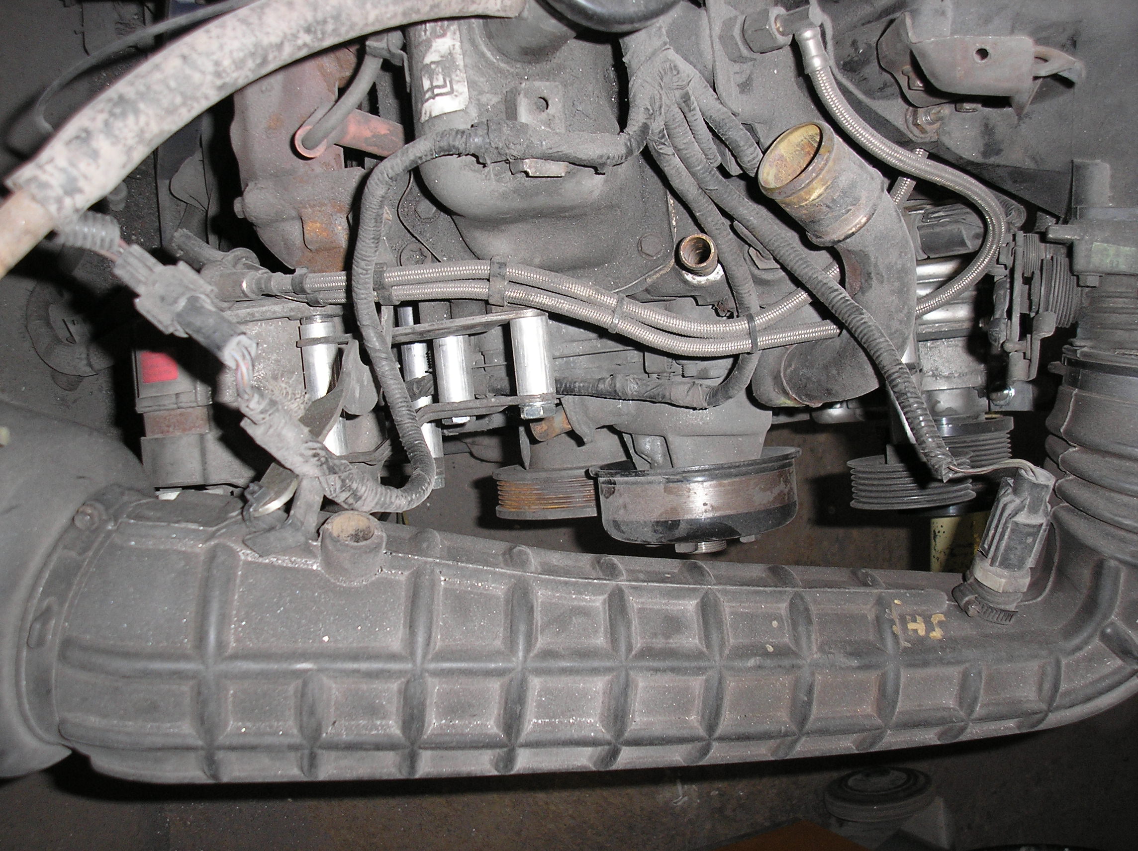

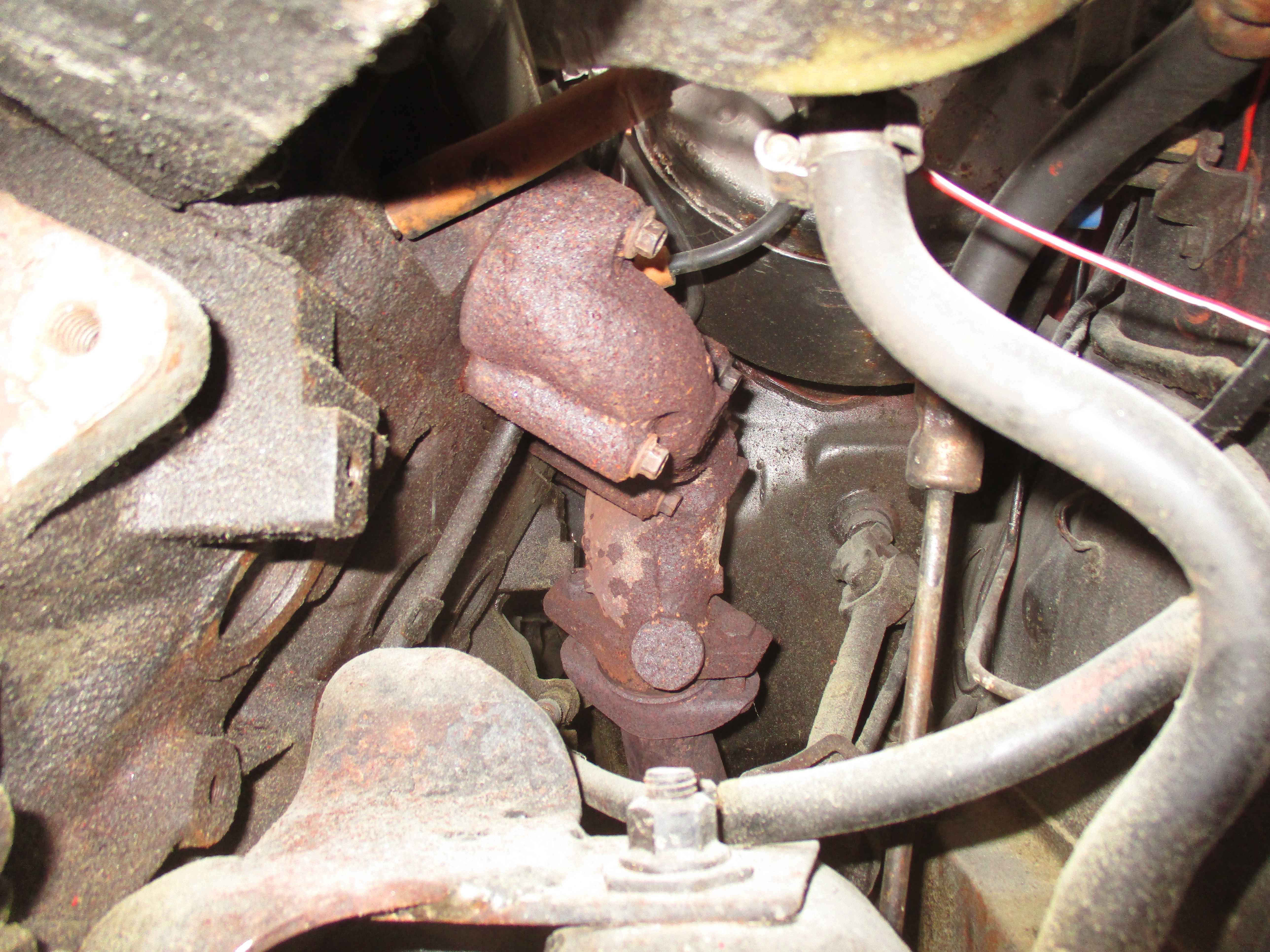

John escort mk1V6 Posted August 18, 2017 Report Posted August 18, 2017 The 4,0 ohv is higher and the oilpan is about 10 mm wider but at the engine mountings is width the same and it also fit at the t9 gearbox but this wil be to weak i think , so a t5 will be better , but there a few , and there are 2 different crankshafts a 6 and a 8 holes one , a 2,8 gots a 6 holes one so the flywheel fits. But on the left side the mountingsholes for the engine brakets don`t at up just one hole does. The carb pic`s have got from the web.
lee_capri Posted August 18, 2017 Author Report Posted August 18, 2017 are you doing this conversion at mo john interesting john on the engine mount cant you fab some steel to it on crank hole i have also been looking at seen a 6 but seen plenty of 8 also looked at fly wheel the best i can find is a 18 tdci flywheel but need to find what spline it is as would want to mate to a type9 or rx8 gear box which are both 21 spline

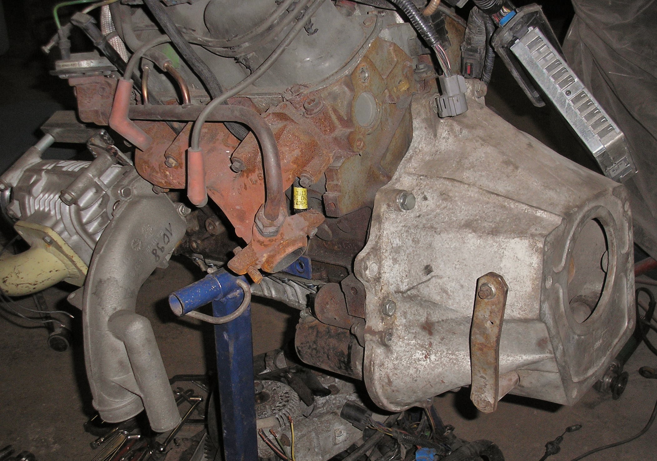

John escort mk1V6 Posted August 18, 2017 Report Posted August 18, 2017 No it`s on a hold for now , i want put it one day in mine mk1 , with 2 turbo`s or with trottle bodies on it. I did already weld some nuts to the engine for the mounthings , maybe i change that at the time when i gonna put it in. The rocker covers fit from the Granada mk3 2,8i, you just need to drill one extra each. The bellhousing is from a mustang 2,8 V6 4-gear about `77 or so with a T5 pattern. The eaton M62 i have sold , becourse i needed the money and it is to small , for some power you wil need a M90. The electric stuff is not mine thing , but with trottle bodies you get a ECU what is to ajust and so one. The oilpan is allready modived , i have also got a crossmember with the lower mountings for the steeringrack and a longer steering joint. The flywheel/clucth i have from ebay.us , and i tought i have seen the 8 hole flywheel also. There is a guy that drives a capri with a 4,0 ohv. http://www.ebay.com/itm/FX-STAGE-1-HD-CLUTCH-KIT-SLAVE-FLYWHEEL-97-00-FORD-EXPLORER-RANGER-B4000-4-0L-/401385536166?hash=item5d74713aa6:g:~~8AAOSwMtxXsgey&vxp=mtr http://www.ebay.com/itm/FX-STAGE-1-HD-CLUTCH-KIT-SLAVE-FLYWHEEL-97-00-FORD-EXPLORER-RANGER-B4000-4-0L-/401385536166?hash=item5d74713aa6:g:~~8AAOSwMtxXsgey&vxp=mtr

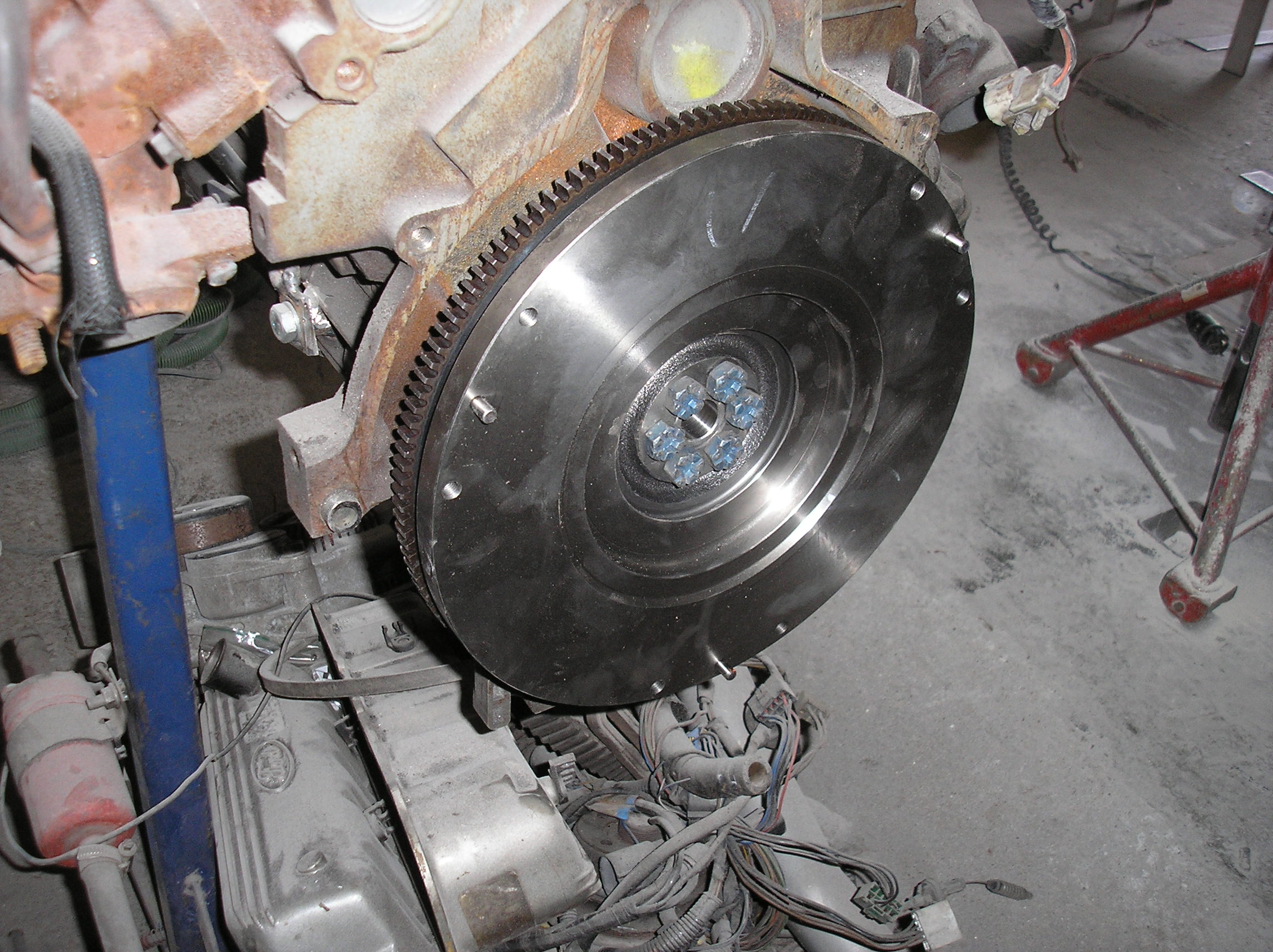

lee_capri Posted August 19, 2017 Author Report Posted August 19, 2017 i looked at that you could buy that kit for 8 bolt and use a mazra rx8 of same quality plate in the middle am i right in thinking to convert to carb possable just use the old 2.3 or 2.8 granny manifold with i think it is a 500 Weber which is for a v8 il have to google to be precise john has you got engine as it got the hole at the back to drop a dizzy in to or not because in one of your pics it looks like it has a plate over it with bolt these engines must be some good because they put them in the mustang which is a huge car

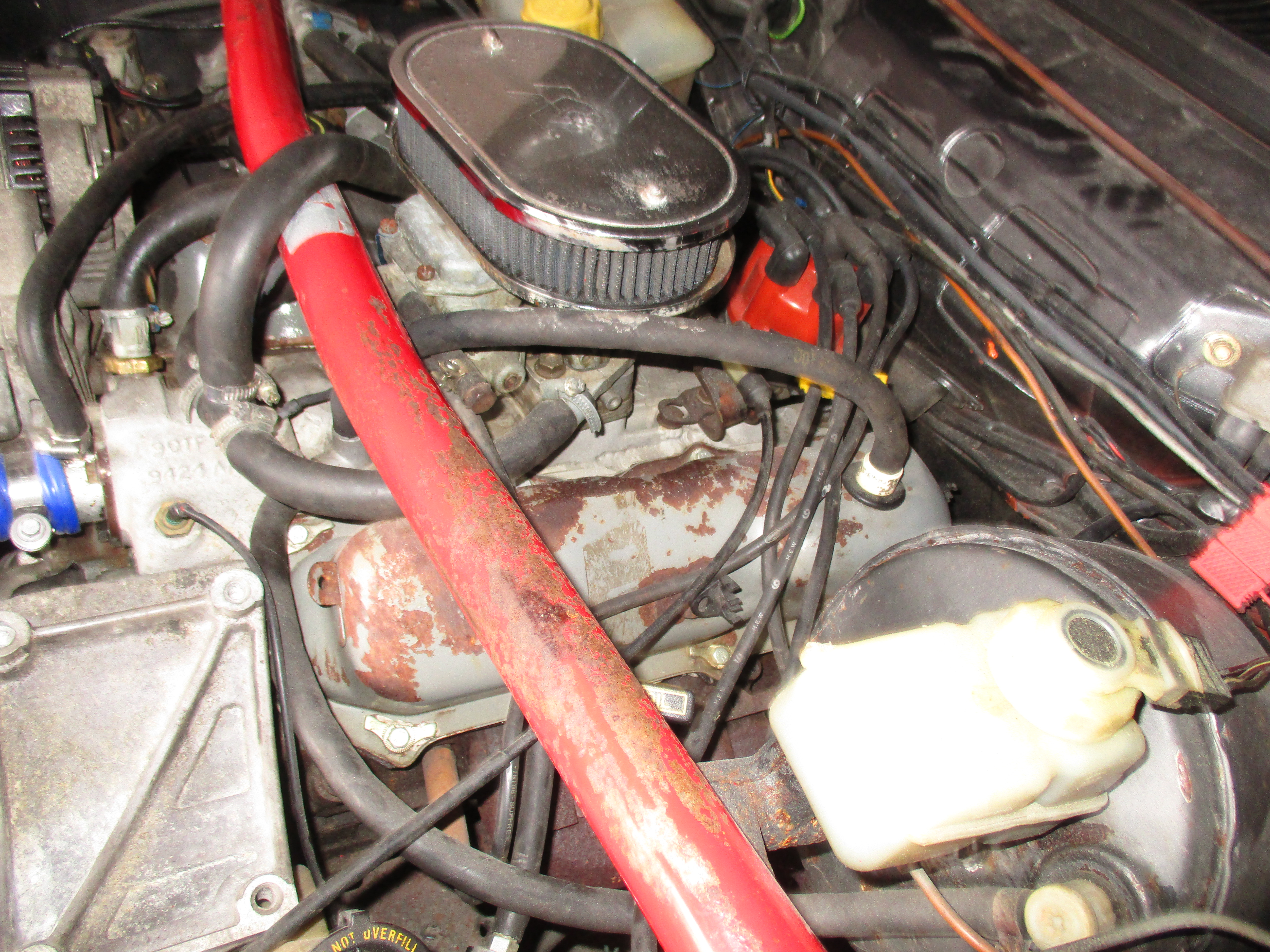

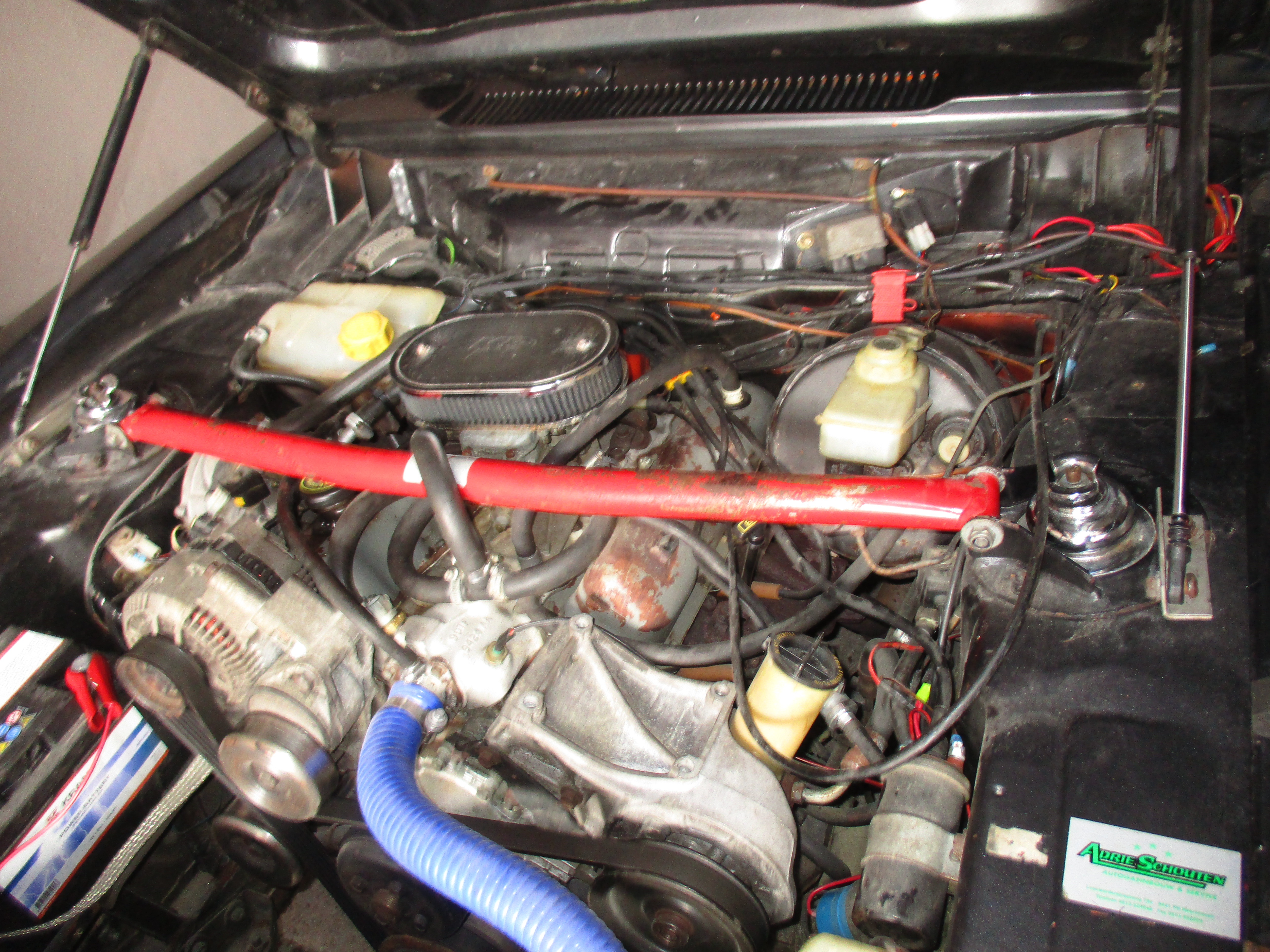

John escort mk1V6 Posted August 19, 2017 Report Posted August 19, 2017 Hi Lee , this moring i did pick-up same wheels and the guy that i bought them of , did have also just bought a capri 4,0 ohv with a carb , and that did sit on a 2,8 inlet manifold that was welded into the Original 4,0 manifold , this idea i have also tought about , but that for the future. I have got the orginal 4,0 electrice dizzy on it , but just what i said it on a hold , so what i to day saw the Original dizzy can build in it , [maybe it needs some ajustment] With the 2,8 dizzy in it , these 4,0 ohv engine`s seems not to bad the later 4,0 ohc seems not so reliable , no the mustangs got another engine 4,0 , the 3,8 mustang is based on the 3,0 essex so for the guys who have a 3,0 capri/Granada maybe a nice upgrade / check it first your self.

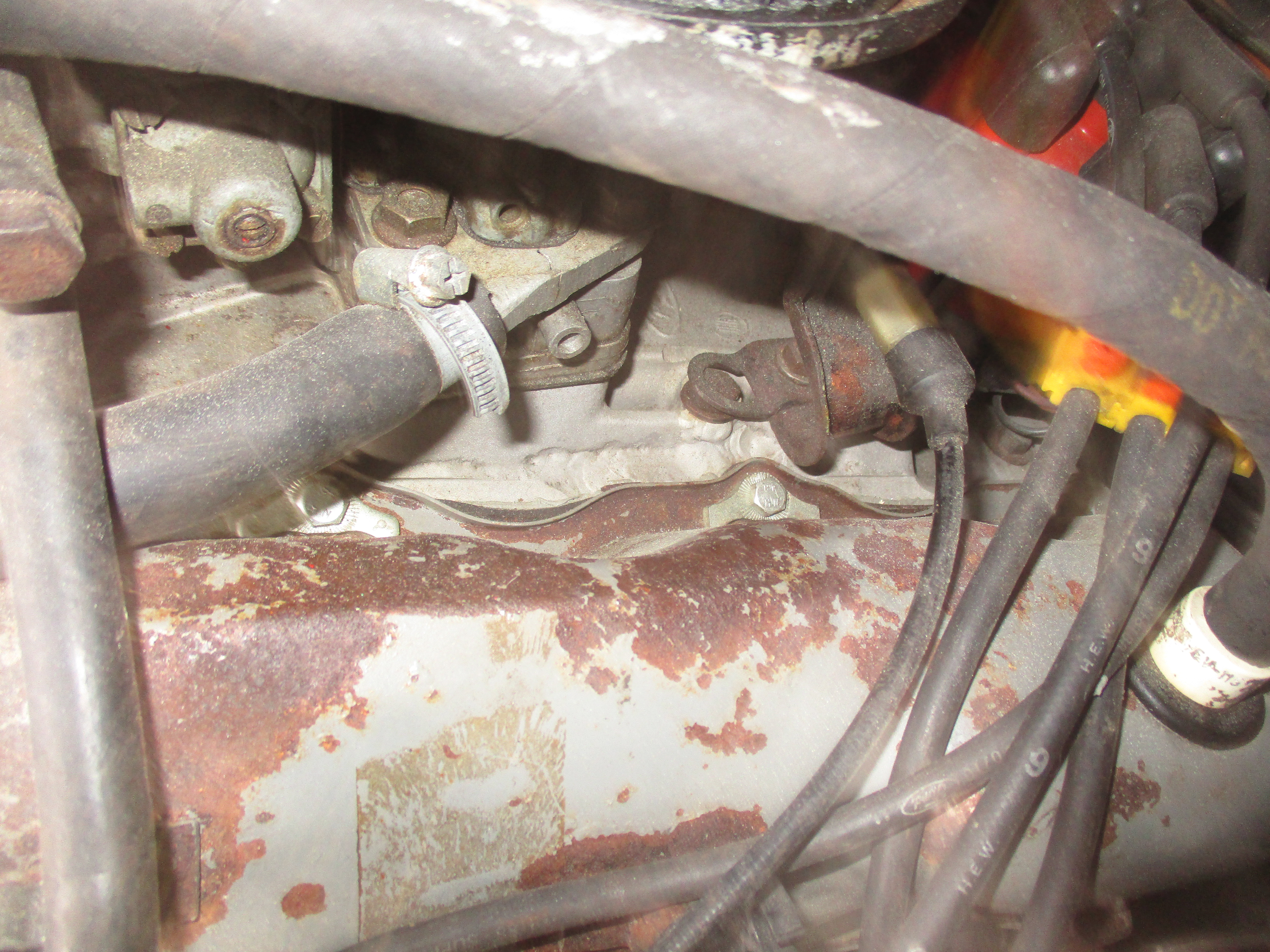

lee_capri Posted August 19, 2017 Author Report Posted August 19, 2017 nice pics john and i have a granny that im looking at doing it to i thought it would take a dizzy and i have a spare inlet manifold to play with in pic5 what is the blue pipe coming off inlet do you know by any chance seams like a simple enough engine swap for my granny at the mo ive got a 2.9 efi with lume to go in to it but i would rather do a 4.0 i could possible run the 2.9 lume keeping it fuel injected with twin platinum has a 2.9 comes has stranded like that and has better pick up then the 24v cossy lump having owned lots of each
John escort mk1V6 Posted August 19, 2017 Report Posted August 19, 2017 Thanks Lee , i don`t know how much work it is and also can`t tell you what needed to complete this rebuild. The blue hose the waterhose normal it got a bent cooperwaterpipe , that goes to the radiator. It can bedone whit out to much trouble and the 4.0 gots more torch than the 2,9i 24V cosworth but less hp only 155/165 hp. If you got the money there a also for sale a racing 4,0 ohc 375hp complete but that will be some changes at the bellhousing mountings and clutch.

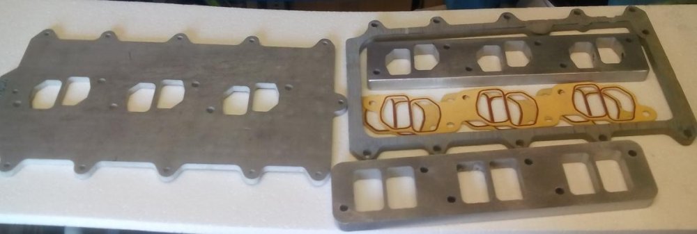

John escort mk1V6 Posted August 22, 2017 Report Posted August 22, 2017 Hi Lee , i been looking at again and if you want to go carburators , i would say go for 3 webers 40 mm DCNF , and than make a plate for it , that can bedone. Or bike carbs , but what i want do is mounting a pair trottle bodies 50mm with a stand alone computer , just for the injectors and dis coil and such. And also make a plate with pipes for it.
lee_capri Posted September 17, 2017 Author Report Posted September 17, 2017 or you could go 4 barrel carb on it or a pair of 4 barrels looks like a easy manifold to convert to fit what you like on it really and some nice pics to i picked up a 2.9 the other day from a mate on here lol but im not sure were im going with it all at the moment has having change of planes but what ever it will be a cologne in it might have another carpi yet lol
