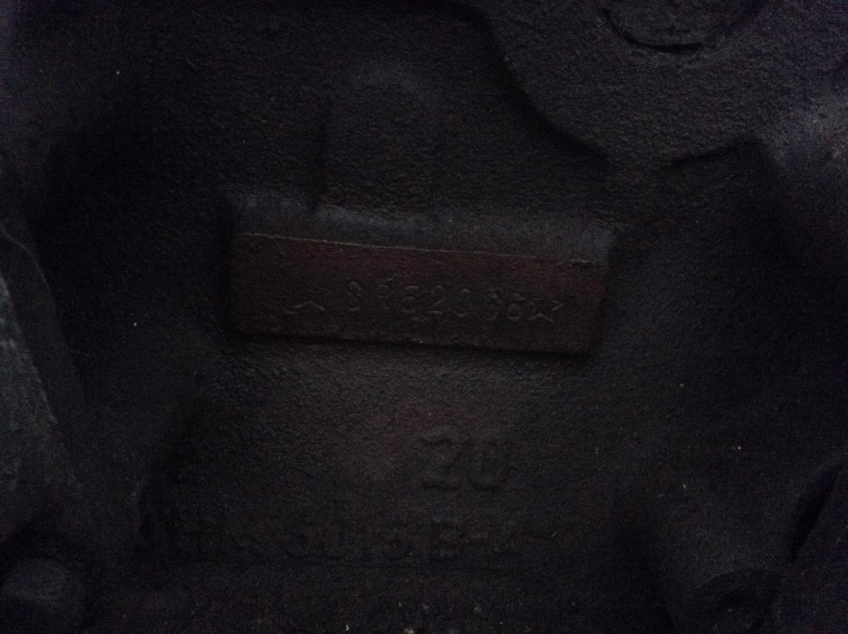

  11. Thanks just edited post as found these other numbers in the cast the 87 I saw was 81 but that's in big numbers the other is small
  12. Hi sorry for the delay it says m75 so does that mean 1975 ? And the head has 74hm6090ga in the cast under the cam .
  13. Can anyone please tell me if the number in the top of the head under the cam cover is the year please as this one says 87 if so might be an unleaded one thanks

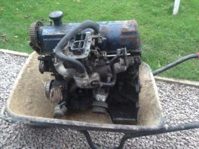

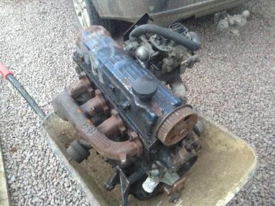

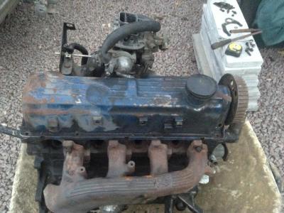

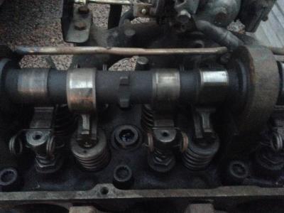

  14. Hi I've just bought this engine I've been told it's an rs2000 engine it's done 80000km about 60000miles I've had the head off it's got 42mm inlet valves 36mm outlet valves running a 32/36 DGAV and the bore measures 90mm across is this standard 110bhp as the rs spec is . I'm stripping it down and cleaning everything up plus repainting everything that's why I took the head off there is no lip on the top of the bore plus no play when try to wobble the piston from side to side . Hopefully a good buy . The cam is a ford h42 .
