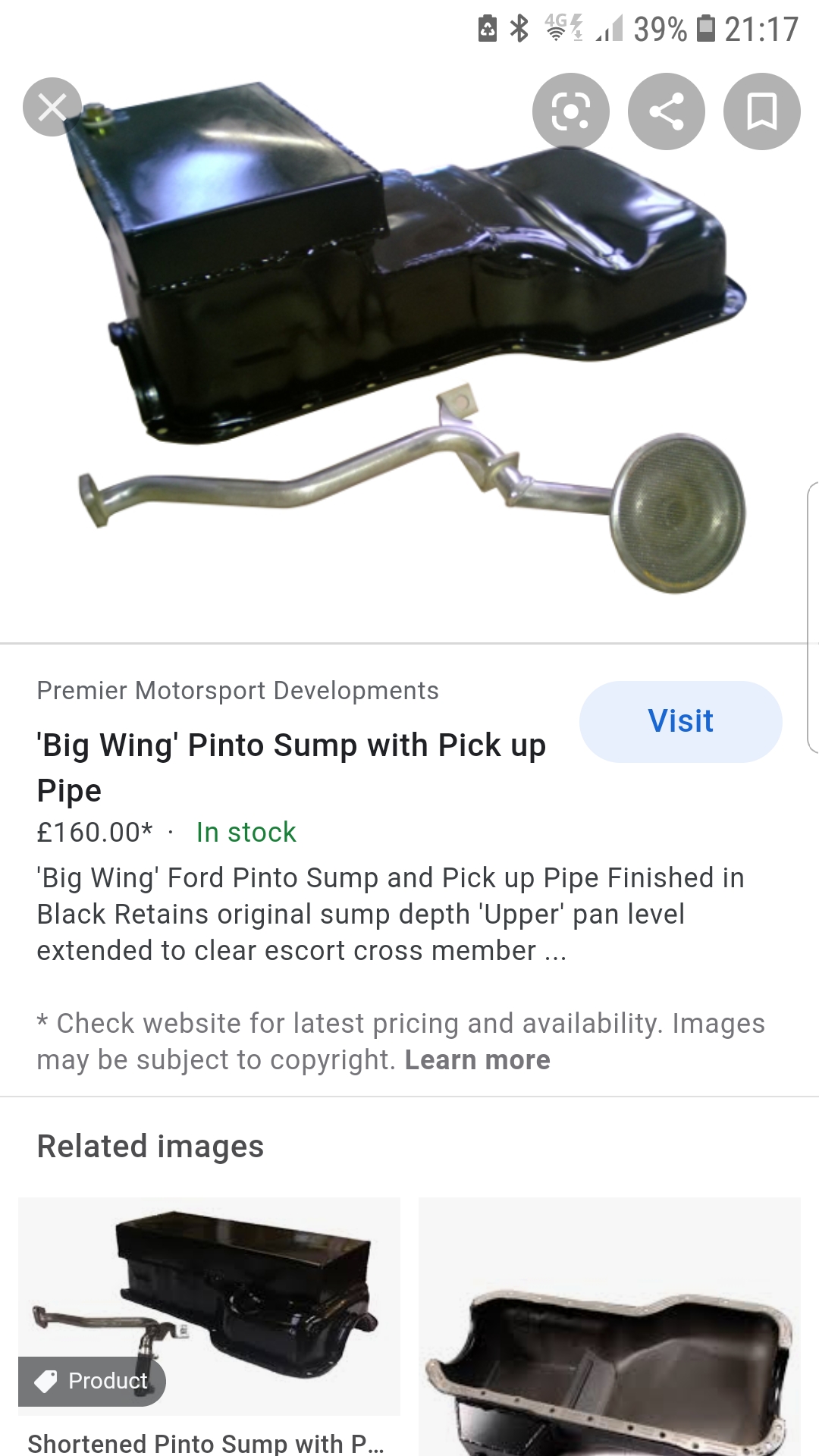

  7. Brand new from Burtons. It's going back otherwise. This is the Rs2000 Type ally sump and matching pick up pipe all brand new and still in packaging comes with sump and crankcase seals.

  13. 108 is with gps speedo. Probably would be higher with escort Speedo lol. The car is on 185 60 13 and sometimes it could do with a six gear to drop the revs when cruising.
  14. So a 2 litre capri laser can do 135 mph. I don't think so.
  15. The car was a 1600L automatic. So I think it's 3.54
