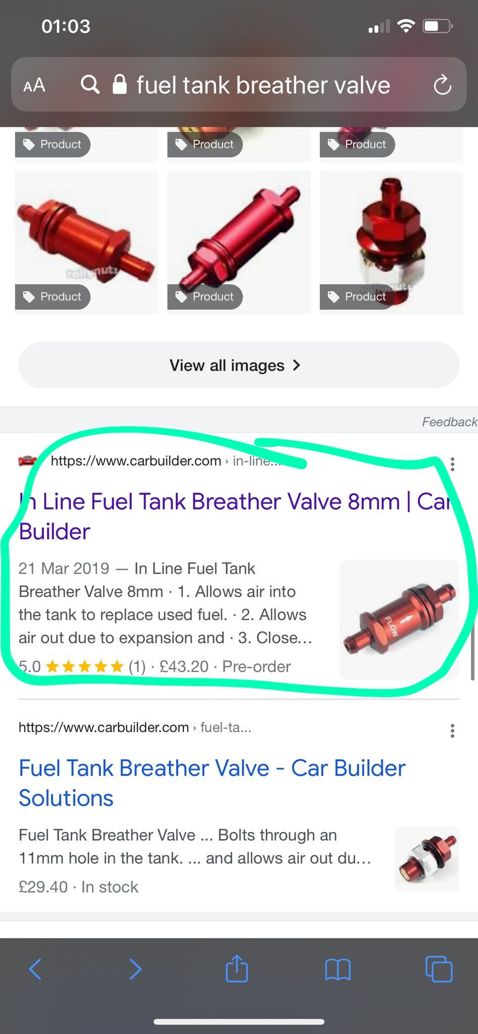

I have found a cheaper one 👌🏼 Ordered and can’t wait to sort it out! Panics me it being in storage away from me and a spark could set the whole place up with that open ended pipe jjst going inside the car, so glad to have came across this forum -

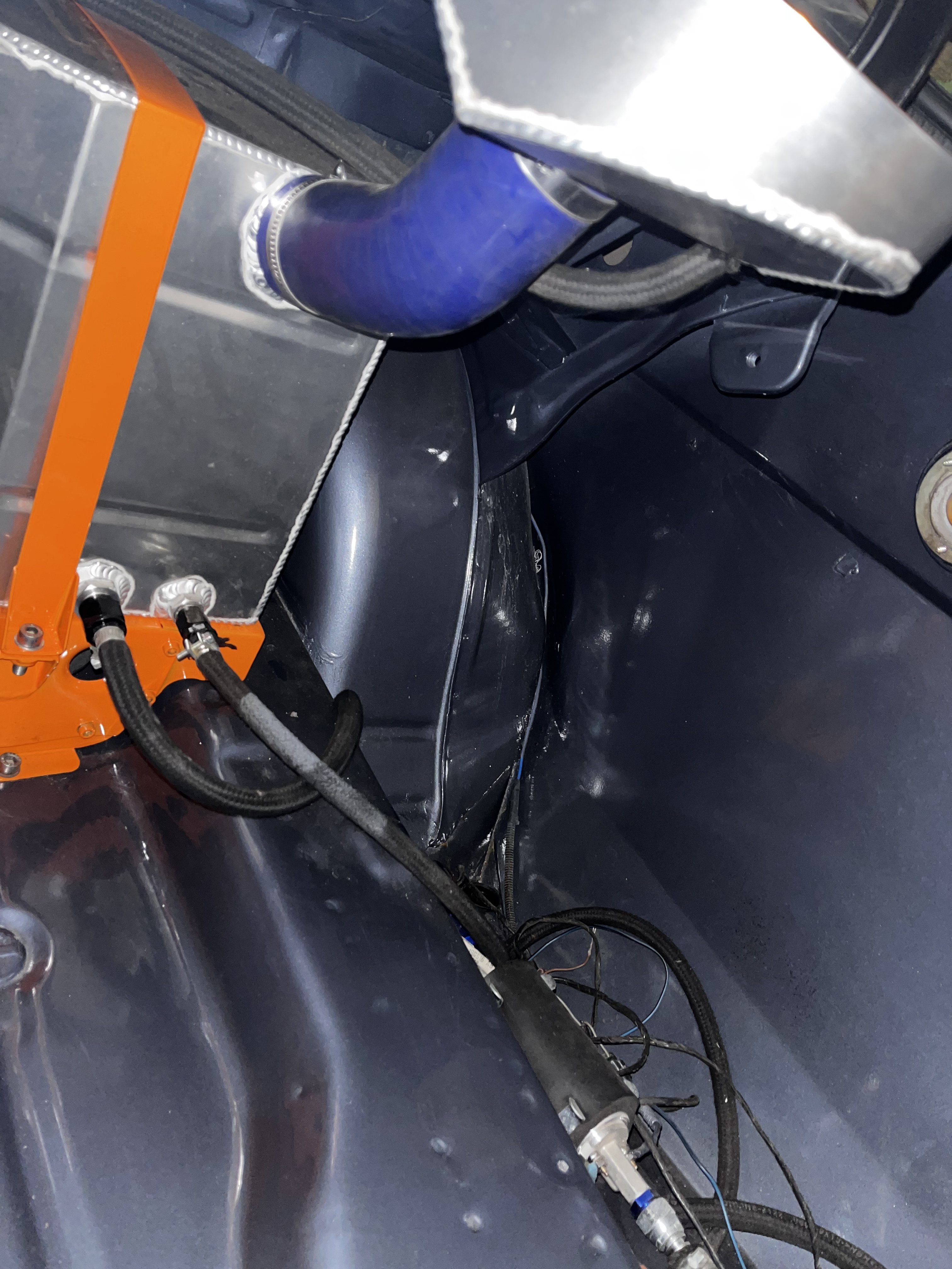

Thankyou so much for this mate you totally nailed it I’m now going to run the pipe that goes to the filler overspill directly out the car instead and leave the filler OS as I wont ever spill fuel there thanks again for putting me straight -

Nice one thanks for your pictures! I have been thinking though, what stops the fuel coming back up and spilling out with hard driving? cheers! -

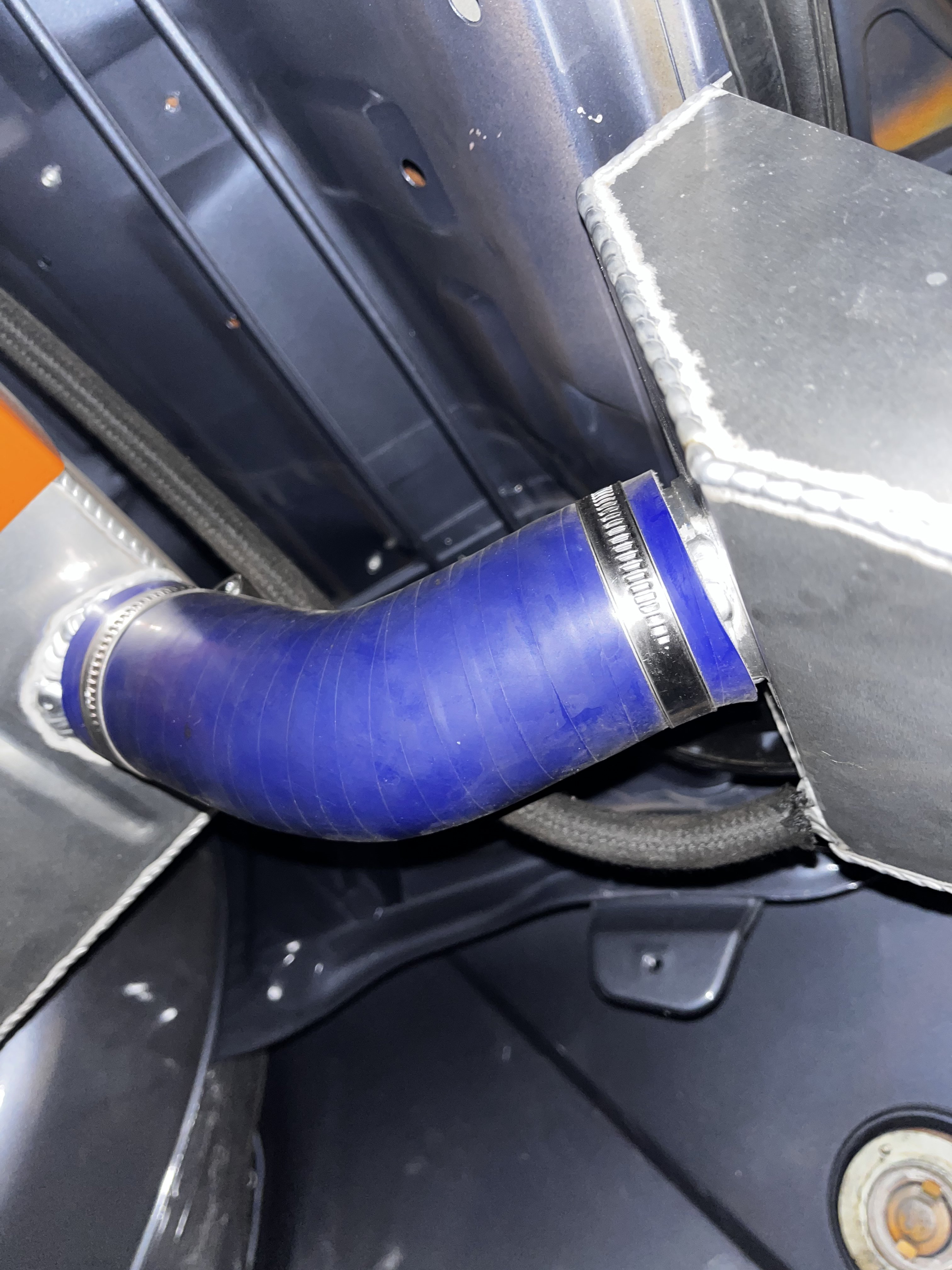

As I Went to fit new seats in the car this evening at the unit I looked at the pipe and it’s the blue one! So you think it’s that what is letting the smell out so much? There’s no leaks at all I checked what about the hosing to the pump? Is that ok you think thanks bud -
