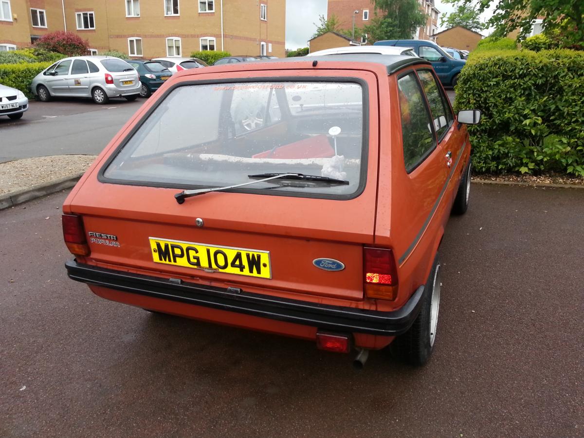

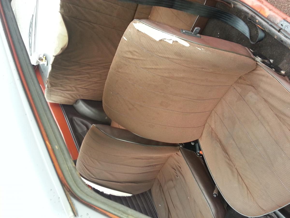

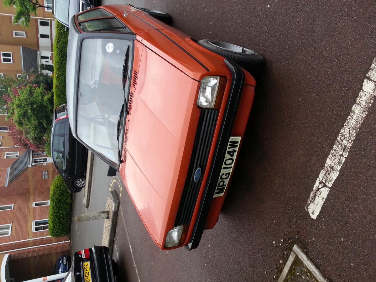

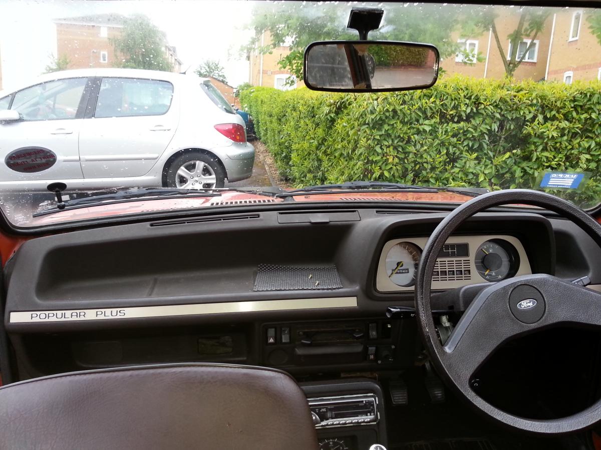

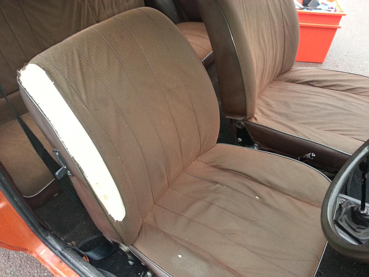

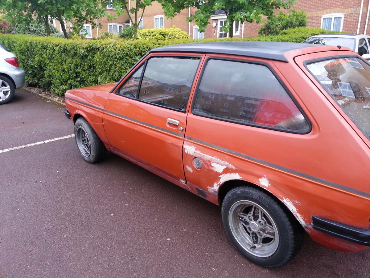

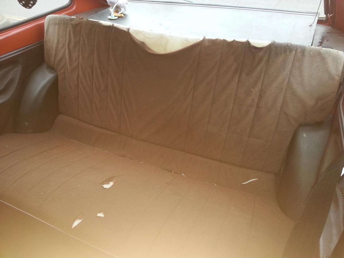

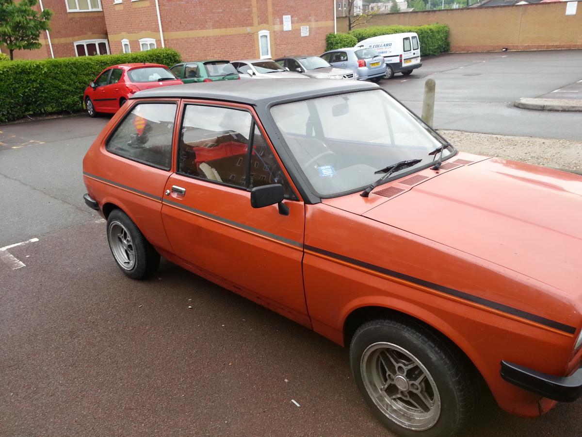

HI selling my gfs Mk1 Fiesta 950 popular plus. The car has just been through an MOT so has 11 months left, I have also just taxed it so has 5 months tax. The car runs and drives brilliantly and is quite economical. Only reason for sale is it was her first car and now wants something bigger! I have bought a Weber 32ICH carb which adds like 5bhp but is much more reliable and economical than Fords original, it is also the much sought after Italian Weber not the Spanish remake. Sale price is £950. Car is located in Aldershot, GU11 postcode. Viewing is recommended so you know what you're buying. I see this as a project car due to the below bad points, however wouldn't take much to bring back to its former pride and glory. Good Points: 11 months MOT 5 months Tax Runs and drives Weber 32ICH carb. (Italian) Completely original car, no aftermarket parts added, except carb Fiesta Supersport wheels Bad Points: Small amount of rust around the car, in numerous places Dent in drivers door (I imagine it could be removed easily enough with the right tools. Dent fixed in Passenger side rear quarter. I have repaired this, however I didnt paint over as going back to original colour will be much brighter than the origianl paintwork and IMO would look odd. Overall I would say the car needs a respray. If it was up to me I would Satin black the whole car. Interior is heavily ripped and would need reupholstering or replacing. Still comfy though. Pictures This is the dent that I have repaired and filled. It isn't as bad as it looks!!
