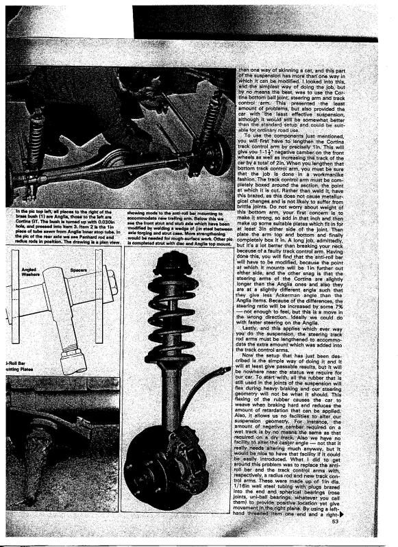

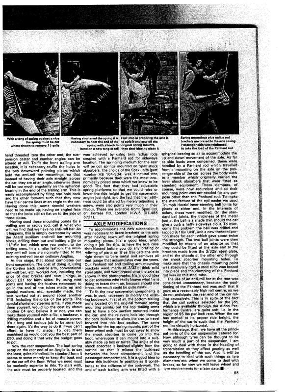

Anglia68 Posted April 28, 2010 Report Posted April 28, 2010 These are scans of a photocopies so not brilliant but better than nothing. They are all about the suspension that David Vizard designed and made for it. I've never seen a pic of the car itself but it had flush fitting plastic windows and a typical 70's paint job apparently.

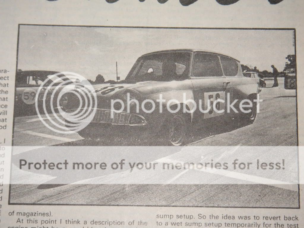

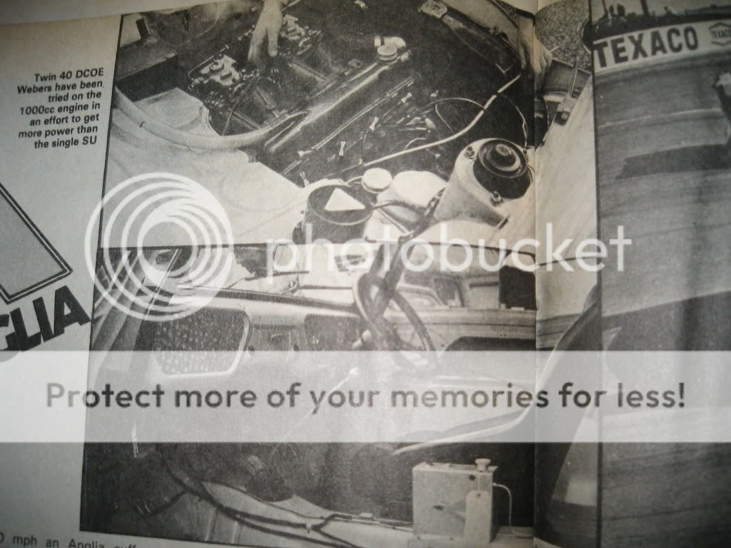

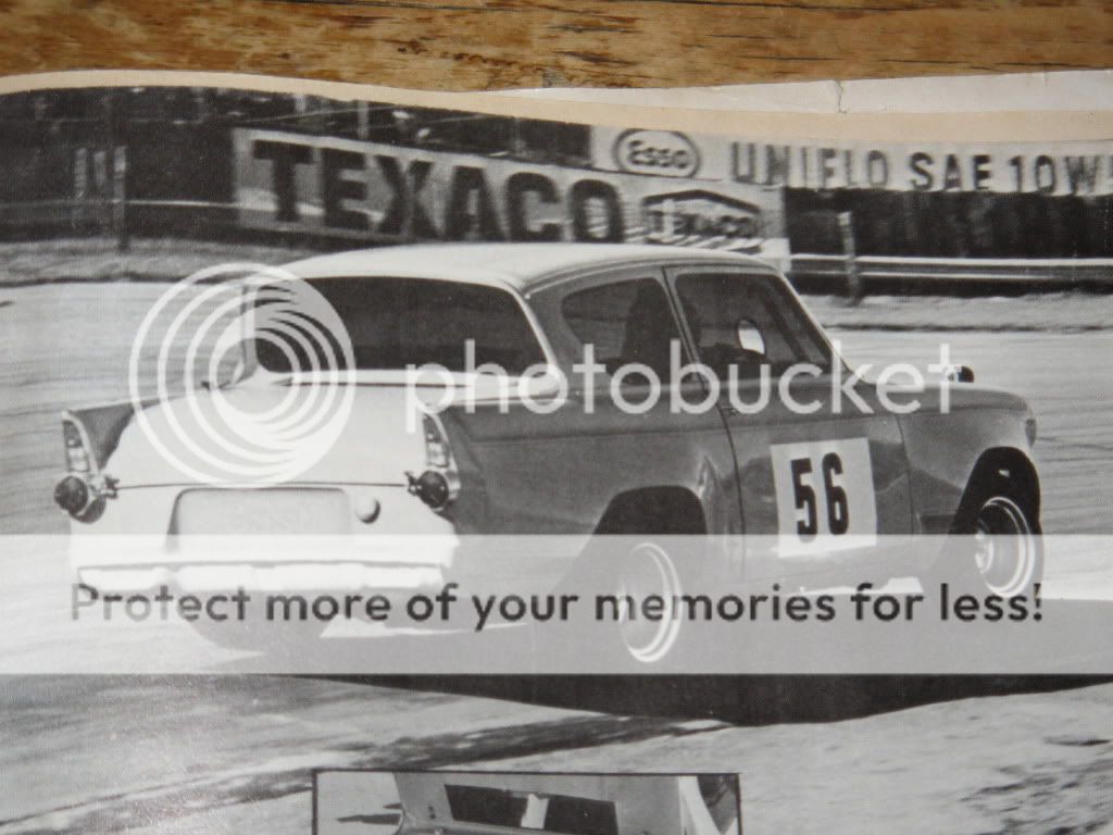

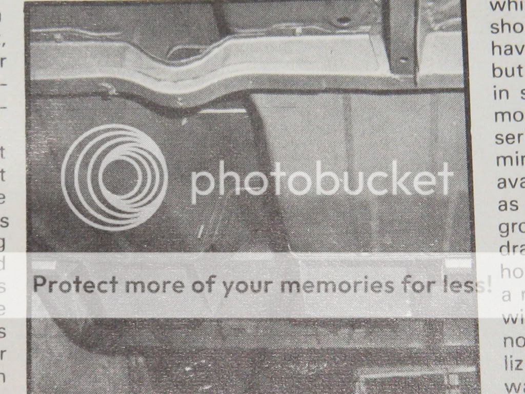

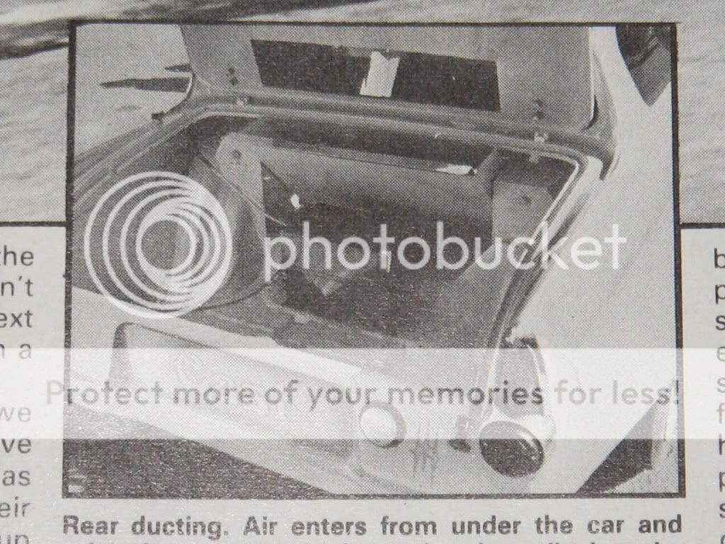

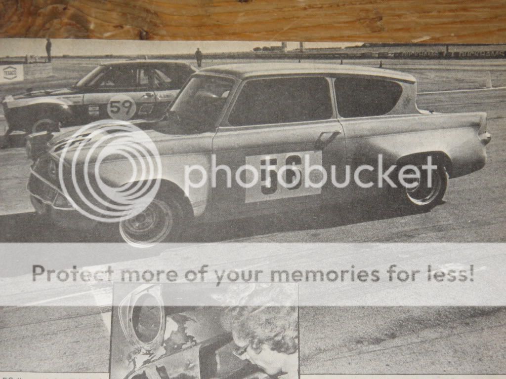

joe1600 Posted April 29, 2010 Author Report Posted April 29, 2010 Here are some pics of the car. Quiet impressive I think you will agree. For the time the car had some ground breaking features such as a rudimentary diffuser, the air passing under the car was pulled through vents in the boot floor and then out through the boot lid, this was done to equalize air pressure and to allow the car to corner faster
