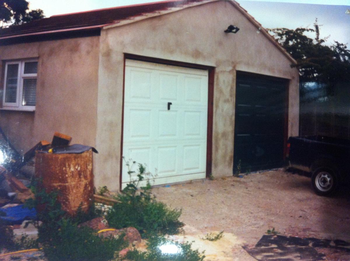

Savvi Posted April 22, 2013 Report Posted April 22, 2013 I built a double garage out of double width thermo blocks rendered inside and out with a tiles roof about 15 years ago, cost me just over £5k ............... think id be looking at more 315-20k now 1
