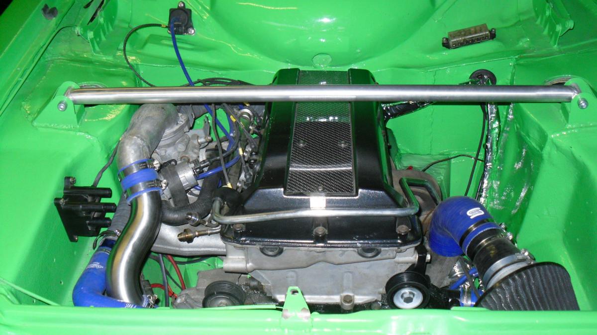

BigBubba Posted October 30, 2013 Report Posted October 30, 2013 I know this is really odd to say but ive always thought a 940 2.3 4 cylinder red block volvo turbo engine would go well in a rwd old ford and you can easily get 250hp with no trouble and would be very cheap to do and the engines are bullit proof. it would be cossie power for alot less money and its a stronger engine aswell That's the point I was making regards to it being overpriced. You can pick up comparable, better engineered engines from other manufactures for buttons in comparison to a YB. There's no denying they're great engines, but to get a 2nd hand YB bought, rebuilt, and upgraded to over 300hp you're looking at a couple of grand minimum. I went a different route, and fitted a Saab B204! Standard internals good for 400hp. No cams,crank, rods, pistons or headwork. All it needs is more air and fuel to achieve that. 2
D-FENS Posted November 3, 2013 Report Posted November 3, 2013 That's the point I was making regards to it being overpriced. You can pick up comparable, better engineered engines from other manufactures for buttons in comparison to a YB. There's no denying they're great engines, but to get a 2nd hand YB bought, rebuilt, and upgraded to over 300hp you're looking at a couple of grand minimum. I went a different route, and fitted a Saab B204! Standard internals good for 400hp. No cams,crank, rods, pistons or headwork. All it needs is more air and fuel to achieve that. RS B204.jpg What Saab models is that engine fitted in .What sort of money would you pay for this engine .Lastly whats involved in fitting it .

BigBubba Posted November 6, 2013 Report Posted November 6, 2013 It's not been easy! I've had to fabricate loads of stuff, custom x member, mounts, bellhousing, sump, intake, exhaust, clutch, oil system, cooling system etc. Just got a few coolant pipes to fit and plug leads to make, then it's off to get mapped. Looking at 300hp and over 400 ft/lb of torque. The RS is totally stripped out with Lexan windows, so should be nippy enough!!!! Oh, it's from a 1999 Saab 9-3 turbo, bought the engine complete and delivered for £250, all she needed was new shells. Admittedly, the whole project has probably cost me more than a straight forward cossie transplant, but I have something original, and should i need more power, I just wind up the boost and tweak the map. happy days! Have a look on some of the Saab forums and see some of the crazy power these guys are making, unbelievable stuff. 1
D-FENS Posted November 8, 2013 Report Posted November 8, 2013 I take my hat off to you Bubba thinking outside the box is good .
BigBubba Posted November 8, 2013 Report Posted November 8, 2013 Thanks D Fens, just wanted to do something different. It's getting a trick back axle too, should be a great alternative to the old (and expensive) Atlas. Getting a mag feature sometime next year, and i'm really looking forward to seeing it on the cover. makes it all worthwhile, knowing some people can appreciate the work i've put into it.
