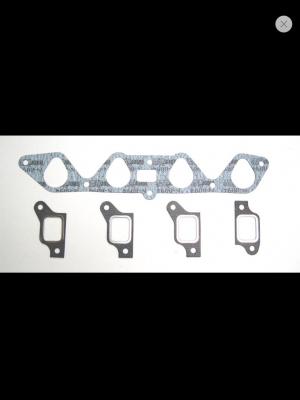

For a mk1
2l pinto
And a 4 2 1 Ashley branch manifold which needs a new gasket the two types I see on eBay just done look correct form what I can see. Anyone any to help? Tired look online
Thanks all
The inlet manifold gasket on the left is for a carb equipped engine, the one on the right, injection. Check what shape the inlet ports on your head are. Exhaust manifold gasket should be the same for both.
