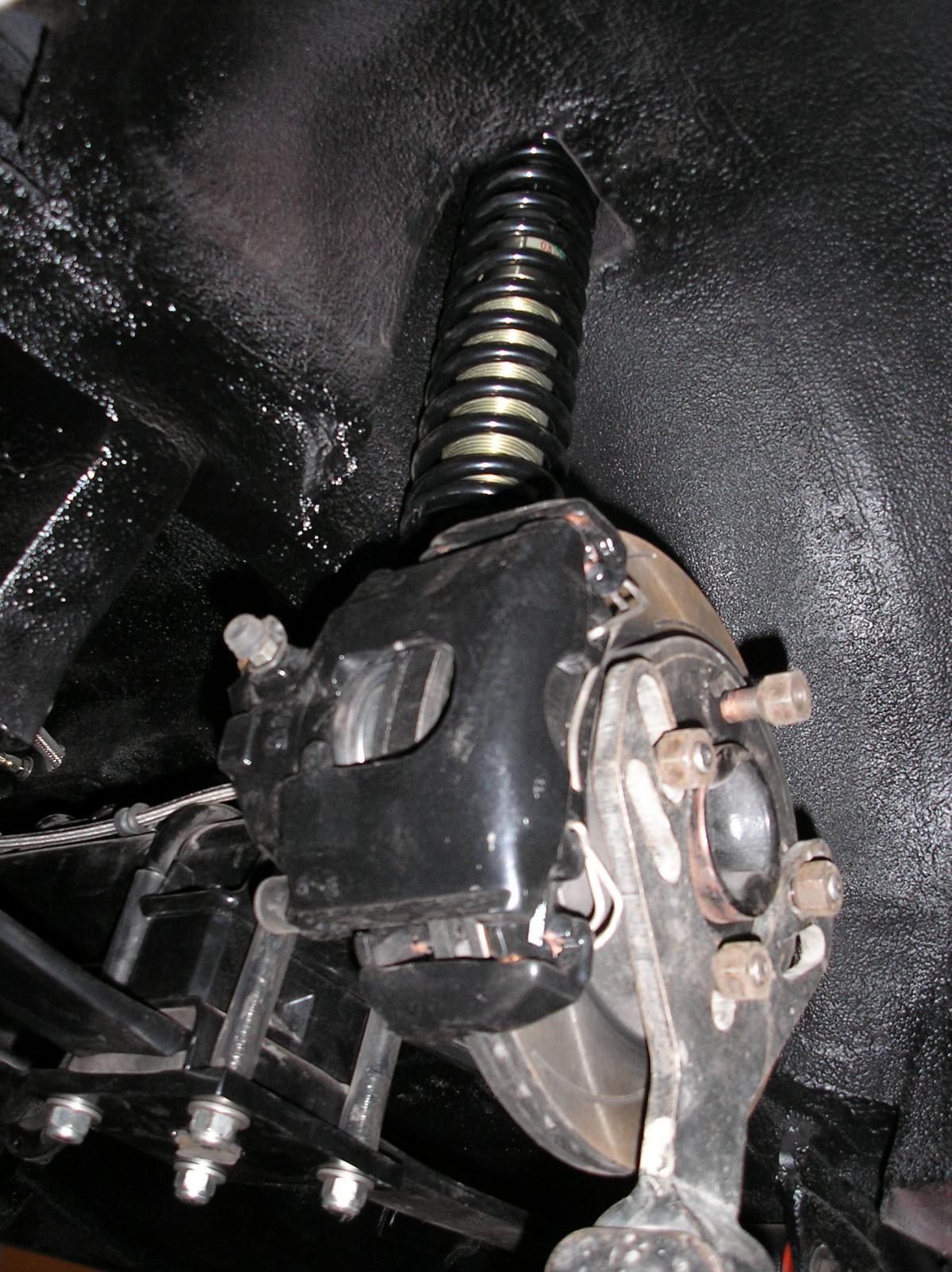

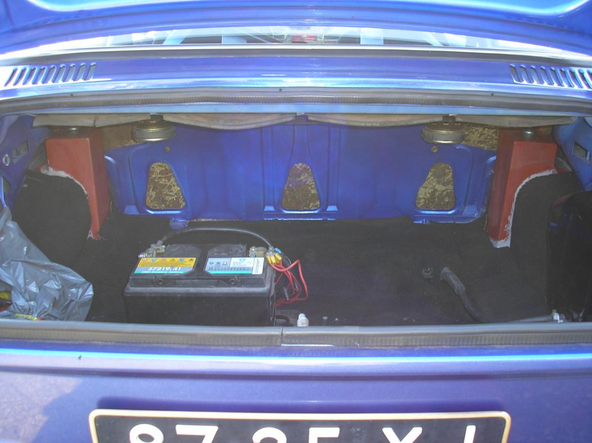

John escort mk1V6 Posted November 18, 2014 Report Posted November 18, 2014 And they are lighter than the multi leaf and looks better , less rusty. But you mean by decamberd , make them flat or straight ? If this is the case then the springs have no strengh more , so the hole spring working/motion is gone , and that drive`s badly. It will break out at the rear on bumps in corners. I have something like it but than with leafsprings that are from poor quality and alomost flat , but i want coil-overs on it so it has a spring working/movement on the coil-over springs and the leaf springs only have sepention job. With lowering blocks 2,5inch and than set the car on the nice hight ride with the coil-overs. I did have it all together , but i then saw that the turrrets were to short for the GAZ coil-over that i had and now i am going to buy the short/normal length coil-over for a escort mk2. 1
seaneylad Posted November 18, 2014 Author Report Posted November 18, 2014 And they are lighter than the multi leaf and looks better , less rusty. But you mean by decamberd , make them flat or straight ? If this is the case then the springs have no strengh more , so the hole spring working/motion is gone , and that drive`s badly. It will break out at the rear on bumps in corners. I have something like it but than with leafsprings that are from poor quality and alomost flat , but i want coil-overs on it so it has a spring working/movement on the coil-over springs and the leaf springs only have sepention job. With lowering blocks 2,5inch and than set the car on the nice hight ride with the coil-overs. I did have it all together , but i then saw that the turrrets were to short for the GAZ coil-over that i had and now i am going to buy the short/normal length coil-over for a escort mk2. estate coilover (16).JPG I currently have multi springs with 2inch lowering blocks, wouldnt mind it lower at the back but dont want to loose my back seats with turret and coils overs. So was advised to get them de cambered (like you sat make them flat) it will lower the back and it should handle abit better? Would i best to just stick single leafs 146lb and then add the lowering blocks to get it lower and not try to go to low? rather than decambering them Cheers
John escort mk1V6 Posted November 18, 2014 Report Posted November 18, 2014 You can try it , if it gives problems you can put the short turrets in it , but it is something of a big job in a small boot. I have them also in mijn mk1 but it was not simple , becourse they don`t fit perfect against the standard tube`s and i want to set them more straight up due welding and i didn`t take anough time for it , they stand bit on a angle and with the bracket upbove the axle not on the side.
