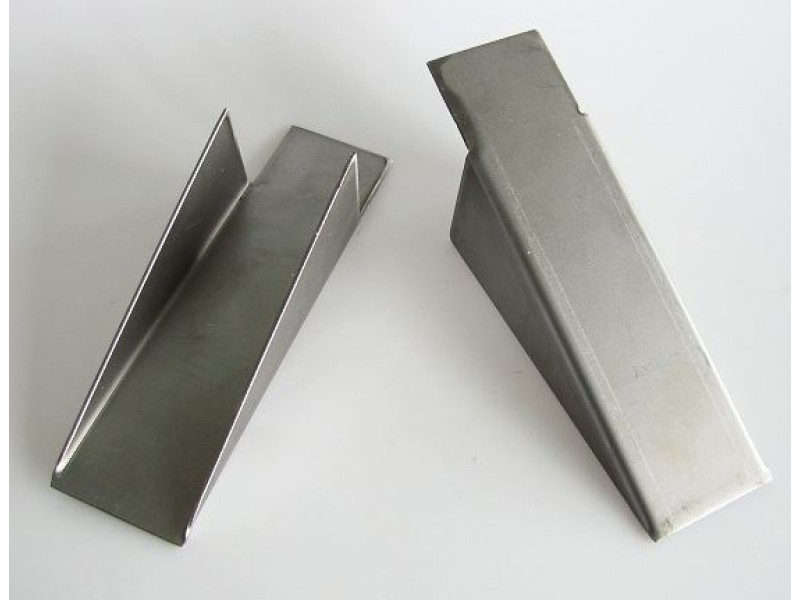

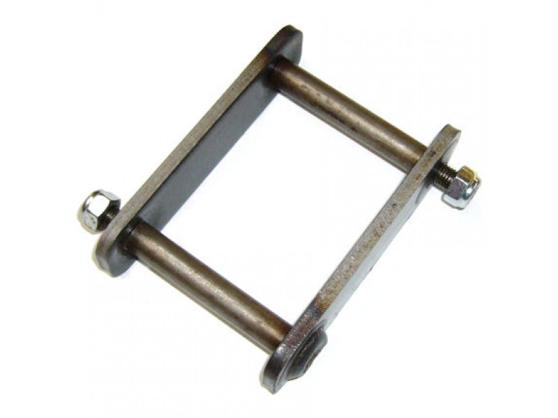

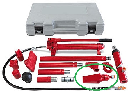

John escort mk1V6 Posted April 13, 2015 Report Posted April 13, 2015 What i have done to fit the 60mm leafsprings is at the frontside cut out a thin piece of metal and the pushed out the ears with bodyshop tool. And under tention i did use a hammer to make the ears/leaf mountings straight. Also i weld it here and the and also i filled up the gap between the chassis rail and ears/leaf mounthing section with skid plate`s. You also can remove the ears/leaf mountings and fit them from a mk2. And i fited the stronger straight hangers with poly bushes.
