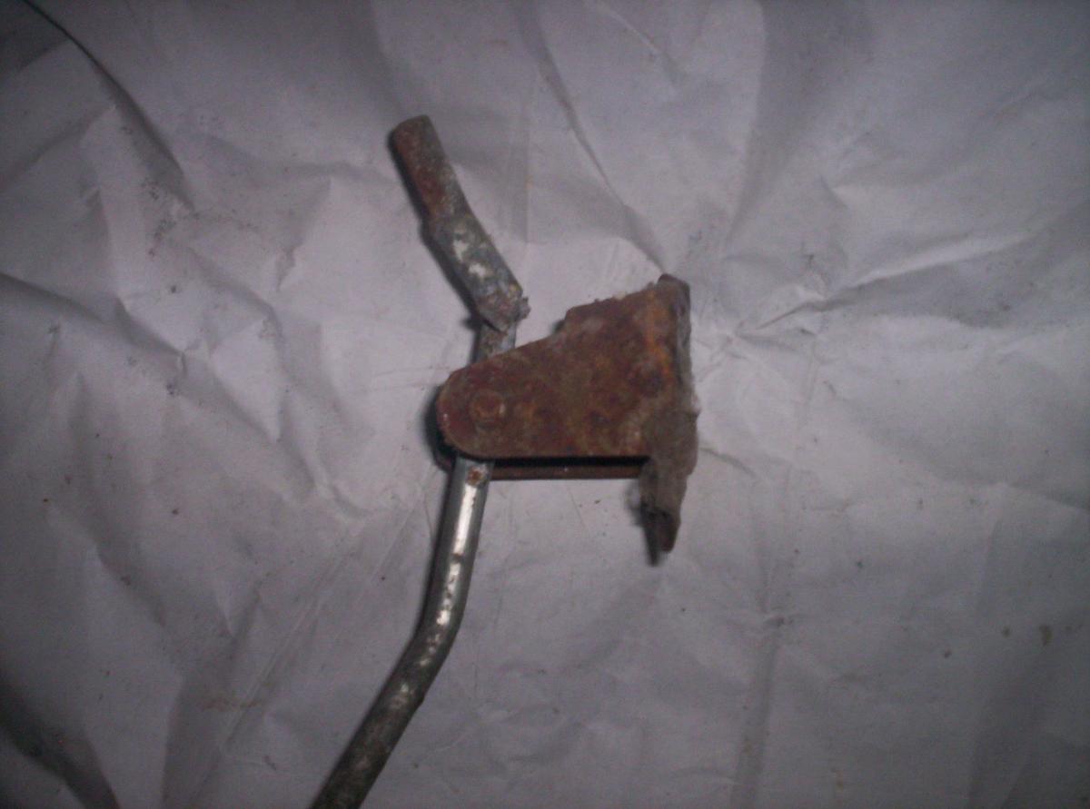

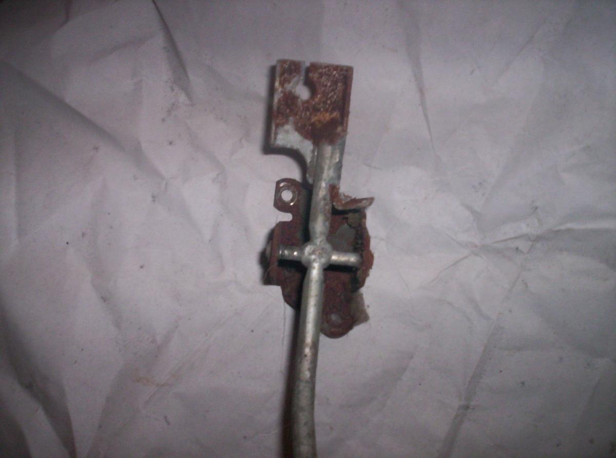

Anyone ever done this?
Car is a cortina mk2, 1600 xflow.
I have installed a new engine and carb, the original carb was a Weber 32 dfm the new carb I think is from a 2L pinto.
The linkages work in opposite ways.
Any help would be really appreciated.
you need a pedal from a lotus cortina
Would antisipate a bit hard to find and if you do mega bucks. Could a pedal off Granada / Sierra be used as they come withe their own mount ?
lol ive got some!!!!!!!

I just welded the top of an escort one to my mk 1 tina pedal and a small bracing bar across the pedal .
Think I used a sierra cable on the twin choke .
