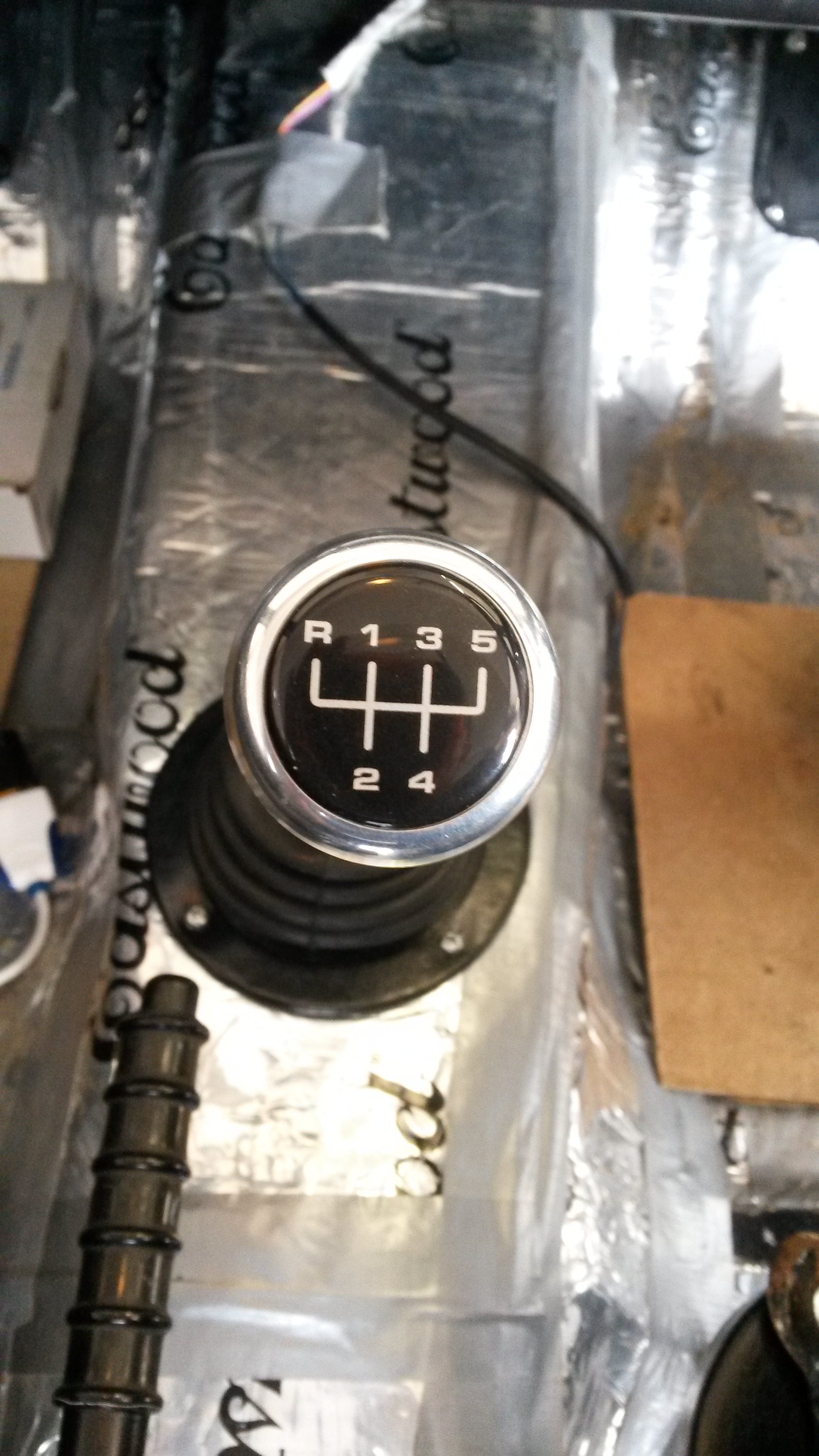

Kenbex522 Posted July 21, 2018 Report Posted July 21, 2018 Pic of my T9 in a Corsair but same floor plan as your Mk1. But it does come down to where the engine is bolted in ie custom or standard install. Mine is bolted to a Zetec, but essentially the tail end of the box is in the same place as the original 1500 box. The type 9 is more or less the same length as the original box anyway.

Kenbex522 Posted July 21, 2018 Report Posted July 21, 2018 3 hours ago, gibbo90-9 said: Thanks but you’re talking Zetec and type 9 and thats different. There must be someone out there that’s fitted a 2000e box in a Mk 1 (Non GT) Cortina? Just told you the gearboxes are the same length. So it dont make any difference.
