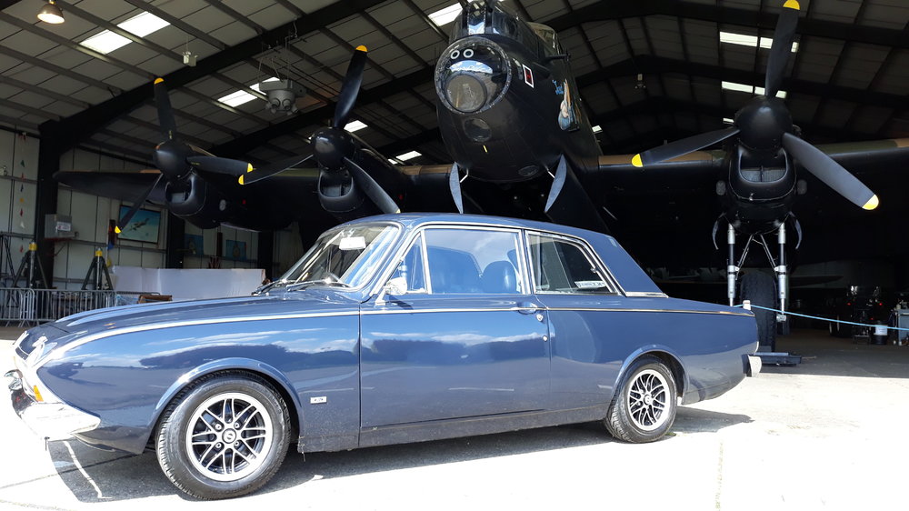

  4. This my corsair by the way. Join the f a c e b o o k Corsair enthusiast group, you strike lucky if someone is breaking a corsair.

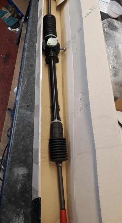

  7. Retroford Escort steering rack 2.9 ratio metric threads. Fitted and used for just 200 miles. Changed to different ratio now hence sale. £130 collect from Spalding PE12.
