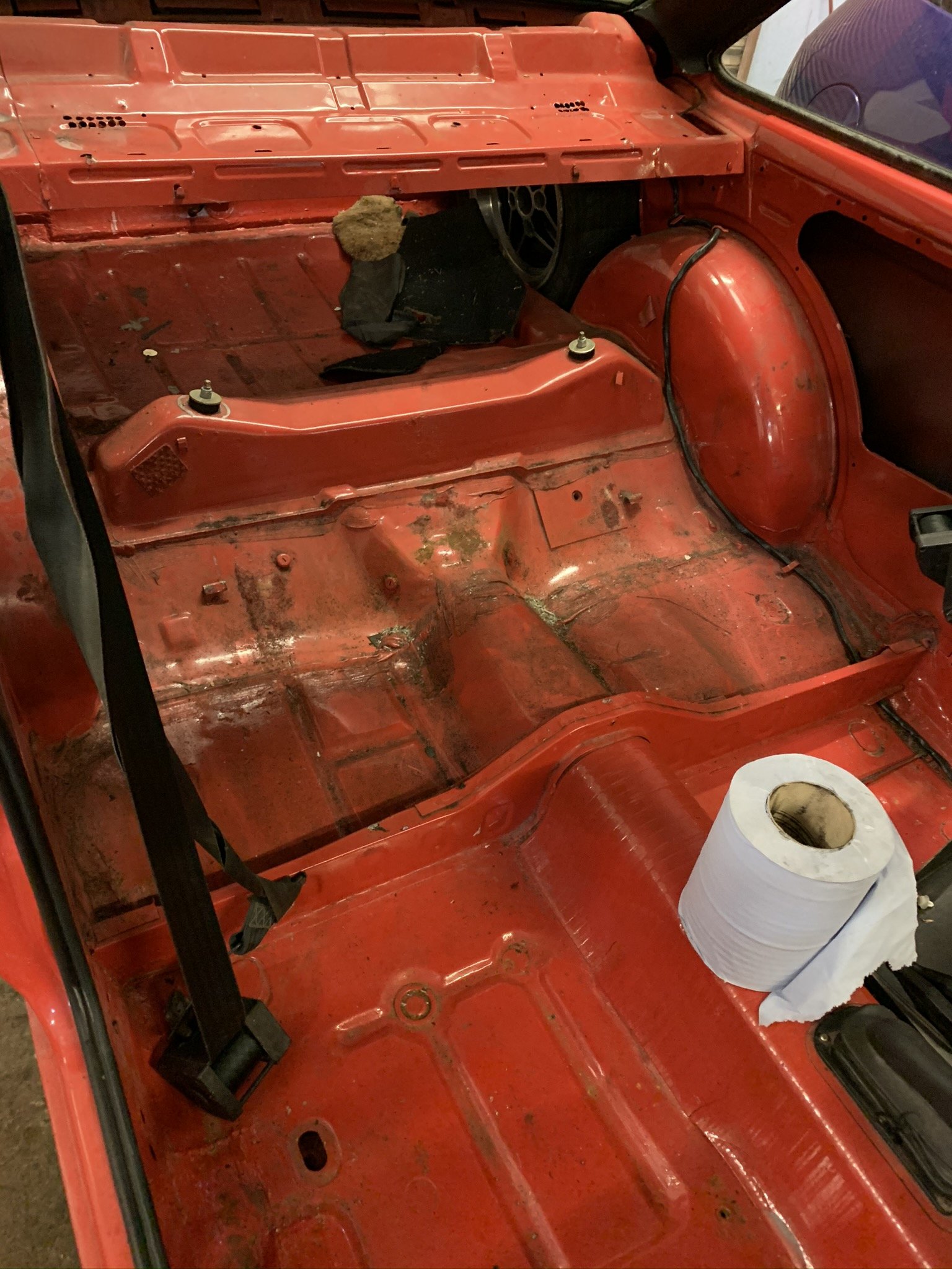

notenoughtime Posted December 31, 2019 Author Report Posted December 31, 2019 50 minutes ago, Rally Pack 2000 said: Cars for sale is supposed to be the least used section of the forum. We can buy more once we have sold them! 1

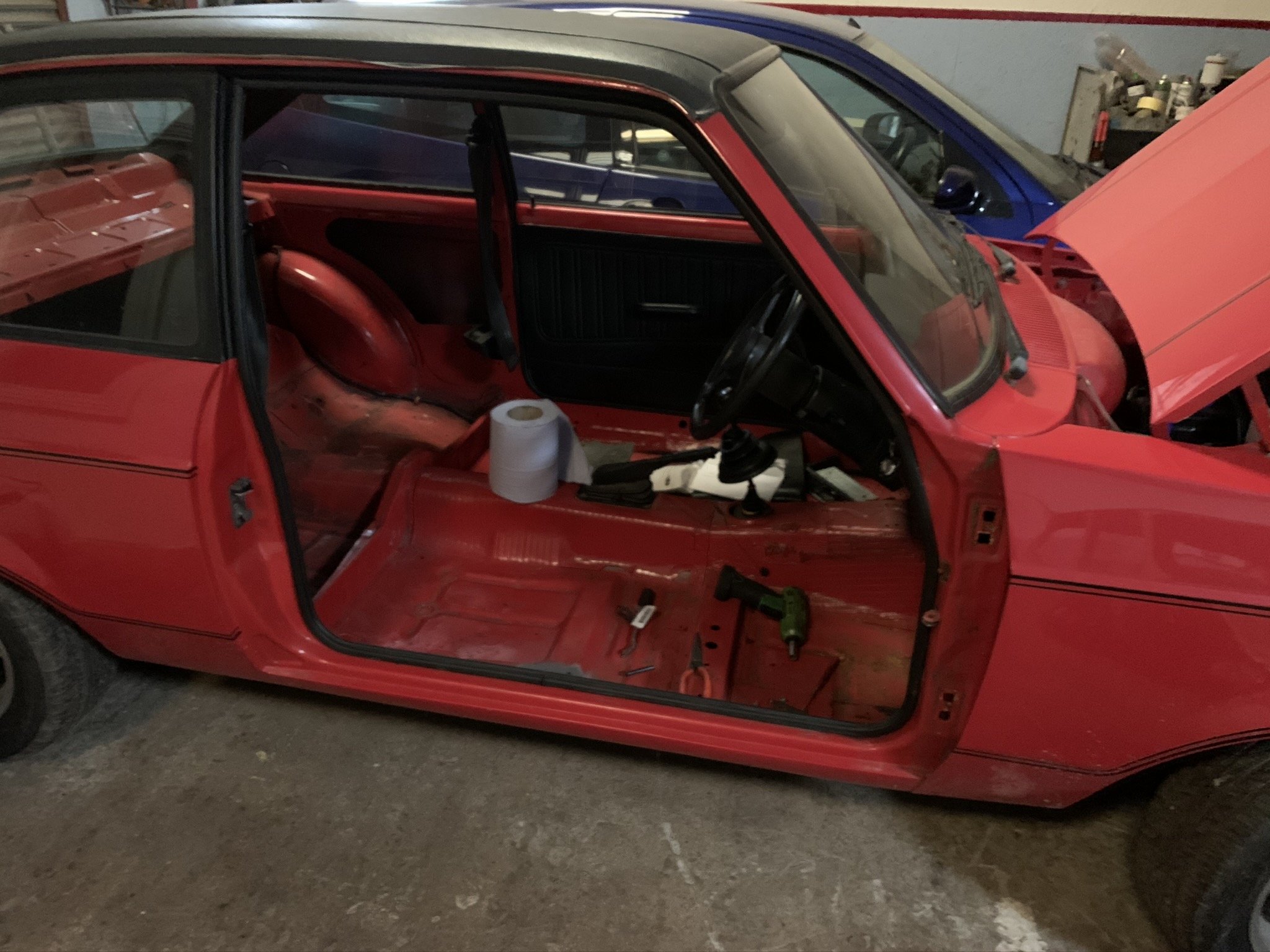

DT36 Posted December 31, 2019 Report Posted December 31, 2019 2 hours ago, notenoughtime said: i removed the rear seat, parcel shelf and rear door cards and will give the metal work a wipe over once I’ve sorted the patch in the floor How easy did the rear shelf lift off? Was planning on renewing mine last year or at least having it covered in vinyl, but having re-fitted all my seats I didn't get round to it. GS Escorts have got some decent back shelves, so might ring them next week, as I need to take my front seats out to lower them a touch. Will probably have to fab some new rail mounts to the floor and get them powder coated.
notenoughtime Posted December 31, 2019 Author Report Posted December 31, 2019 1 hour ago, dt36 said: How easy did the rear shelf lift off? Was planning on renewing mine last year or at least having it covered in vinyl, but having re-fitted all my seats I didn't get round to it. GS Escorts have got some decent back shelves, so might ring them next week, as I need to take my front seats out to lower them a touch. Will probably have to fab some new rail mounts to the floor and get them powder coated. Slid out once I’d removed the rear seat which is only two nuts to remove! I ordered a material type rear shelf not fibreglass one, good reviews but will wait and see what it’s like, and was half the price of the fibreglass ones 1

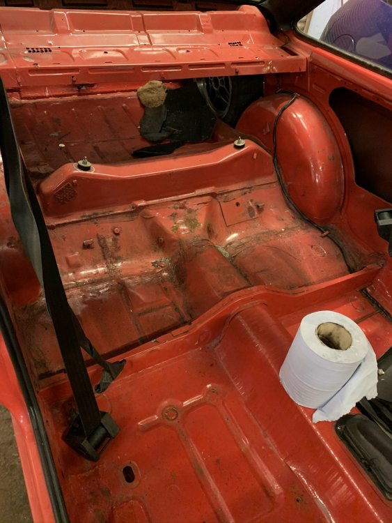

notenoughtime Posted January 1, 2020 Author Report Posted January 1, 2020 Pic of under the drivers seat interior removed 1

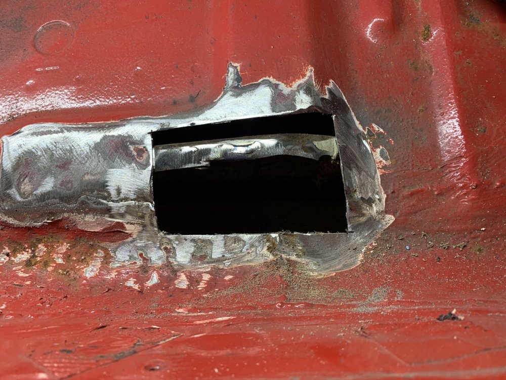

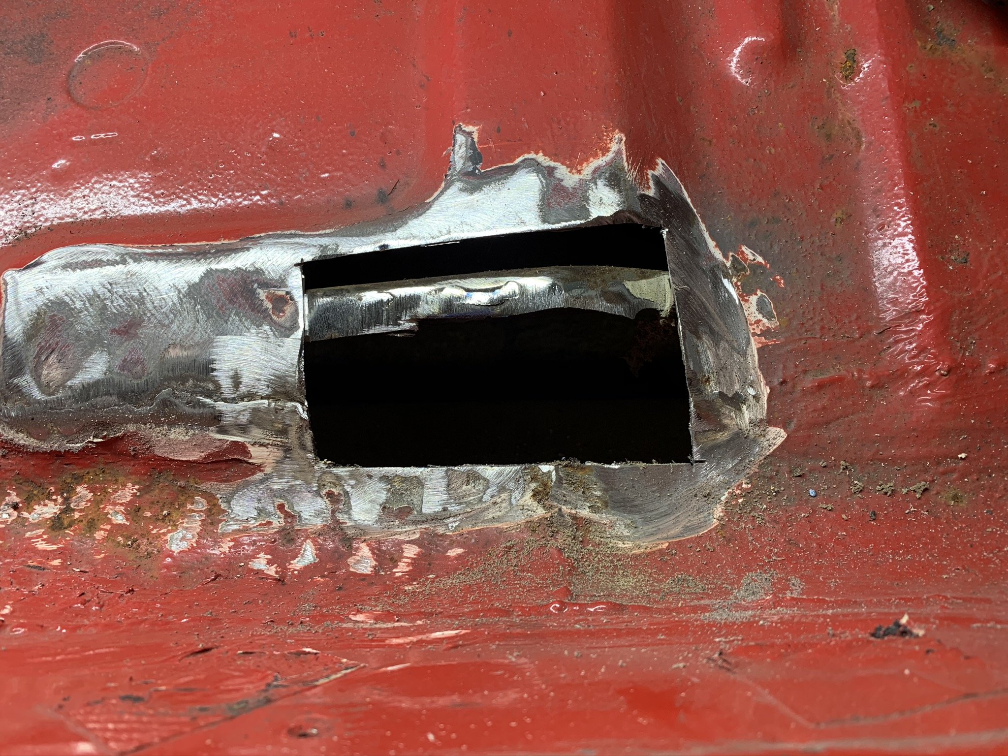

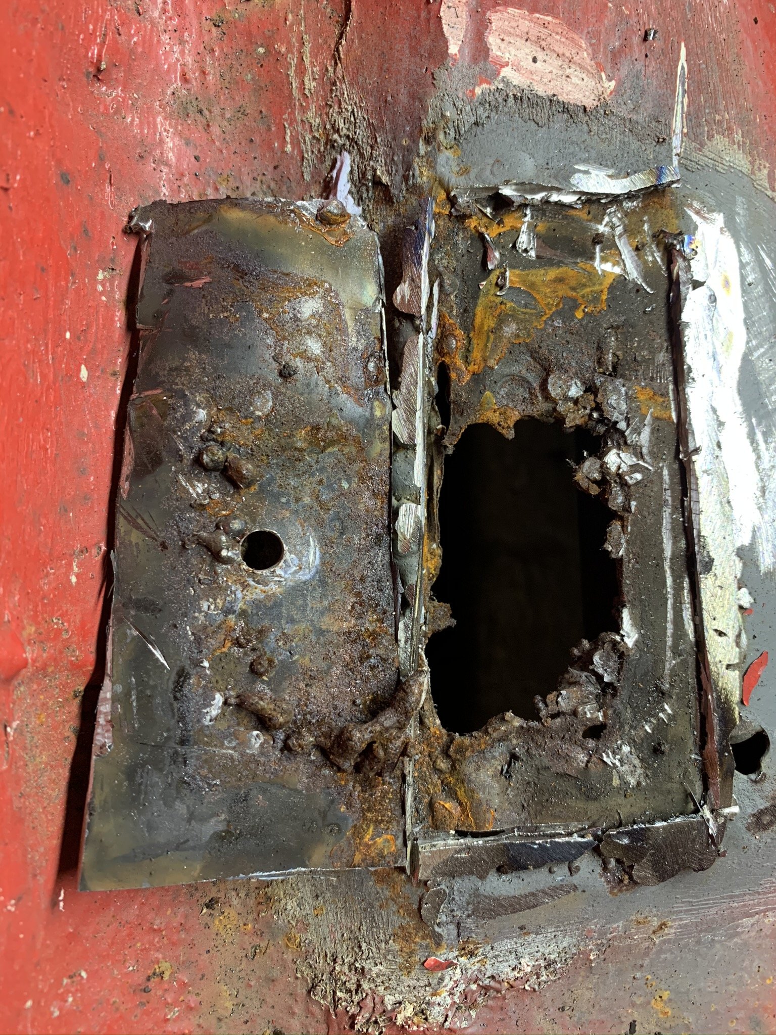

notenoughtime Posted January 2, 2020 Author Report Posted January 2, 2020 Cut the crap repair out cleaned around the repair, made a repair section and drilled holes to weld onto chassis rail 2
