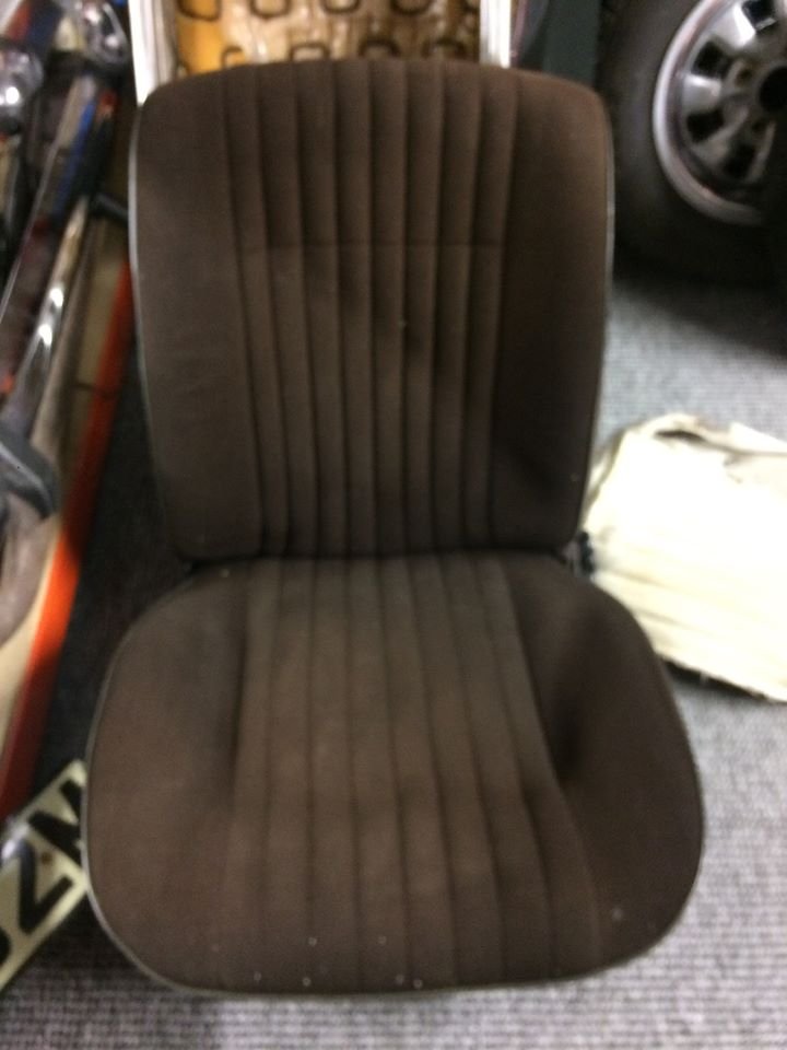

There was something about the Beta cloth used on Australian Scheel Seats that was so flimsy that RS2000 seats barely got out of warranty before it wore through. I remember back in the day looking at 5 to 10 yo RS2000s and the seats were in terrible condition. While many think all our Scheels seats were covered with Beta Cloth there are examples that indicate Ford Australia got sick of the beta cloth and dabbled with other better wearing materials. A recent thread by Yellow Tax shows one of those examples which are still on the side bolsters of mine as well. I have never done a side by side comparison with the Beta Cloth on a European RS2000 and an Australian one but it has been said that the European versions are made of better materials. But it never made sense why you would produced a run of inferior cloth just for Australia. I have a theory that original beta cloth is actually very heat and UV sensitive and the sponge lining breaks down incredibly easily under these conditions giving the impression that wear is good in UK cars but seem to have an inferior version on Australia cars. Its quite possible this new Aldridge stuff doesn't suffer like the original stuff did which is good.
So Im not sure which way to go at the moment, weather to try replicate the unique material that is still on my side bolsters and cover the whole of the centres to have a set that looks like Yellow Taxis or switch to the traditional beta cloth look.
If Ford Australia was sourcing steel for panels locally, i'd imagine they would do similar for their plastics, electrics and interiors also ? So its a possibility the cloth / seat foam was not to same spec hence the poor performance bearing in mind the climatic conditions your cars are subject to - ours just get wet not baked or subject to the extreme UV like yours. Unless anyone has actually tried the Aldridge cloth in Aus - it may actually degrade just the same?

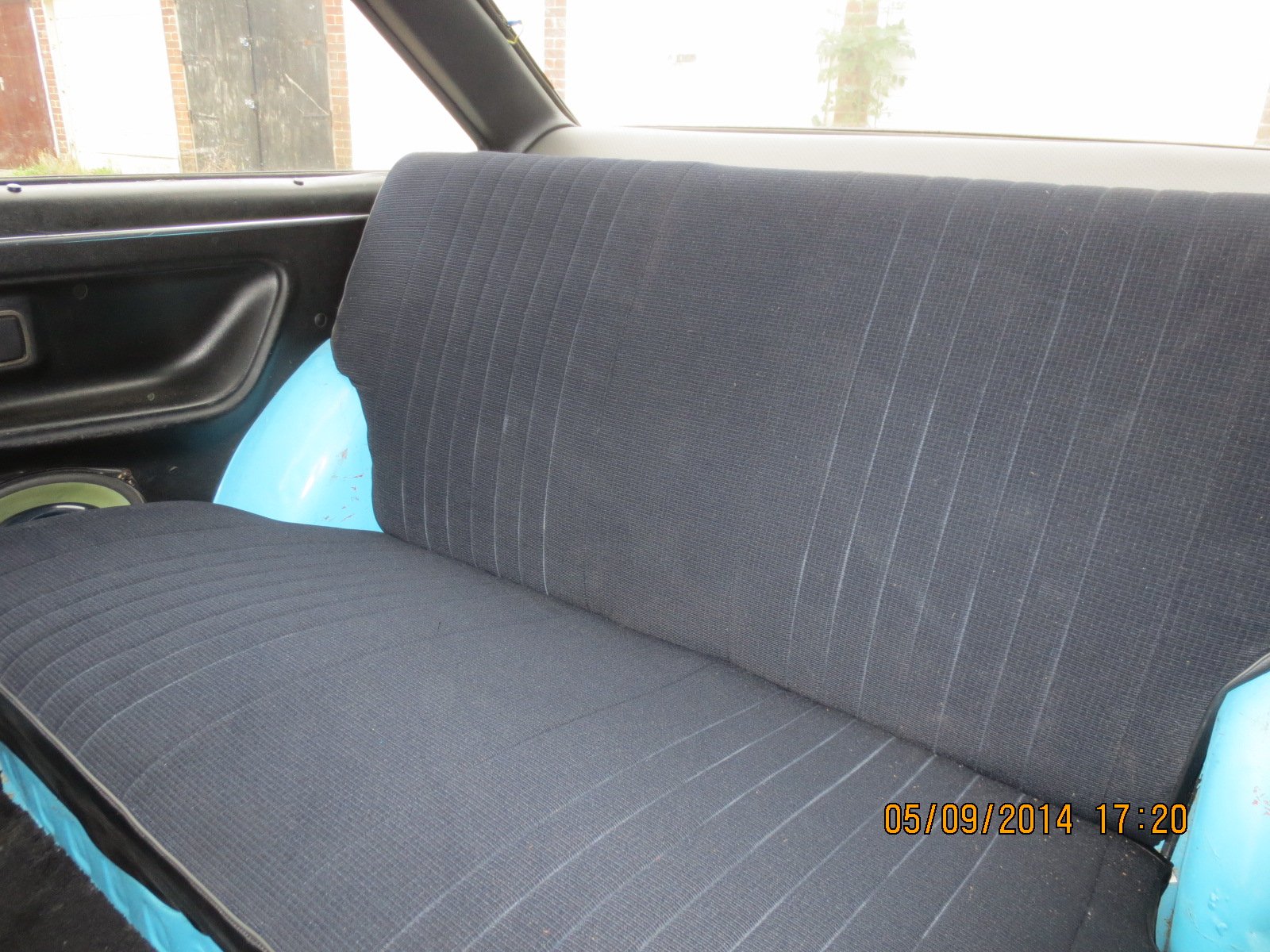

The original Beta cloth rear seats that came with my car were in poor shape, rips, tears and badly faded to a shade of dark grey, so I happened on a set of recovered seats and although good enough for my needs, they are a very dark blue / black compared to the '78 originals which were a definite black back in '82 when I had my first car. Pattern and weave style i'd say was pretty good but for a concourse car I think you'd get marked down!
The car came with rally bucket seats in the front but these are not great in a road car so I sourced some grey clothed 'Recaro's' with net headrests, although not marked so I think from either an RS1600i or late model Cortina? These I was going to retrim with Aldridge covers which would match the rears but I baulked at the cost of the covers + a trimmers labour, so i'm holding off on that presently - got far more important things to do first like functional electrics and running engine! But never say never!
