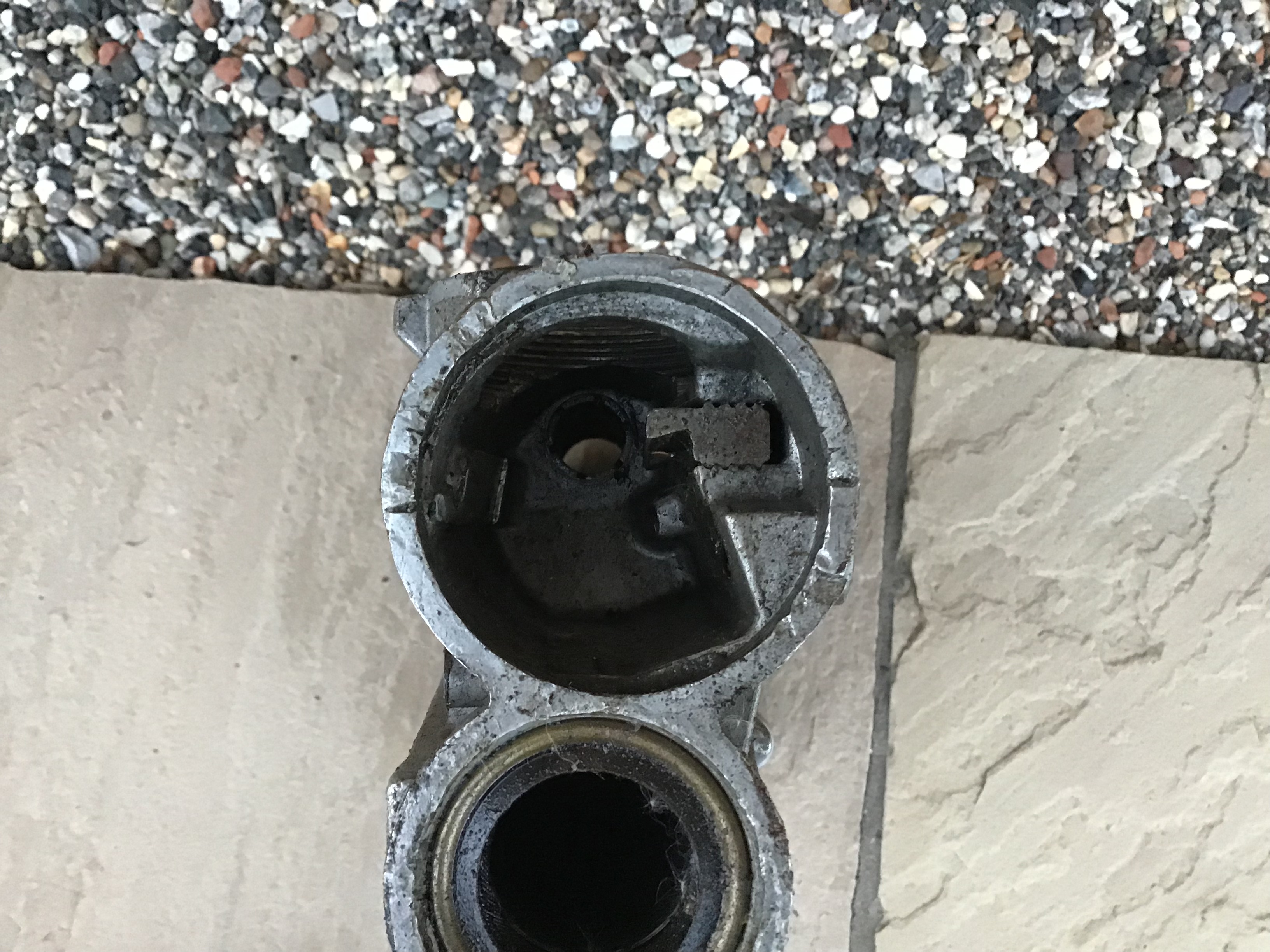

I did buy a quick shift to solve the problem but apparently there's something missing in the tail but the garage couldn't source the part
The reverse stop in the tail shaft is in the pic, if that piece is broken or warn it would give you the problem. I’ve not heard of one breaking or getting that worn. I could try and remove this one if it’s any good to you.
6 minutes ago, Tangomk2 said:
I think it's missing quite hard to see Screenshot_20210613-213927_Gallery.thumb.jpg.e43d6ed8403223c6e04912f35d2ae3da.jpg
I’ll try and remove tomorrow, if so will drop you a PM
