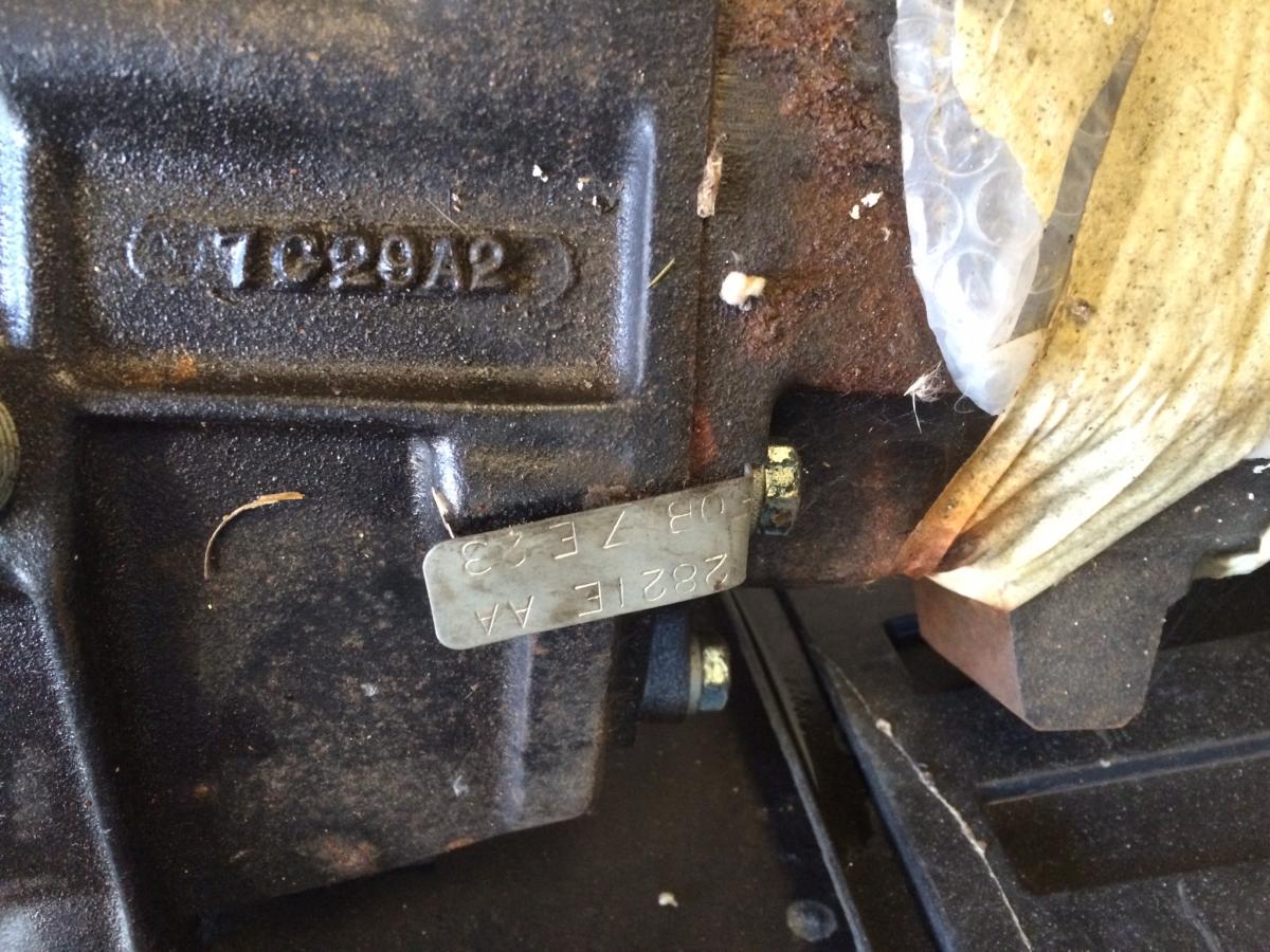

  6. Thrush hush box ?!?! Is that the 70s version of caneston combi?

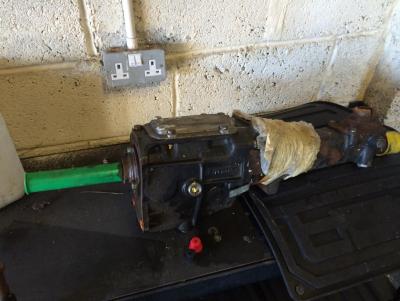

  8. Cheers much appreciated it's been reconditioned guys trying to sell it. Worth a couple of hundred ?
  9. Can anyone ID this gearbox please lads ? Cheers stew
