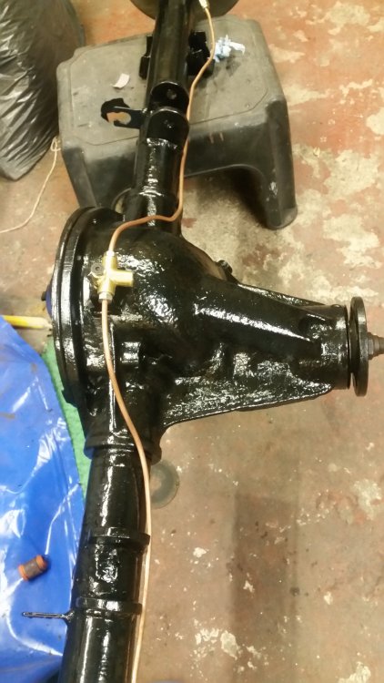

  7. I have since rebled the system as there was a very slight leak on the T piece on top of the diff housing, that is now ok and its bled better. I took the OS rear wheel off to look at the piston. It was out behind the the pads so that to me looks like it's adjusted out as it should. As for the NS rear, I don't know as I'd had enough by this time and went home. Was just chatting to a mate and he thinks that as it's all new it will have to bed in, pads onto discs etc. I'll have another look in the next day or 2 as I've got to make a new handbrake rod from the lever bottom. Cheers. Fozzy

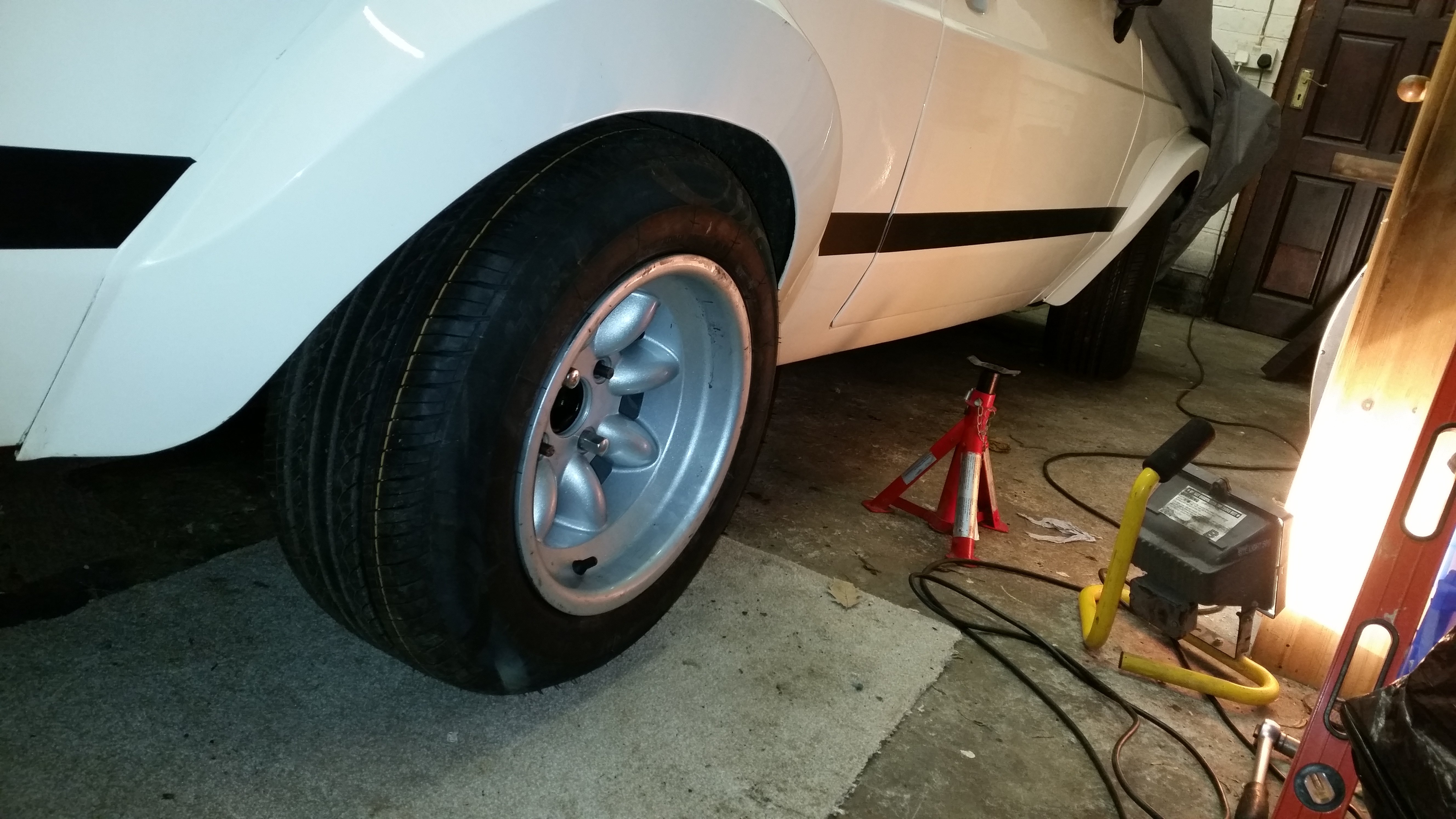

  20. Well I did more work today on the axle. I fitted it to the car incl handbrake cable. Need to put a new tramp bar poly bush on as yet and connect the brake line up and bleed. In the meantime I put the wheels on and lowered it to see how it will look and I am well pleased. I bought a new radiator aswell, so that needs fitting too. Fozzy

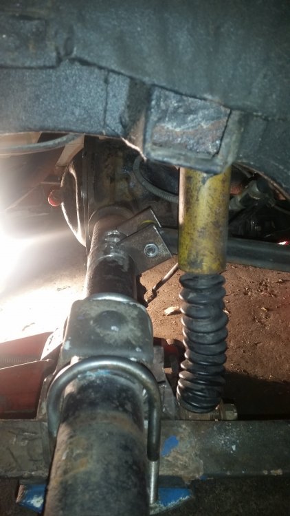

  21. Thanks. No mate, just kept it same width. The car has tarmac arches so wheels will come level with arches. Fozzy

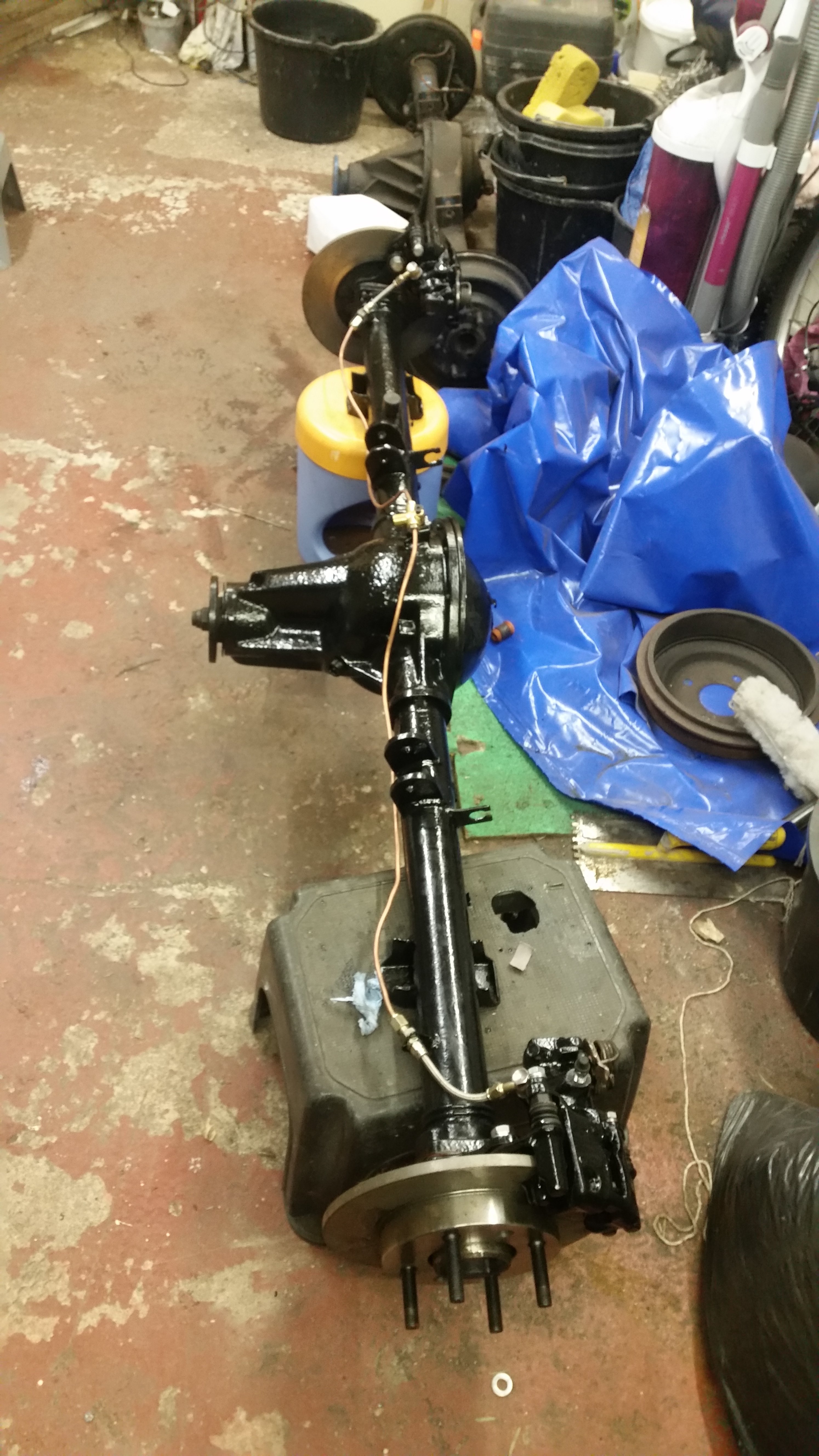

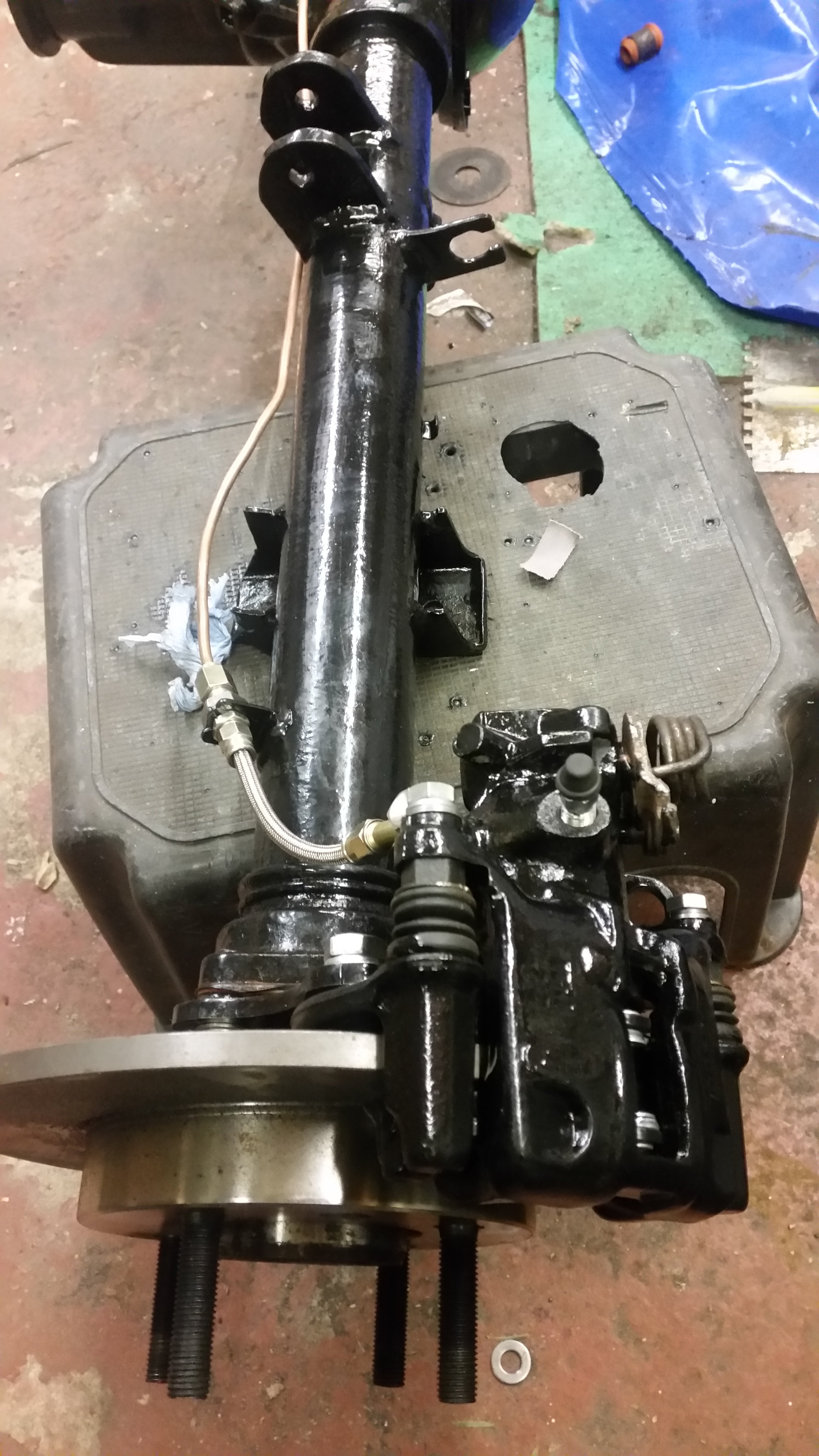

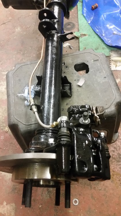

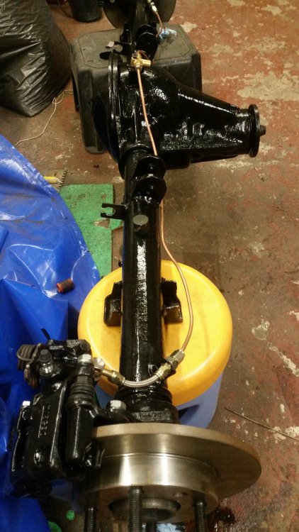

  22. Well the capri axle I got for my RS2000 is finally finished and ready to install. We did a dry run to test the handbrake cable on Wednesday and welded brackets on. I've since painted it up and fitted the discs, calipers and pipes which were kindly made by Colr6. Since its off I'm gonna take the leaf springs off, clean them down and paint those too. Well I might aswell while I'm at it. The cosworth handbrake cable I got seems to work as it should and is the perfect length with me thinking I may have to cross it over at the back to loose some length. I'll update with more photos as I install it. Fozzy

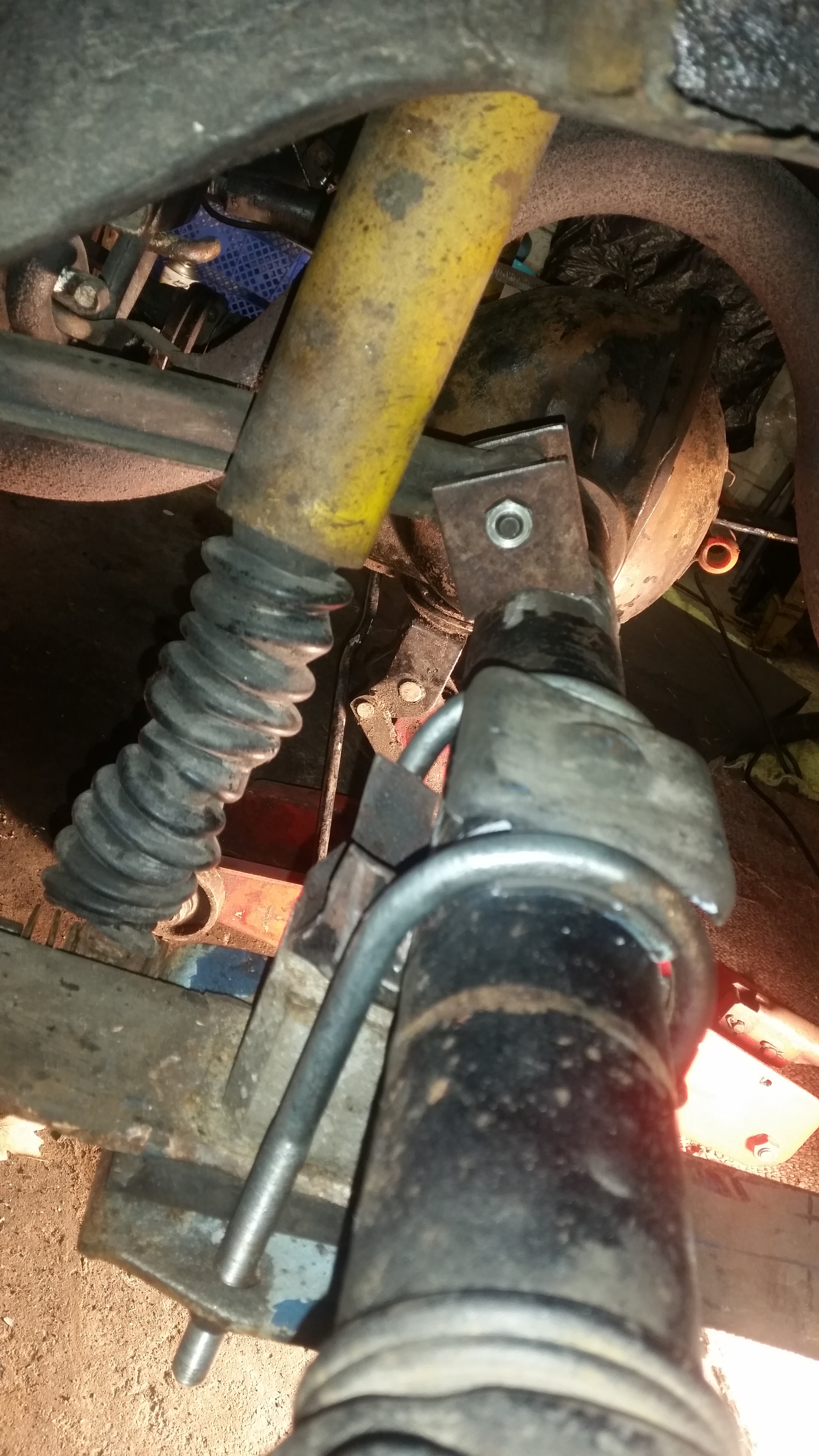

  23. Think I've sussed it. When I put the axle on for a dry run I attached the prop onto it then lifted the car as if at driving height. As you will know the diff is offset to the drivers side. As the diff on this capri axle is slightly longer than the escort I believe the prop is up to its limit in the gearbox. This means that the prop is pushing back in favour of the drivers side. Just a few more checks to do then I'm gonna try it tomorrow. Cheers. Fozzy
  24. Yes mate, you are spot on. This is making me wonder IF the O/S spring has been put on wrong way. My mate has suggested it may be the bushes in the leaf springs that have play but the initial measurements that I am getting suggest about 1" out. I doubt very much that bushes would make 1" difference. Unless it's a build up of other bushes need replacing. Thanks buddy. Fozzy
