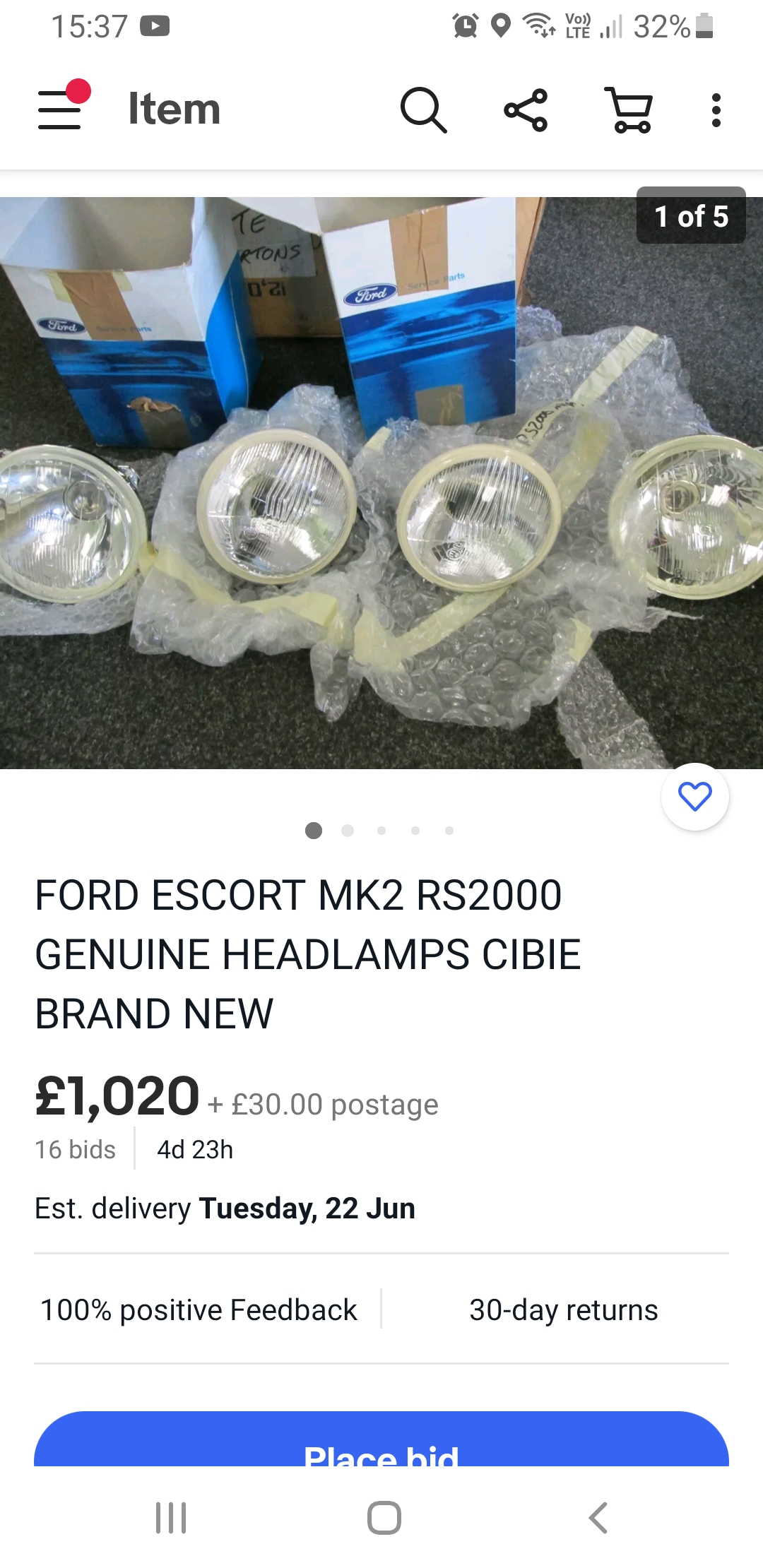

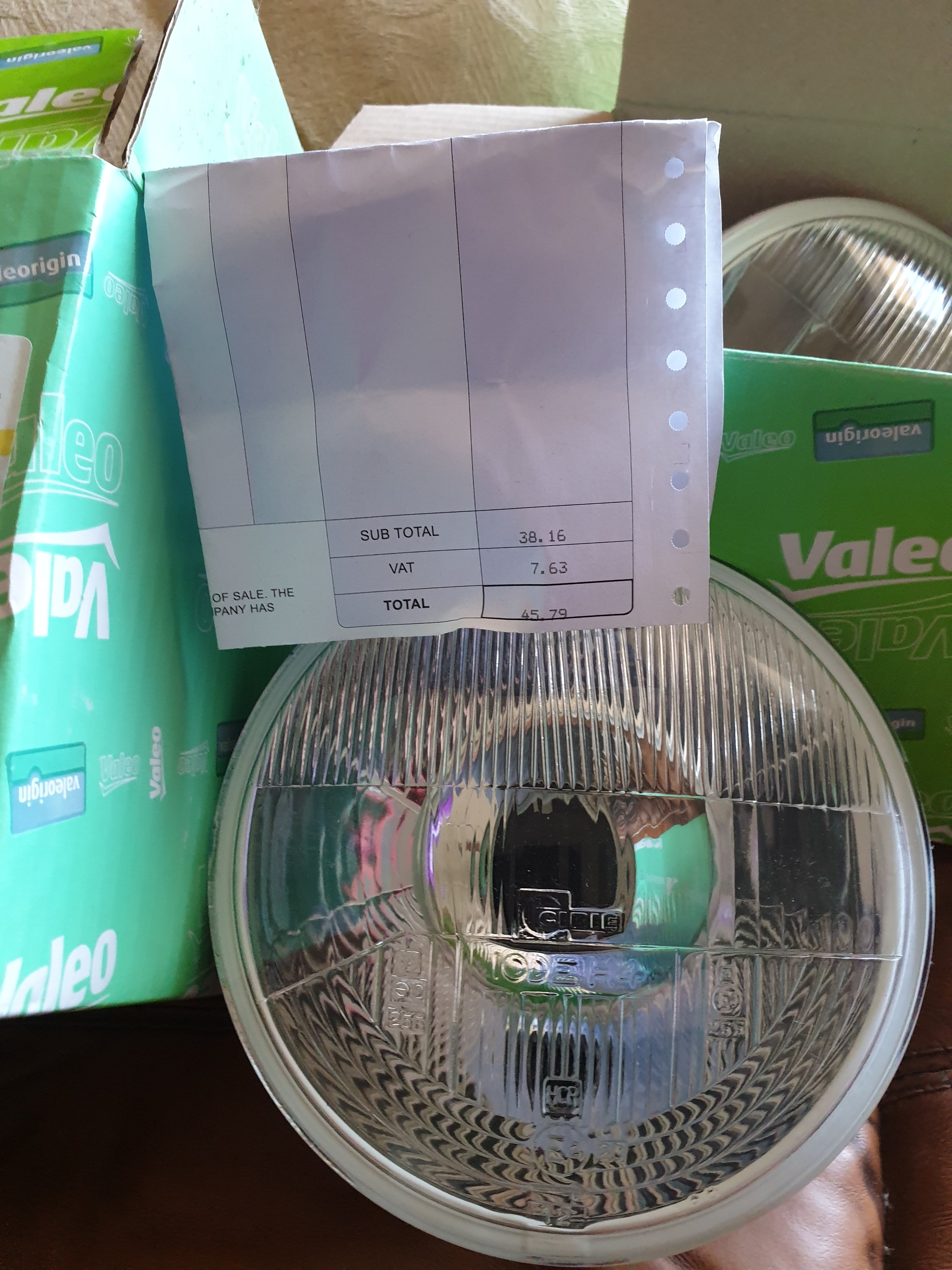

Its a King joke 🤦♂️ I bought a pair of cibie 7in headlamps from my local car parts place about 2 years ago for 45 quid brand new , you see 2nd hand ones go for 100 quid a side 😳

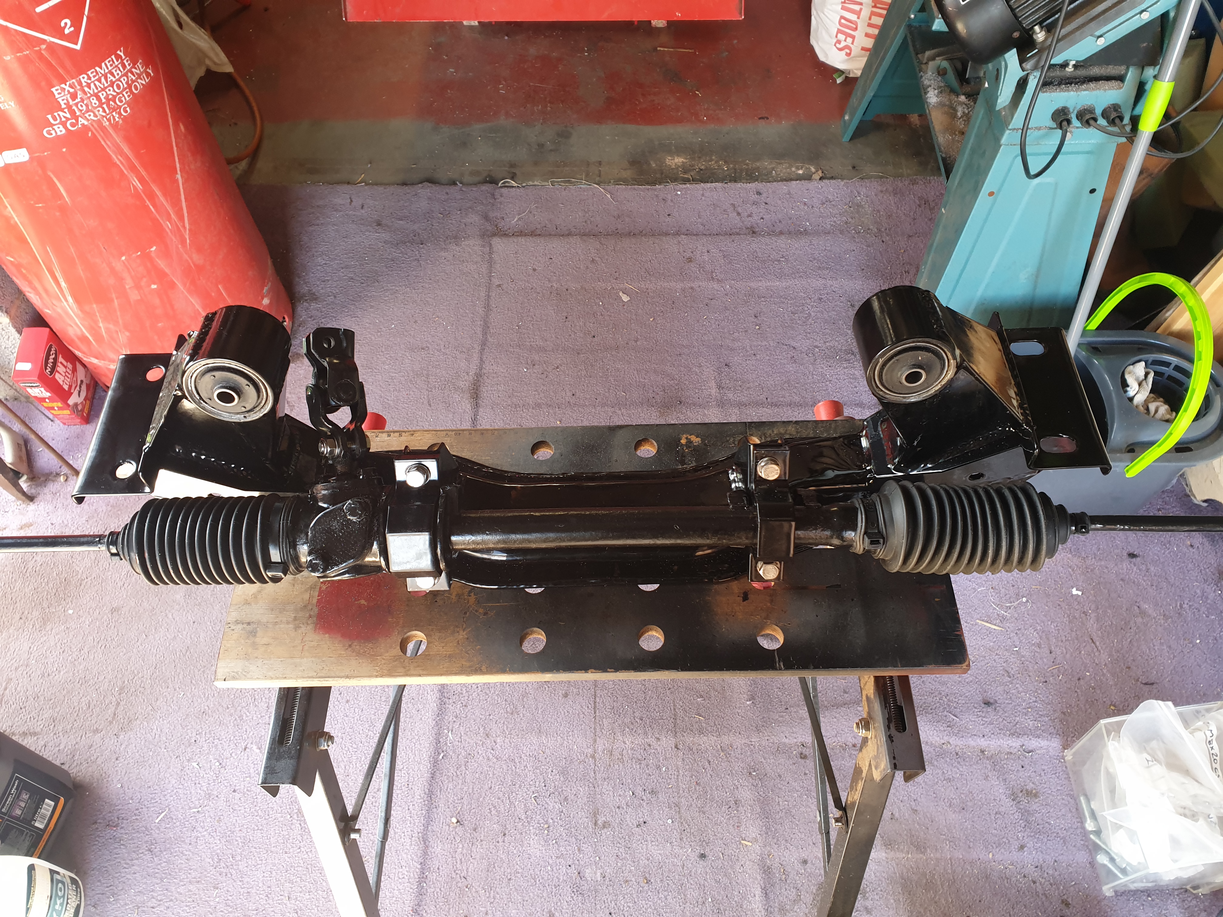

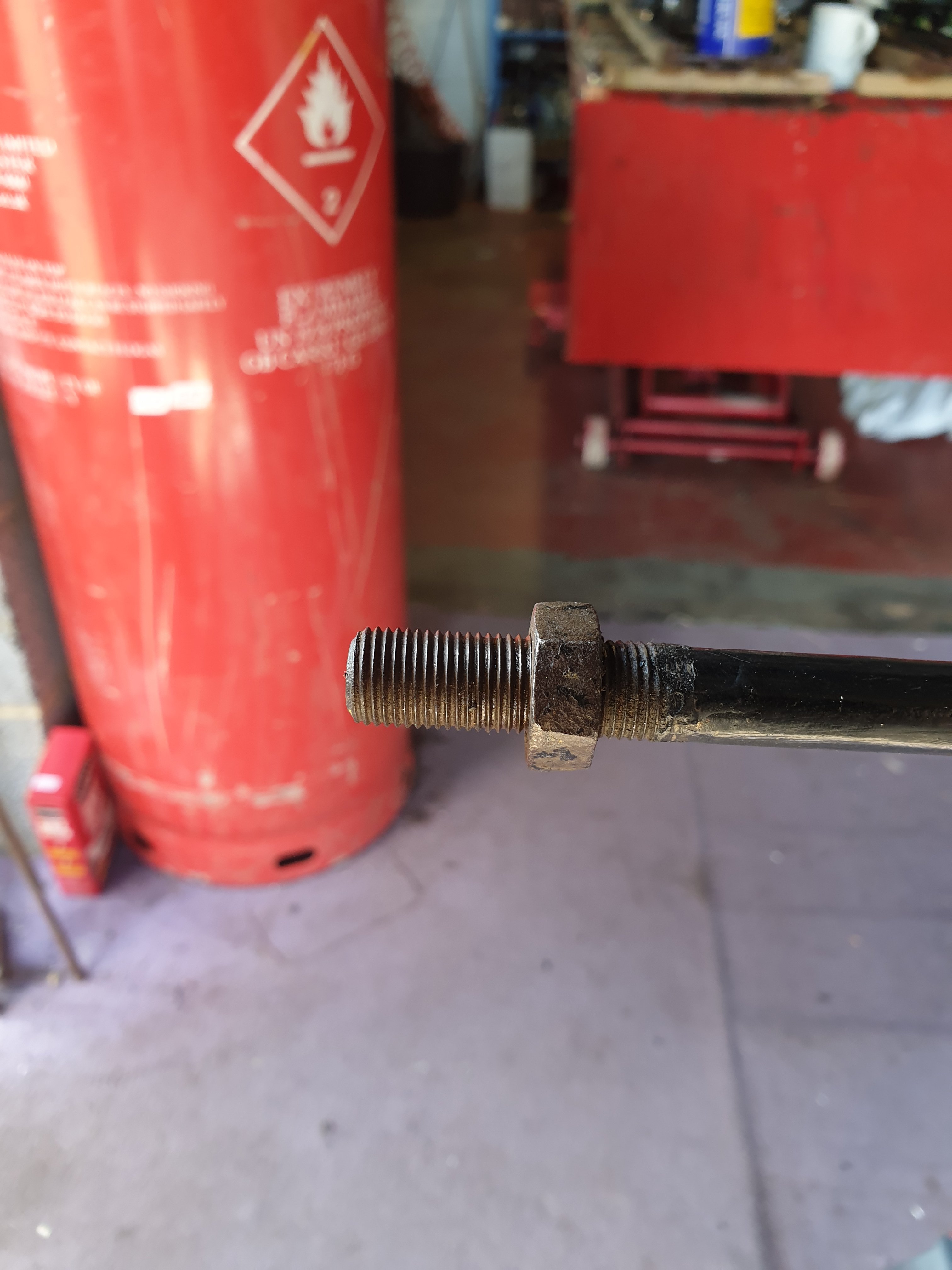

Thats what i was hoping!! As the taper in the bolt on RS steering arm is the same be it off a mk1 or mk2 escort . Will get a pair of mk1 rod ends and go from there me thinks ! -

Thanks there but i have got 2 spare racks that i can rob arms off 👍 -

I have got a pair but they wont fit the unf arms in the photo cus the green track rod ends are an M14 thread 😔 -
Hi all. After haveing a job fitting my billet rack clamps ( lots of filling to make them fit) it turns out i have got unf rack arms ( mk1 escort?) Not the M14 metric mk2 arms 🤦♂️ My question is is there a track rod end that will fit the unf arms and fit to rs style bilstein front struts or have i got to swop the rack arms to the M14 arms and use "green" track rod ends . Thanks 😊
