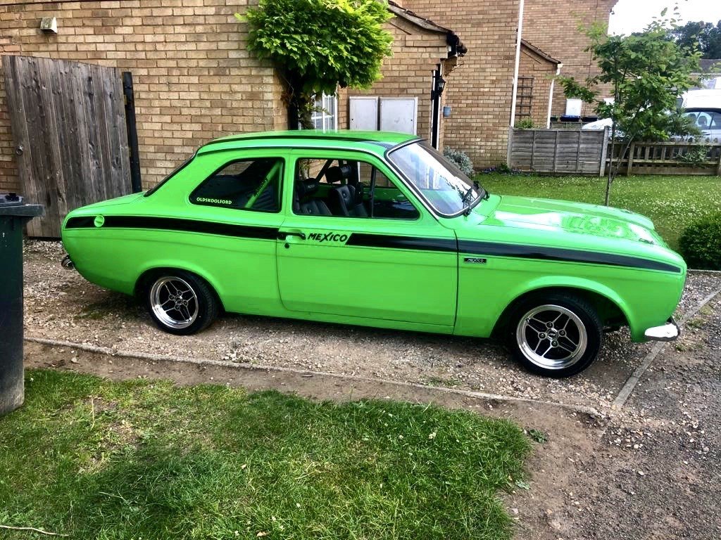

  7. Hi All, Sorry for yet another question! I bought some new wheels for the escort and I've put them on, I'm really pleased overall but the front geometry is bugging me. I had to lower the front a touch to get it looking right and as its now about 0 degrees castor. Not only that but in my opinion the wheels don't sit right in the front arches. I do already have a twin cam ARB and appropriate mounts from Rally Designs fitted. The castor angle presently is neutral... So my questions are, does anyone else think the front wheels sit incorrectly as per the picture, and does anyone have any suggestions to correct it? Thanks in advance for your help!

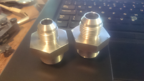

  11. Hi All, Just a heads up- it looks like the first adapters have now been made and are being trialed now by MotorSportTools, both -8 and -10. All the information is on a turbosport thread, http://www.turbosport.co.uk/showthread.php?t=1588441&page=2

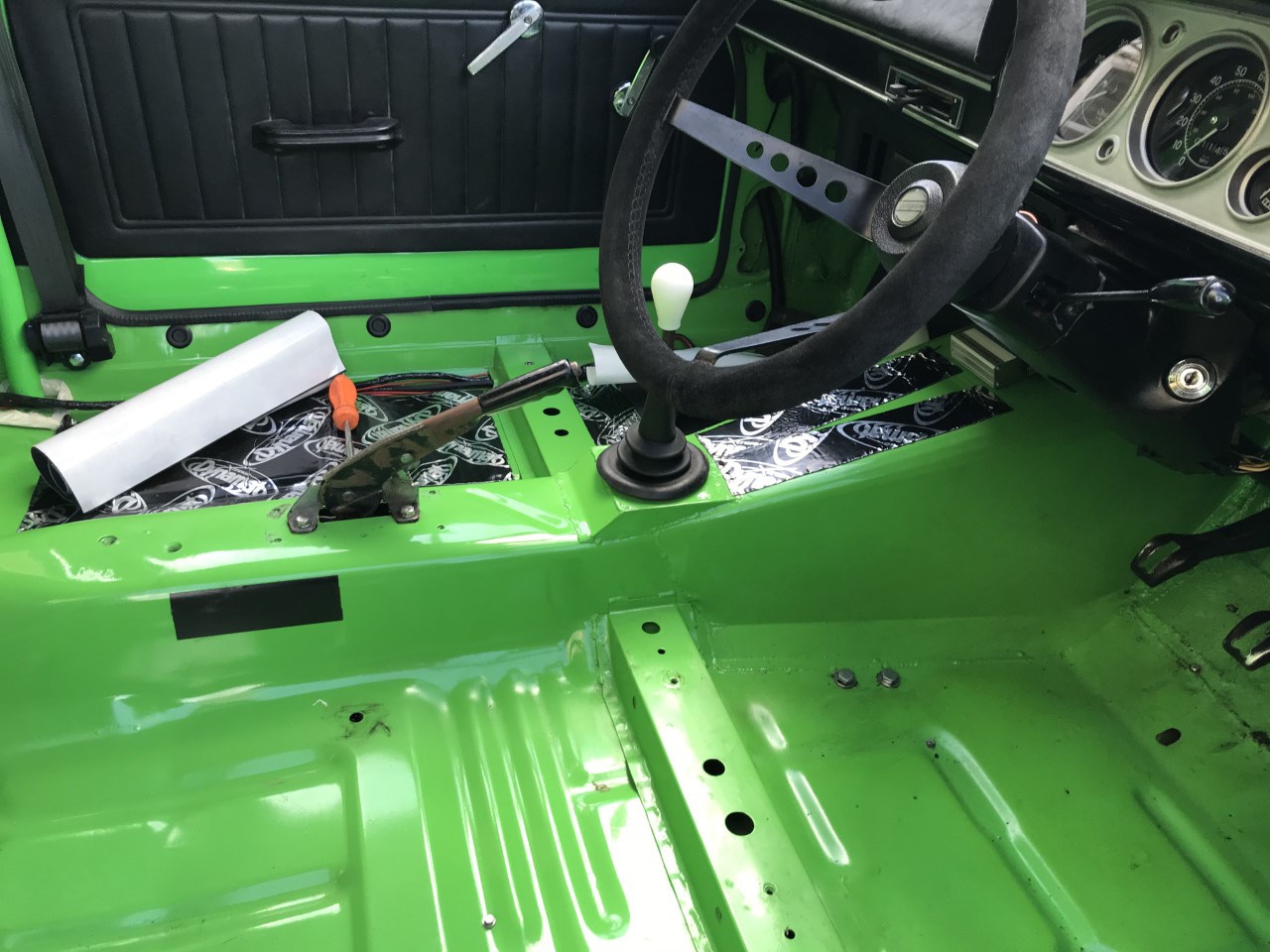

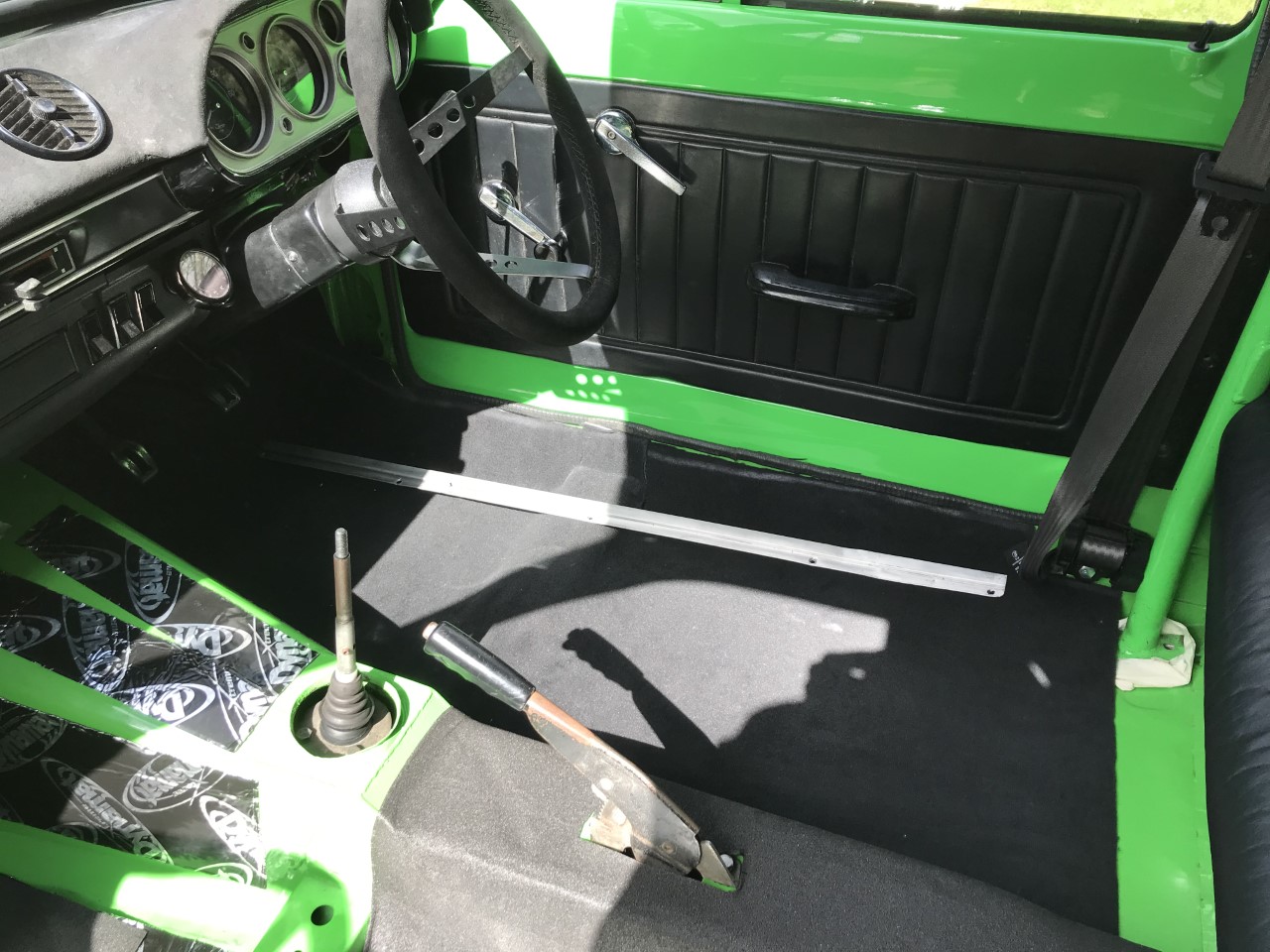

  12. Ill let you know what happens when I drive i properly, Im not expecting it to be silent by any means but it should help. Already just reversing back into the garage it seems a little quieter, and not as much resonance as before. Its actually quite a nice job to do ive found, as I mentioned surprisingly expensive but if you take your time you can get a decent finish.

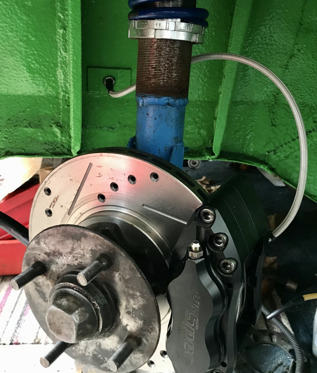

  13. Thought Id update this thread with some small changes I've made to the car recently! The good news is that its still driving really well, and I'm completely happy with the engine conversion. It feels incredibly reliable, regardless how long its stood still, you can turn the key and its running within a revolution. I've completed about 200 miles so far which granted isn't a lot, but also I've not had anything to snag either, so I just need to start doing some slightly longer journeys. So firstly the Hi Spec brakes went on fine, I got some 247mm drilled and vented discs to suit and some braided lines and they are great. To be honest, actual braking performance if measured might only be fractionally better than the M16s, but the fact they are so light, and having the vented discs just inspires a bit more confidence. They also look much better behind the wheels in my opinion. I also got the rear Gaz adjustables on, they feel fine but to be honest the old ones didn't feel bad, these were just shinier So with needing to increase the distances I'm doing in mind, one thing that has grated on me is the noise in the cabin. Its deafening, and after a while driving, just a bit unpleasant. Mainly due to the fact there is no sound deadening or insulation/carpet of any type in the cabin. I have wanted to rectify this for 8 years, but its always been a non essential job that I put off. So now everything else is pretty much done I thought Id have a go. I bought some DynaMat sheet, and some foam insulation, along with a very good quality backed felt carpet. The DynaMat is brilliant but insanely expensive so i used it sparingly, the principle being that as long as a piece goes centrally over a panel it will stop the majority of the vibrations and thus noise. The passenger and drivers side floors were done, and then the foam insulation adhered over the top. I then put strips across the top, and sides of the tunnel. Finally I cut the carpet and did the transmission tunnel first, allowing an inch either side spare. The the floor sections overlapped this inch and gave a nice join from the floor section to the tunnel. Im actually really pleased with the finish, its not perfect but with the trims and seats back in, you really dont see the imperfections. Im yet to try driving it... but fingers crossed it will have helped!

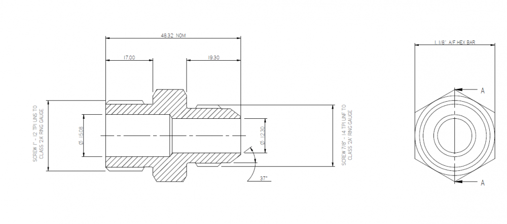

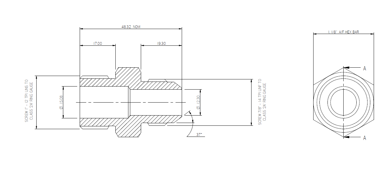

  14. Hi there, Sorry no I personally never progressed this. I got as far as designing the adapter and getting it drawn up, but I couldn't fulfill the minimum order quantity. I've attached the drawing below if its any use to you, it will thread into the tank and gives a -10 end (better too big than too small and can always be adapted down). The good news though, is that MotorSport Tools contacted me via TurboSport on the other thread open for this. And they are actually going to be making and stocking this very thing by the end of the year (or so they say...) : http://www.turbosport.co.uk/showthread.php?t=1588441&page=2
