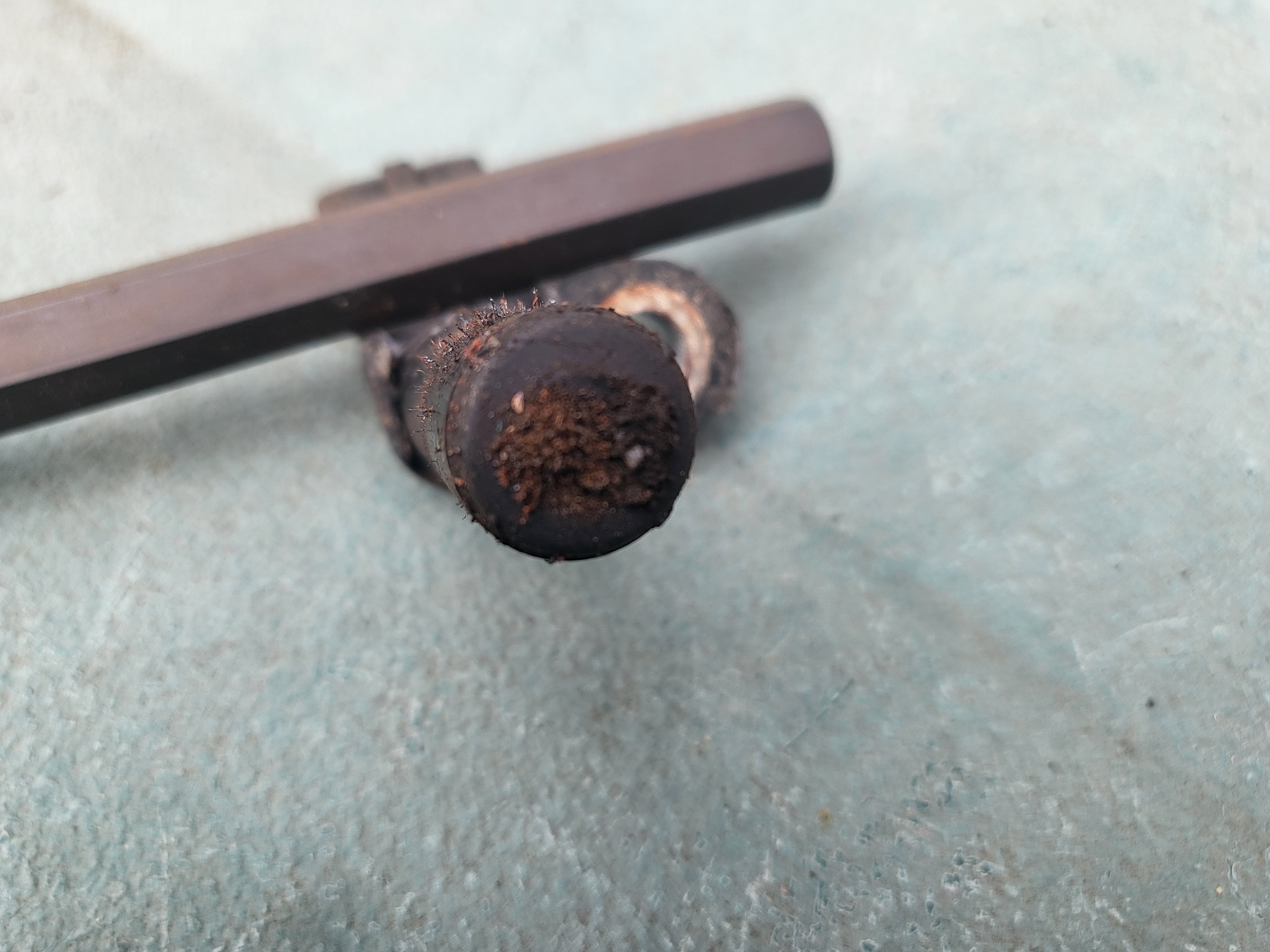

  16. Well, just out curiosity, I removed the crank shaft sensor this week. It didn't look very promising. I've cleaned it off, but I've also bought a new one to fit anyway, because I have no idea how long this one has been on the car. (I've also bought a new camshaft sensor) So could all of this crud stuck to the end of the sensor be causing my issues?
  17. I have no idea. I'd have to trace the wiring back. And there's a lot of it!

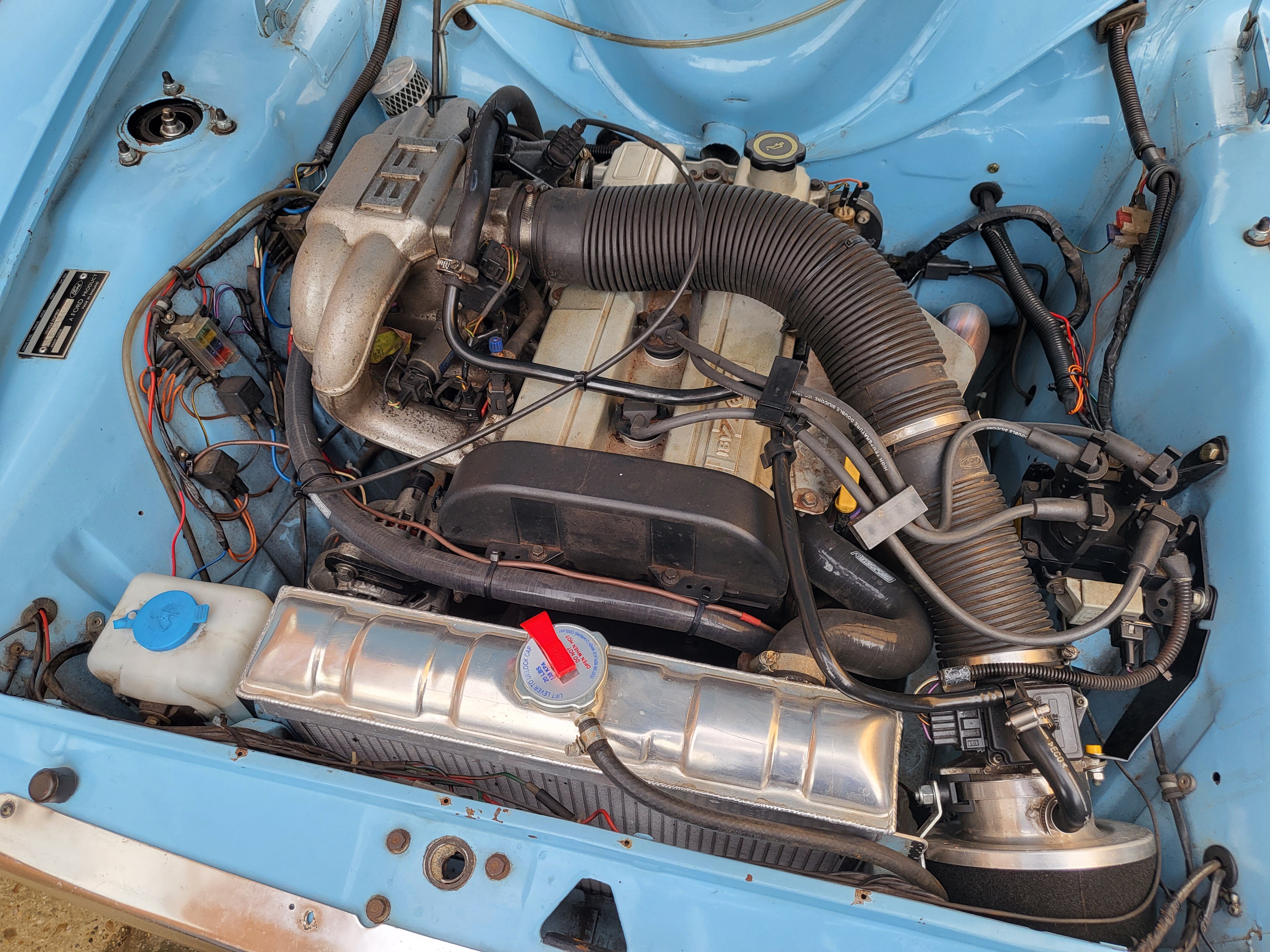

  22. Hi all, I have a 1965 Mk1 Cortina fitted with a 2.0 Zetec and running an Escort 1.8Si EFI system. (Along with the Escort ECU) Until this morning I have had an intermittent fault where the car feels like it's dying and losing power. This morning my intermittent fault turned into something very permanent which led to me missing the Battlesbridge Breakfast meet and being recovered home on the back of a truck. ๐Ÿ˜ž Now, I know nothing about these set ups and always said that one of my fears would be that if it wasn't to start one day, I wouldn't even know where to look. Well unfortunately that day is here. The car does have a socket for an OBD2 reader, but all three code readers I have tried couldn't connect to get a reading. In recent weeks I have changed the electric fuel pump, the MAF sensor, and spark plugs. The car cranks over but doesn't fire at all even though there is a healthy spark at the plugs. Any ideas what to investigate next?

  24. Yes, I remember the seller saying the ignition key and unit is hidden away behind the dash. Regarding the MAF sensor, I think the way car is built, was done about 20 years ago, so it wont hurt to replace the MAF sensor, and it's another thing that can eliminated from my search. The car is booked in to Redline Tuning at Laindon in a months time anyway for them to look at the mapping and possibly fit a new ECU. I'm just trying to cure the running fault before it goes to them to try and keep the bill down. ๐Ÿ™‚
  25. I've had the car running this morning (I cant take it for a test drive-it's boxed by two other classic cars!) and found that it was not quite fully responsive when revving. So I unplugged the MAF sensor and it revs cleaner and is a lot more responsive. Anyone know the best place to get a new MAF sensor?
