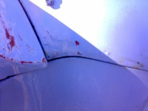

FredTransit Posted April 21, 2008 Author Report Posted April 21, 2008 Took advantage of last week's good weather and did a bit to the cab. Before After During After Overall And this is what I am up against close up. I might change the bonnet altogether before the proper paint job. Due to the 'Dulux paint applied with a Dulux Dog' current finish it was impossible to use a sander, it just kept getting clogged up so wet and dry by hand was the only way.

john_3.0s Posted April 24, 2008 Report Posted April 24, 2008 cant you use paint stripper to get it off rather than sanding, it'll take you forever! cab looks ace though, i love an old tranny and thats gotta be a rare old thing now days
FredTransit Posted April 24, 2008 Author Report Posted April 24, 2008 I am a bit wary of paint stripper, it can get trapped in seams and trim lines, and bugger up the new paint. It's a pain but the hand wet and dry sanding has made a really good finish. Thanks BTW, I dread to think how few Mk1 crewcabs were made in the first place, let alone how may are left.
escysean Posted April 24, 2008 Report Posted April 24, 2008 I am a bit wary of paint stripper, it can get trapped in seams and trim lines, and bugger up the new paint. It's a pain but the hand wet and dry sanding has made a really good finish. Thanks BTW, I dread to think how few Mk1 crewcabs were made in the first place, let alone how may are left. Any automotive paints will react badly on household paint that was applied on the bodyshell, I should know as I was ex-professional paint sprayer till I quit the job couple of years ago. As for paint stripper getting to all seams and trim lines, I usually put layers of masking tape (2" wide tape) over the gaps and seams, then applies paint stripper over one panel at time and scrap the old paint till bare metal then go over to another panel etc, hope it is of help mate Sean
FredTransit Posted April 24, 2008 Author Report Posted April 24, 2008 Thanks for the masking tape tip, but I am not brave enough to go to bare metal on the street! Anyway I suspect the paint is vinyl silk, would stripper work on it? I put regular primer over the paint I sanded and it looks like it's fine (no reaction), but I went down to the red underneath which smelled like celly.
