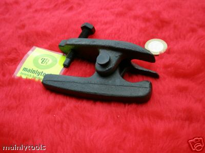

FlashCadillac Posted May 9, 2008 Author Report Posted May 9, 2008 As above mate to need one of these and this goes between the arm and the strut with the stud in the middle i guess.... know where i can get one from?
emu Posted May 9, 2008 Report Posted May 9, 2008 Smack the side of the casting with a sensible size hammer. Not the actual ball joint or thread but the casting that it goes through . Vast majority of the time that will shock the taper free and doesnt damage the boot. I find its very rare that I have to resort to a ball joint splitter, in fact, I use mine so little that I never even bothered taking it to work
fezza Posted May 9, 2008 Report Posted May 9, 2008 As above mate to need one of these and this goes between the arm and the strut with the stud in the middle i guess.... know where i can get one from? Thats right mate if what emu suggested dont work you should be able to get a splitter from Halfords or if you dont mind waiting a few days get one from fleabay http://cgi.ebay.co.uk/Brand-New-8-Ball- ... dZViewItem

flyingbanana Posted May 9, 2008 Report Posted May 9, 2008 As above mate to need one of these and this goes between the arm and the strut with the stud in the middle i guess.... know where i can get one from? Thats right mate if what emu suggested dont work you should be able to get a splitter from Halfords or if you dont mind waiting a few days get one from fleabay http://cgi.ebay.co.uk/Brand-New-8-Ball- ... dZViewItem i wouldnt buy the fork type...they spread open when smacked on esp when they are truly stuck...then break!!!! i would recommend the bolt type like this design

Tom Posted May 10, 2008 Report Posted May 10, 2008 those fork type ones don't do the joint any good mate but the one with the bolt in it is a better one. As others have said a good sharp shock with a hammer should free it off
