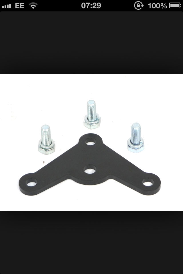

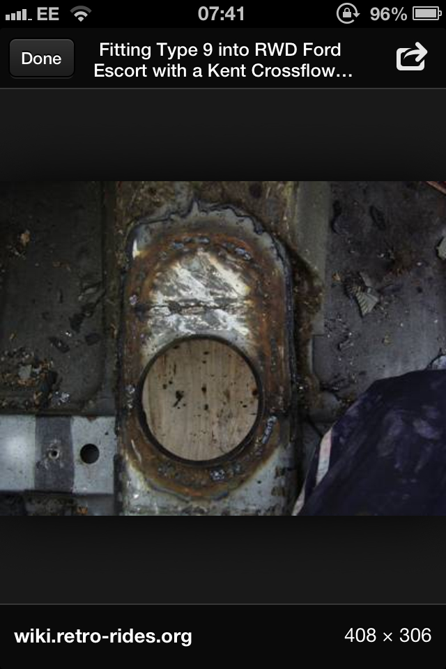

mk2 mike Posted August 7, 2013 Report Posted August 7, 2013 I'm doing the same to mine soon. I've been told you will need- Alloy RS bellhousing (not absolutely necessary, but it gives more clearance in the tunnel. A big Hammer will achieve the same ) around £150 If you have the alloy bellhousing you'll need the proper RS clutch fork. Around £40 A 23 spline clutch plate (I've been told a 1600 sierra one will suit) As said, a bracket for the clutch cable to pull on. You can make your own or retroford do these ones for £8 Alloy gearbox lowering blocks to lower the box and use the original mounting holes. (Or you can drill new holes and just bolt it through the floor, depending if you want to drill into the shell) around £20 Single piece prop shaft. Around £150 You can get a longer speedo cable as the box is longer but its not necessary. You'll need to move the gearstick hole back a bit (again as the box is longer than a 4 speed) you can see from this pic where someone has cut out the hole, turned it round and put it back in. And finally a quick shift gear lever. The longer box means the gearstick will foul the handbrake. (Or you could bend the original gearstick). Around £50 Have a search on the t'interweb. There's loads of 'how to' guides. Good luck!
