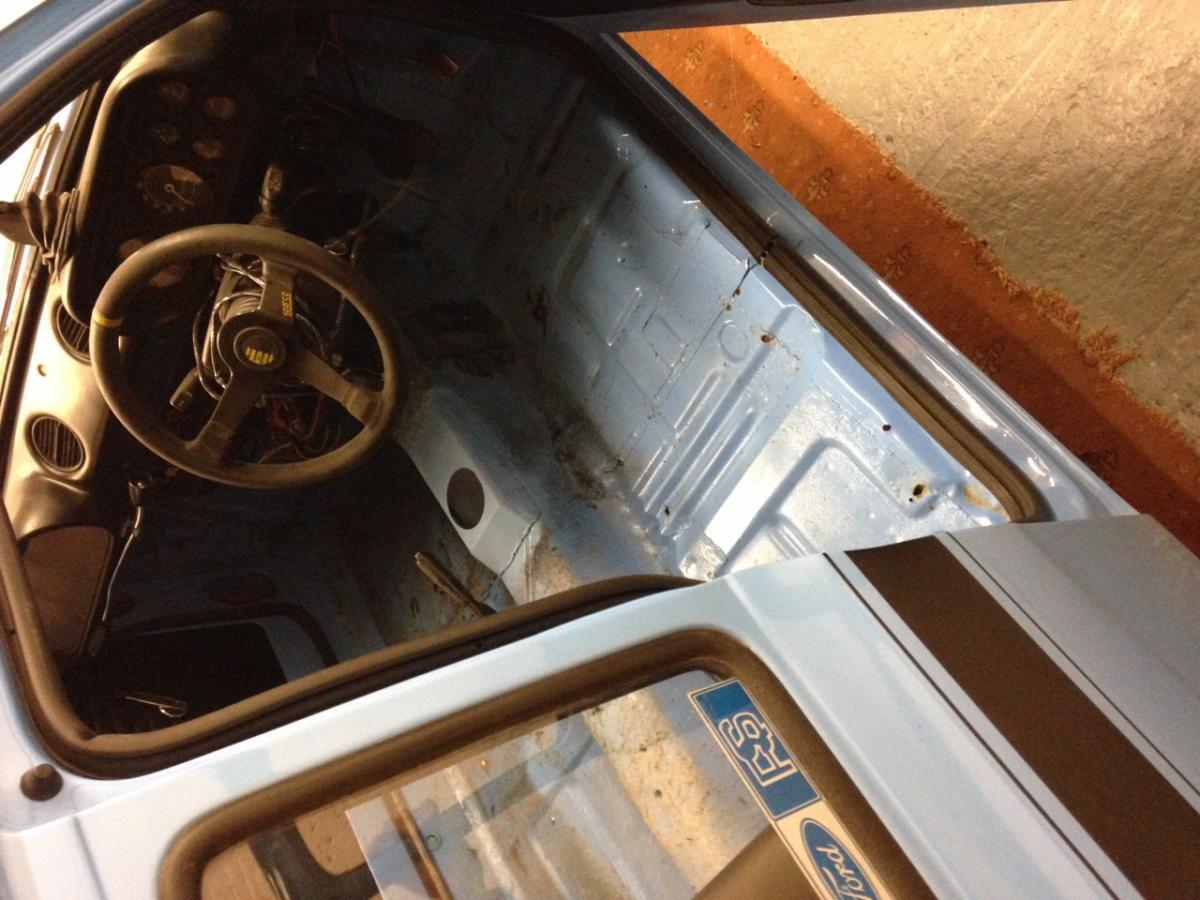

woz1976 Posted September 3, 2014 Report Posted September 3, 2014 I joined OSF, bought this escort and the fun has begun. Back when prices were sensible I was driving around in mk1 and mk2 RS2000's. Had a couple of 2.8 Capri's too. Genuine RS's were out of the question this time around, so I searched about until this Zetec powered escort turned up. It had a few foibles to begin with, but I'm working through them. Funniest one was the engine wouldn't shut off until the door was open? How about that for random! It was also running the original Mondeo injection and an open diff. I've been slowly bringing it up to date. It now has a Tran X diff, Jenvey throttle bodies and omex ignition. Best money I've ever spent. If anyone's interested I'll bung up some before and after pics of what I've achieved so far. 2
mk2xflow Posted September 3, 2014 Report Posted September 3, 2014 yeh stick some pics up mate always interested in progress on here,nice looking motor

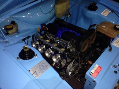

woz1976 Posted September 4, 2014 Author Report Posted September 4, 2014 That's where I am in the engine bay. Std injection and Mondeo alternator junked. Std ecu swapped for Omex and coil pack moved under inlet manifold. Tomorrow's job is to tap inlet for brake vacuum. I'm building up to that one! 3

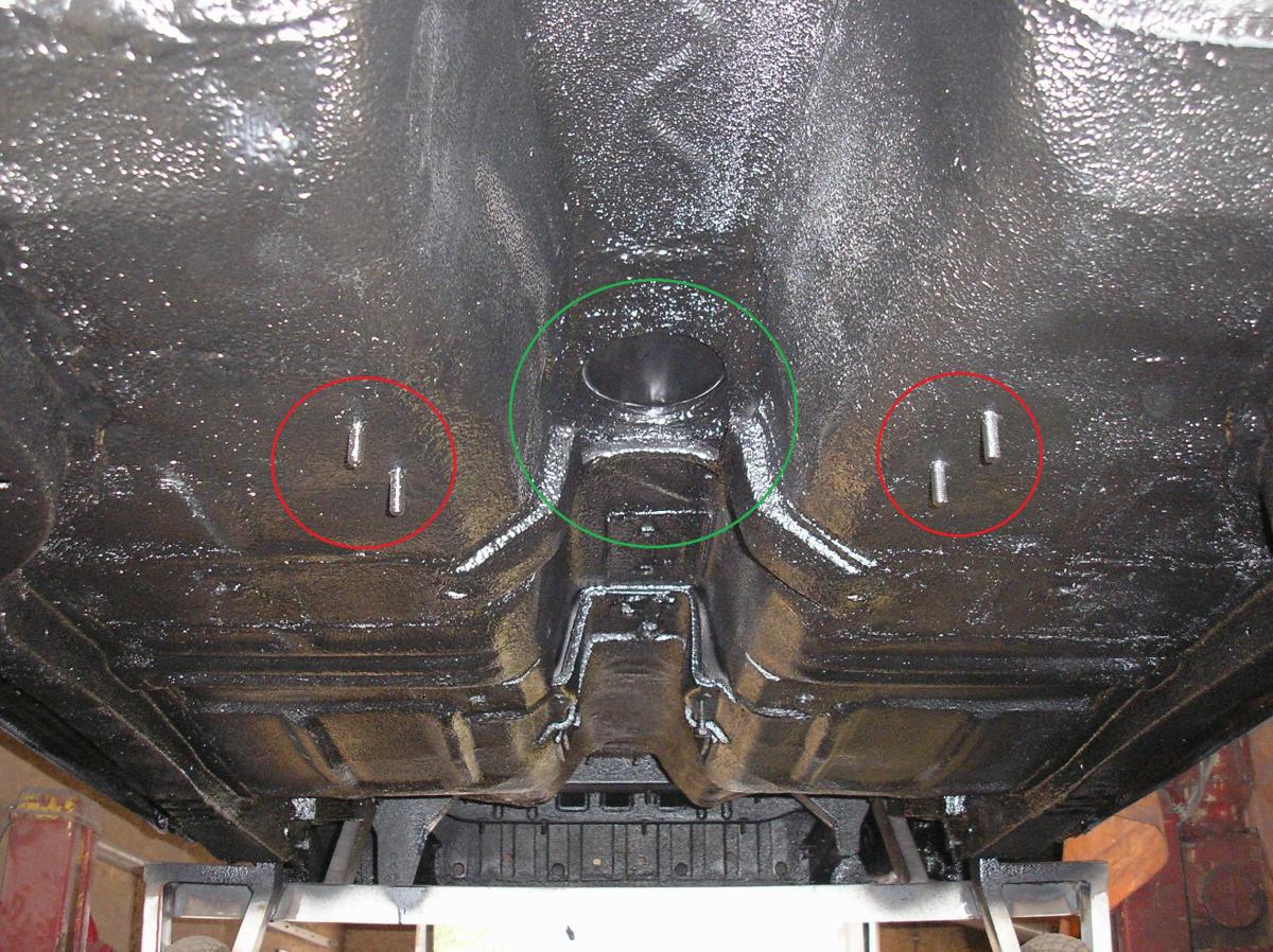

woz1976 Posted October 25, 2014 Author Report Posted October 25, 2014 So today's acheivement. I've finally managed to remove the type 9 from the completely std transmission tunnel. What a mare that was. God knows how the original builder got it to fit? I reckon he bolted the box up to the engine and dropped the car over the top! So before I fit my newly purchased Quaife straight cut back in, I need to make a decision on what to do with the tunnel. Do I buy Retro Fords raiser plate or chop the tunnel and fit a replacement larger gearbox tunnel? Thoughts please.
John escort mk1V6 Posted October 25, 2014 Report Posted October 25, 2014 Hi , you mean a 5-speed type 9 ? A have a 5-speed type 9 gearbox in mine escort estate mk2 , and i removed the original brackets and used a subframe/hinge from a automatic and reinforced the floor on to the tunnel , just a simple plate 2mm and bolts trow the floor and jone , check if the driveshaft sits right. Now i see you want to place a other type gearbox.
woz1976 Posted October 25, 2014 Author Report Posted October 25, 2014 Yeah 5 speed. Excuse my ignorance. I thought all type 9's were 5 speed and the 4 speed was a type E or earlier? Learnt something new today So are you saying don't bother with a large tunnel. Will defo have to either fit raiser plate or remove gearbox breather otherwise it'll bash the top of the tunnel big time.
Admin Vista Posted October 25, 2014 Admin Report Posted October 25, 2014 Yeah 5 speed. Excuse my ignorance. I thought all type 9's were 5 speed and the 4 speed was a type E or earlier? Learnt something new today They are (re type 9's all being 5 speed) I use a T9 in a standard mk1 tunnel, it is definitely possible. You can get them in and out by dropping the cross member down on long bolts to open up the gap to the bulkhead.

woz1976 Posted October 25, 2014 Author Report Posted October 25, 2014 Thanks all. Think I might just chop the top of the tunnel, fit up the box and see what the crack is. I can always weld it back on if needs be. It'll drive me mad if the tail shaft cover on gearbox is vibrating against the top of the tunnel. Although last Sunday's welding exploits involved a trip to A&E. So wish me luck! On another note, has anyone used Retro Fords gearbox mount? I like the idea it is height adjustable, so I can tweek the height. My current affair looks a little Heath Robinson. I have mounts bolted to the car, then another set of mounts bolted to these...... And then the gearbox mount bolted to that.

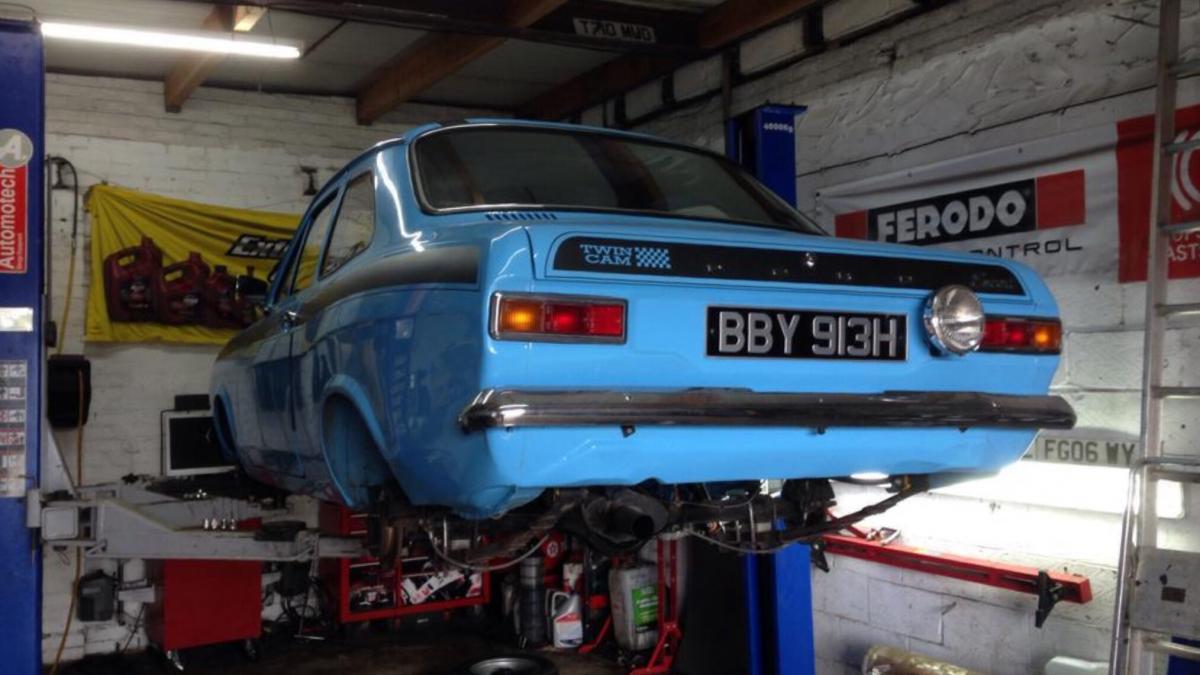

woz1976 Posted December 22, 2014 Author Report Posted December 22, 2014 A little update.Got the raiser plate welded in and also purchased a better gearbox mount at the same time.Had a quick go at lifting the box back in, but I was at least 2 weetabix short of the lifting power required.With a bit of luck my little big bro will come to visit over the holidays and supply the extra muscle power! 1

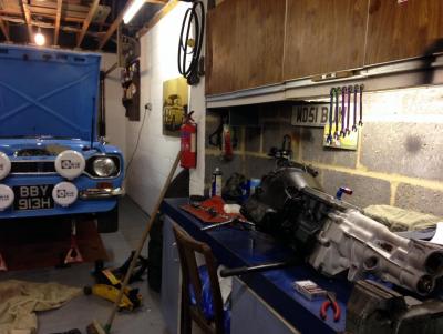

woz1976 Posted December 30, 2014 Author Report Posted December 30, 2014 So a little update....... I got the gearbox back in with a couple of mates. Finished bolting it up and fitted the retro ford gearbox mount last night. This morning I took it for a quick spin, got a mile from my house and the cast bell housing cracked where the clutch cable is mounted. Gutted! Limped her home in 2nd gear and shoved it back in the garage. It must of got damaged when we were fitting it. :0(
