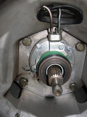

fiestachaser Posted September 25, 2016 Author Report Posted September 25, 2016 Hi, the box is a 2.8 V6 box out of a Caterham with a spacer plate . How would `I go hydraulic clutch? The only option I have seen is a new bellhousing....mega bucks and you have to modify your release arm. I'll habve a look at p100 diesel bellhousings.
colr6 Posted September 25, 2016 Report Posted September 25, 2016 You could always cut input shaft down and get rid of spacer and fit type 9 hydraulic conversion.
fiestachaser Posted September 27, 2016 Author Report Posted September 27, 2016 Hi, Just looked at hydraulic kits. £150-180. Bumps my budget up and still have the problem of the starter on the wrong side. Will probably go LHD bellhousing and cable. Its not going to be mega spec engine so can live with the cable. Thanks for your ideas guys .Keep em coming.
