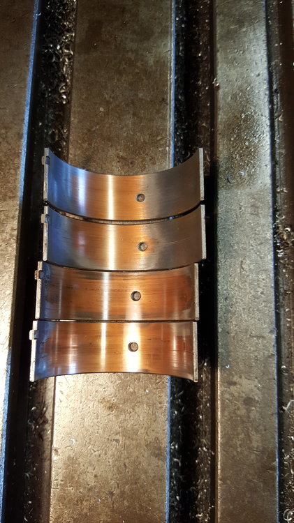

Munch Posted April 5, 2019 Author Report Posted April 5, 2019 I wanted to keep it original looking, i.e original air filter, rocker cover and carbs with the battery still where it should be, but change the internals and a few other components. I don't want an unruly beast, but I do want a bit more oomph so I've had the crank lightened and balanced along with the conrods and valves, bigger Mahle pistons by 1mm, so I believe this will make it 2040cc, skimmed and ported head and it already had a piper 285 cam so I've kept that. Obviously all new bearings, oil pump, fuel pump, water pump, alternator, starter motor, clutch and Vernier pulley. I may have missed some bits, but I will be finishing the build next week so if I have I will update you. I am hoping to achieve 140 - 150hp. My mechanic told me that I made a great decision to strip the engine as the big end bearings wouldn't have lasted much longer, see picture. It's funny how things work out for the best sometimes. More pics to follow next week. 3

katana Posted April 5, 2019 Report Posted April 5, 2019 Hmmm - surprised that you still had oil pressure with those bearings and no damage to the crank? Possibly lose the fan and go electric - good for a few hp and better cooling?
Munch Posted April 5, 2019 Author Report Posted April 5, 2019 No damage as far as we can tell. . . again lucky. That's a good idea but I might see how I get on with a standard fan and maybe that can be for next winter.

notenoughtime Posted April 6, 2019 Report Posted April 6, 2019 On 05/04/2019 at 21:49, katana said: Hmmm - surprised that you still had oil pressure with those bearings and no damage to the crank? Possibly lose the fan and go electric - good for a few hp and better cooling? Look at the bearing very smooth so just wear no tearing or grooves, oil pressure may have dropped when warm but not sufficient to notice if using the RS 5 clock
Munch Posted April 7, 2019 Author Report Posted April 7, 2019 On 06/04/2019 at 10:51, Monza said: Funny how things work out.....you said it was running fine!! Looks like perfect timing. Sounds like a good spec engine... sure you'll notice a big difference in performance too. Take it you'll fit new clutch while engine is out? Sent from my GT-I9505 using Tapatalk Yep, new clutch going in.
Munch Posted April 7, 2019 Author Report Posted April 7, 2019 14 hours ago, notenoughtime said: Look at the bearing very smooth so just wear no tearing or grooves, oil pressure may have dropped when warm but not sufficient to notice if using the RS 5 clock I changed the oil and filter at the end of summer and the oil pressure went up, but it I hadn't noticed it was low.
katana Posted April 7, 2019 Report Posted April 7, 2019 51 minutes ago, Munch said: I changed the oil and filter at the end of summer and the oil pressure went up, but it I hadn't noticed it was low. That's normal - new oil will always be thicker, but wear that excessive ie. once through the white metal bearing surface, the clearances are well outside normal tolerances and bigger gaps will always give lower pressures! You may have only saved the situation through sufficient flow - if the pump had been moody then crank wear would have been likely. As regards the RS pressure gauge - yes it shows pressure but how much is guesswork, just like relying on a light - these are usually tripped at 5-10psi pressure - woefully inadequate for useful indication of pressure! I far rather have a light flickering with a 30psi pressure switch for safety! 1

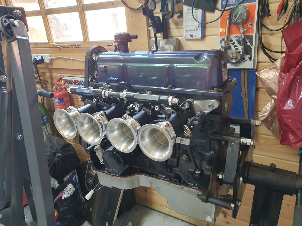

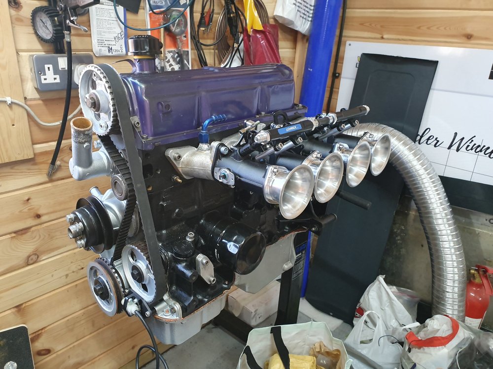

Admin Mk2Jo Posted April 9, 2019 Admin Report Posted April 9, 2019 I bet you are itching to get out in the car. My RS is currently waiting for my new engine to go in … I have gone with Omex throttle bodies though for a nice bit of reliability Bit of tuning on the dyno and away I go …. hoping for mid summer

Admin Mk2Jo Posted April 13, 2019 Admin Report Posted April 13, 2019 9 hours ago, notenoughtime said: Regarding carbs going out of balance did you have a throttle stop on the pedal? If not that’s the reason as it twists the linkage between the carbs Yes, I have an adjustable bolt under the throttle pedal. My partner is an engine tuner and we decided on throttle bodies for drive ability. 1
Admin Mk2Jo Posted April 13, 2019 Admin Report Posted April 13, 2019 23 hours ago, dt36 said: What Cam did you go with? Just an RL31.
DT36 Posted April 13, 2019 Report Posted April 13, 2019 That looks nice and it will still rev too with that profile. Throttle body mapping will also keep it nice down on the lower rev range, so good all round. I opted for an FR30 purely for my driving style and the type of roads I potter around. This gave a decent increase over what I had, but your combination will give a fair bit more again, I reckon. 😁 1
