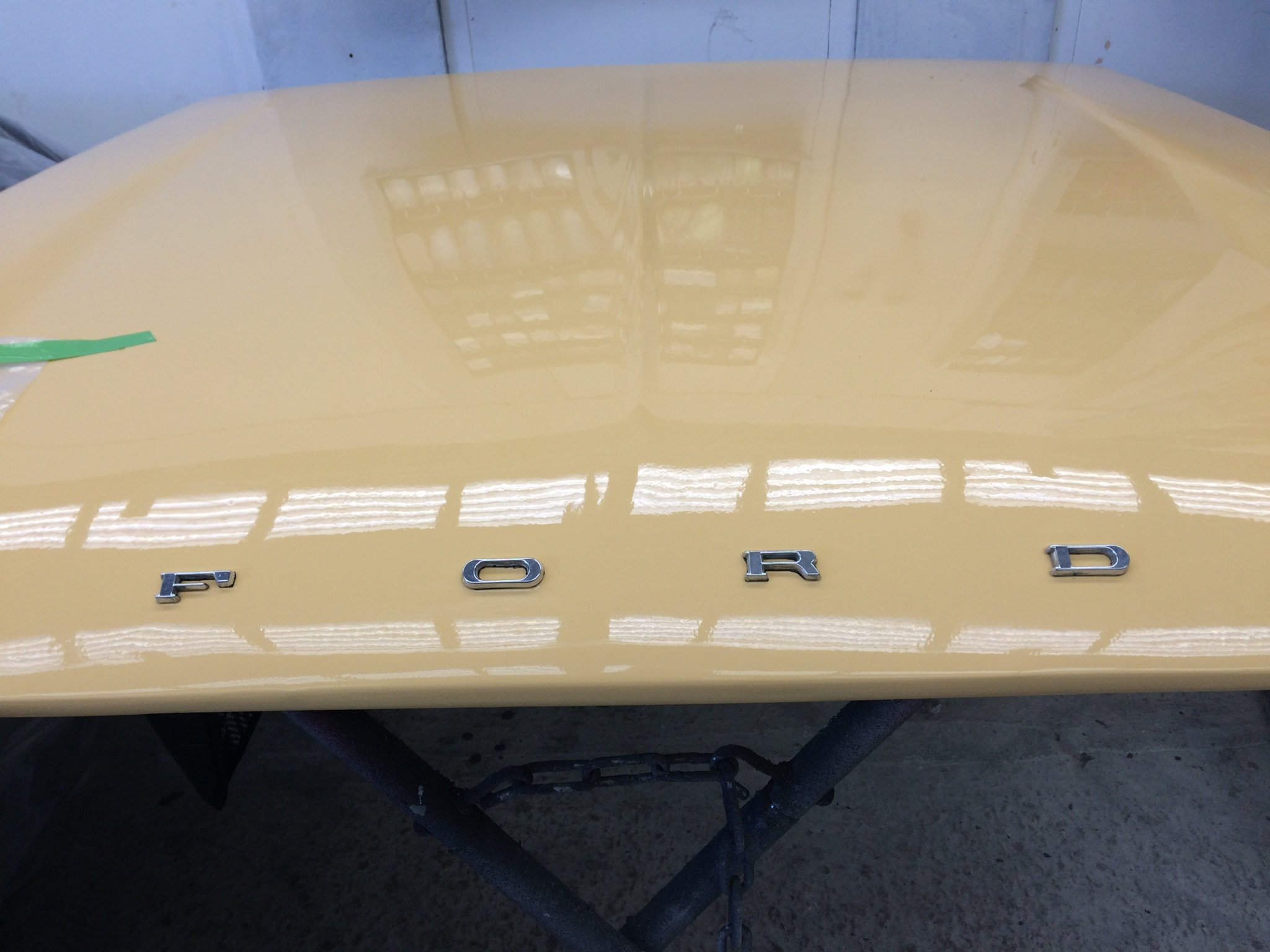

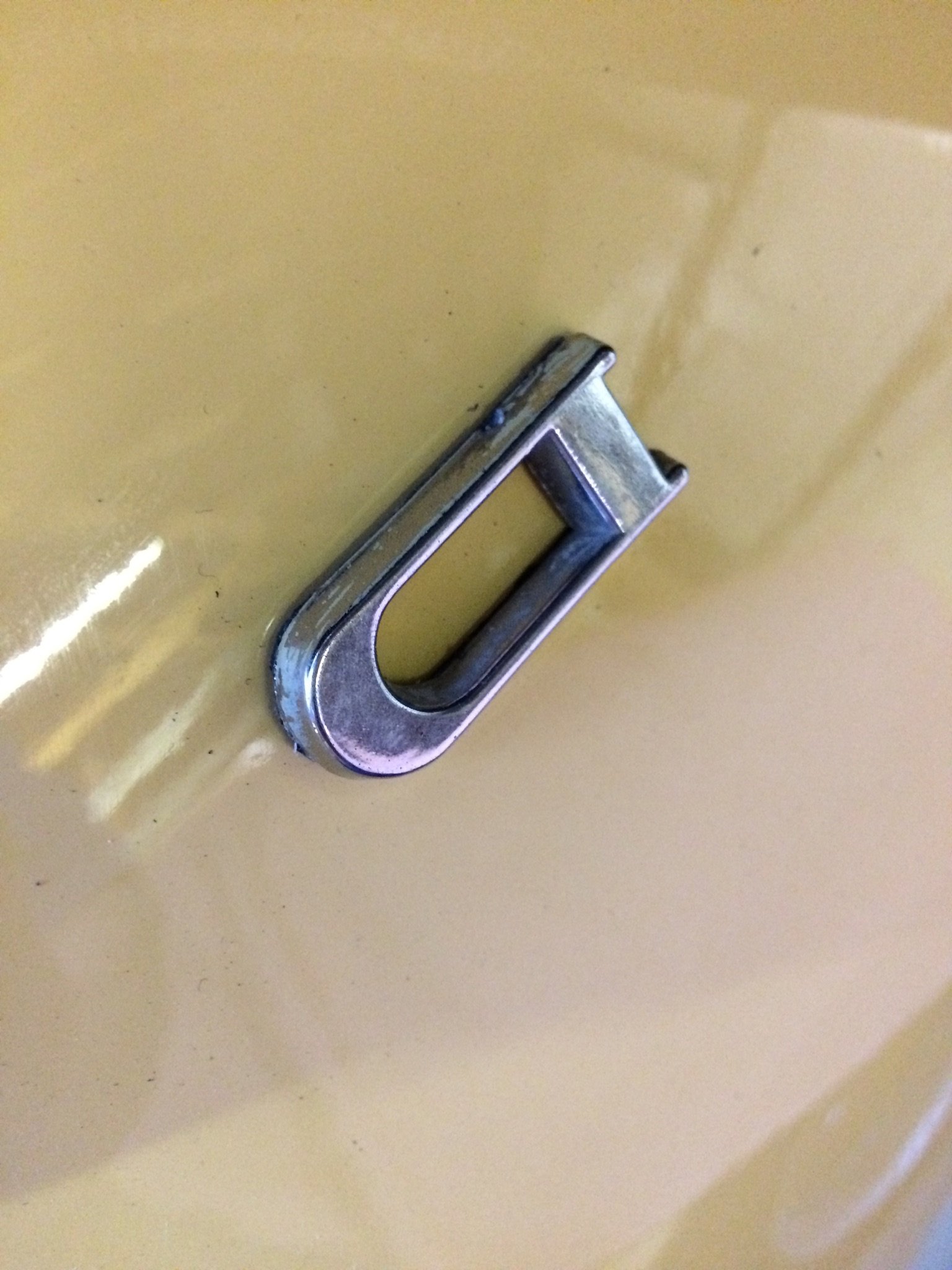

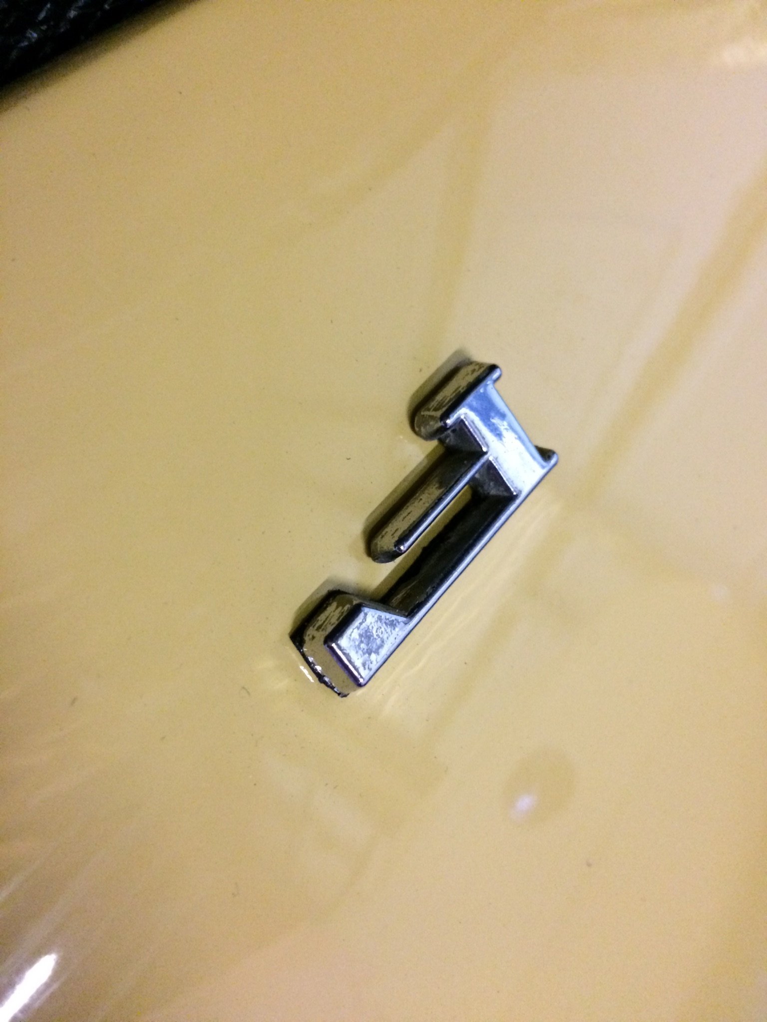

Huge Posted June 25, 2020 Report Posted June 25, 2020 Just had my bonnet re-sprayed & gone for the modern ‘stick em on’ fastening, looks good & no fear of water getting into the hole & causing rust - Huge 1
Moderator Rally Pack 2000 Posted June 25, 2020 Moderator Report Posted June 25, 2020 I didnt know they offered stick on ones. They look just as good.

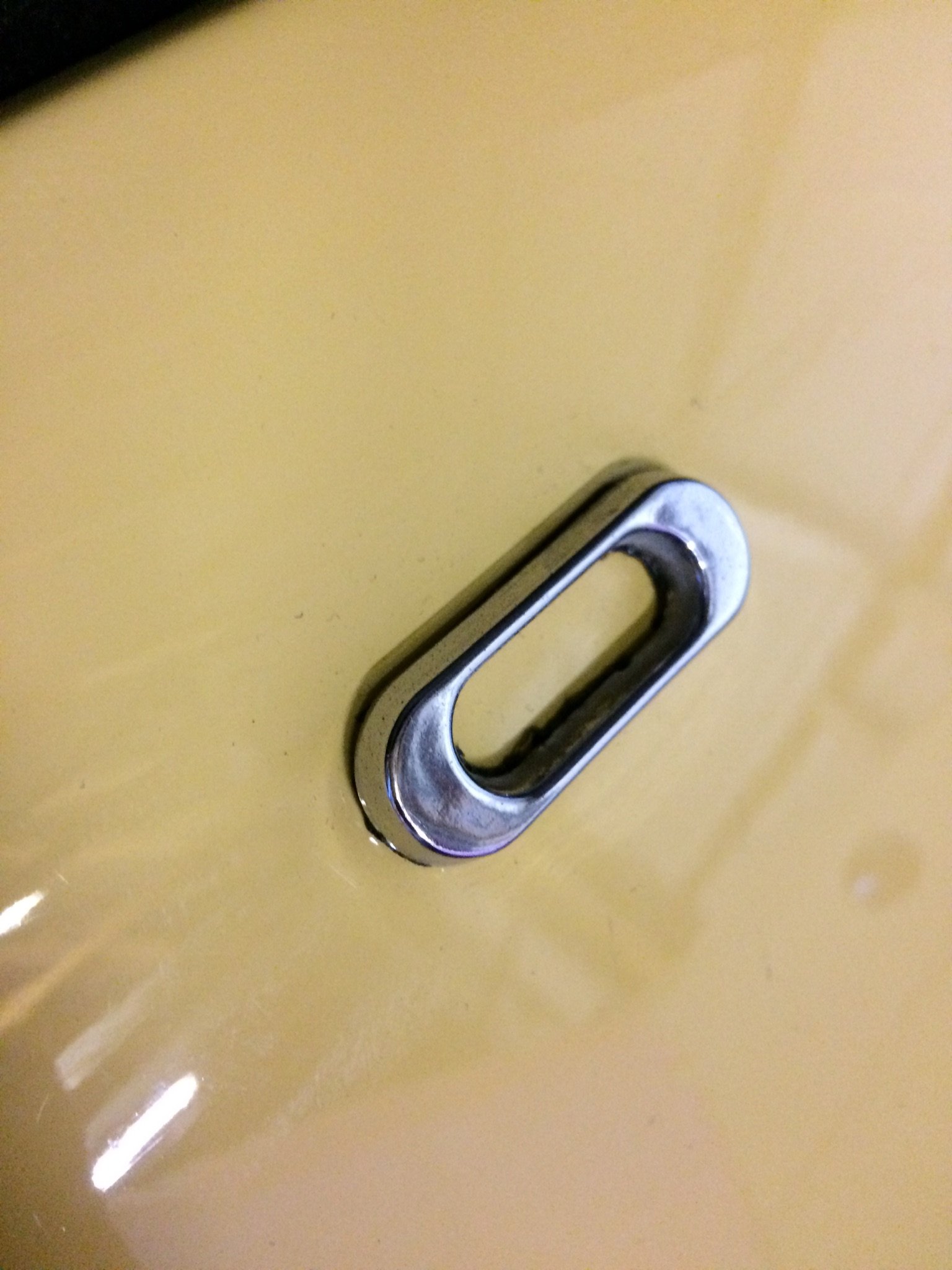

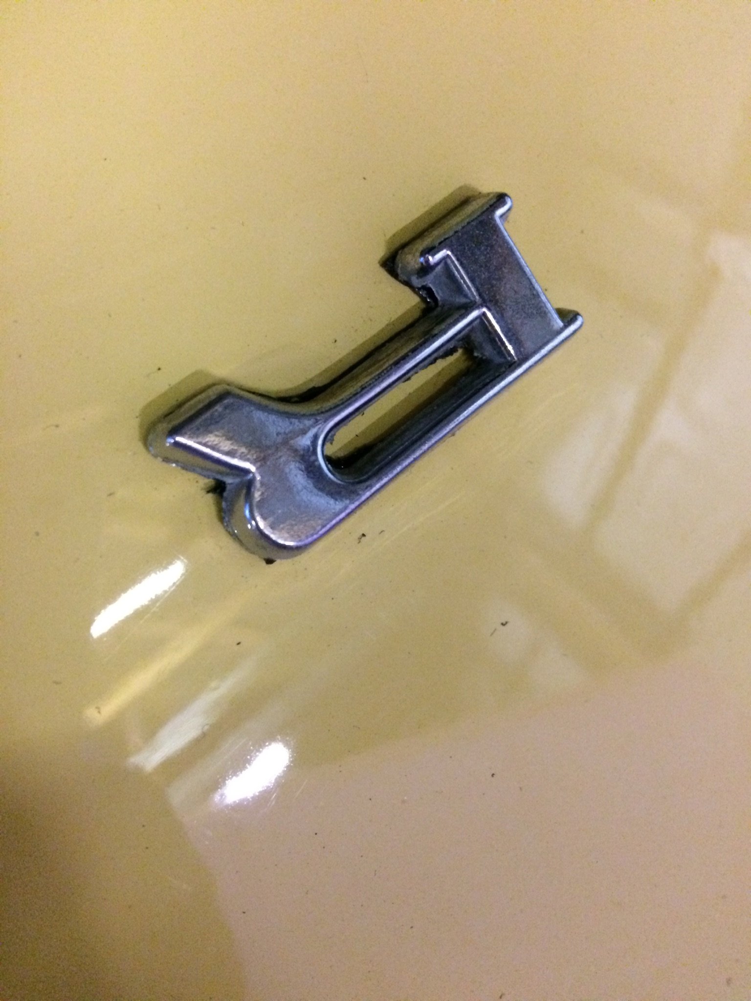

Huge Posted June 25, 2020 Report Posted June 25, 2020 The letters are original Just cut off the pins as couldn’t bare to drill the new bonnet repair & paint.
Moderator Rally Pack 2000 Posted June 25, 2020 Moderator Report Posted June 25, 2020 9 minutes ago, Huge said: The letters are original Just cut off the pins as couldn’t bare to drill the new bonnet repair & paint. Well there you go, no wonder they looked as good. I think you should market that. The oval Ford logos are stuck on after all someone should make stick on Ford letters as well!

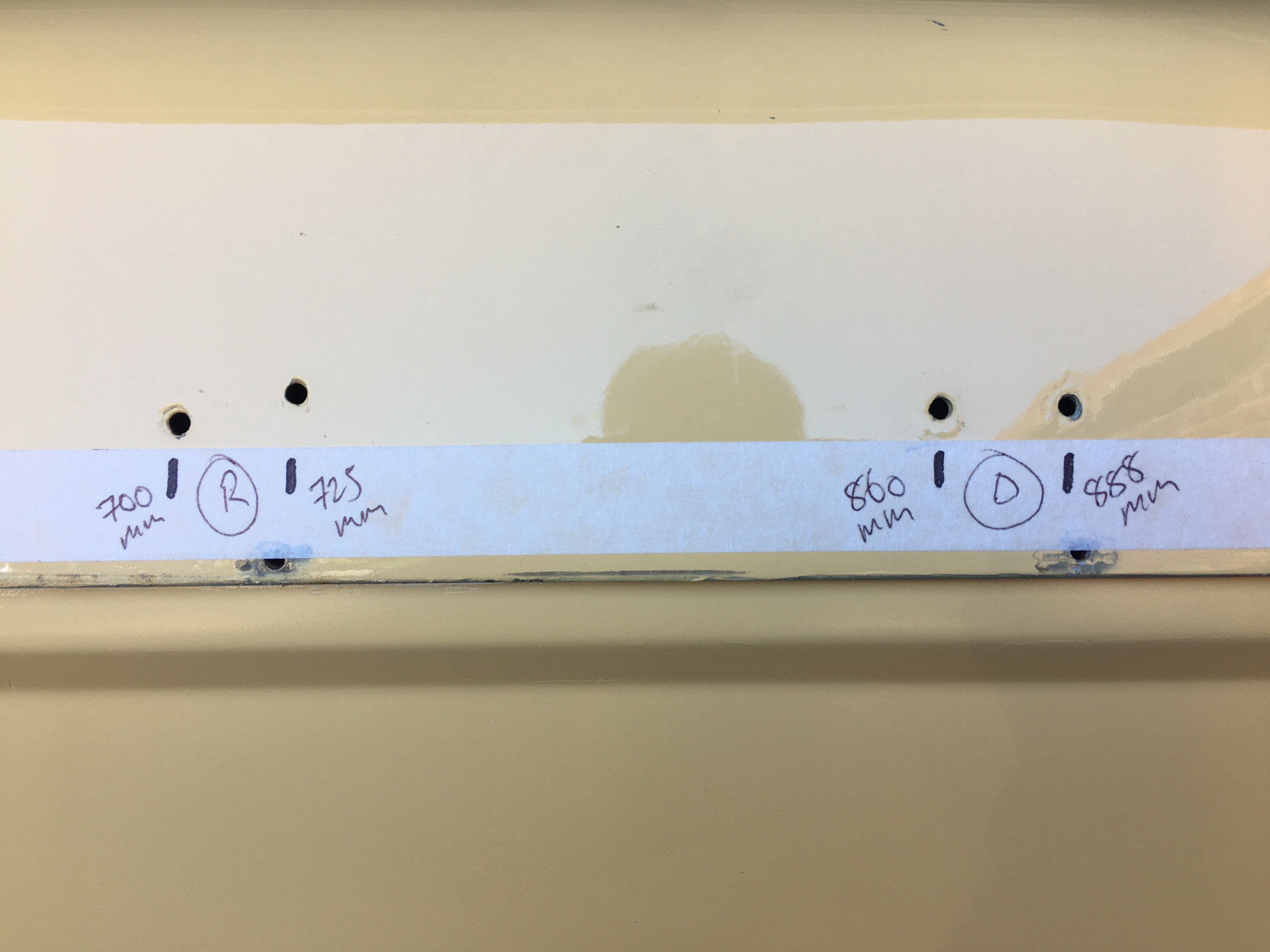

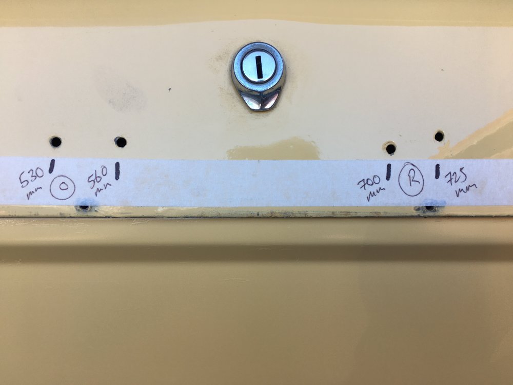

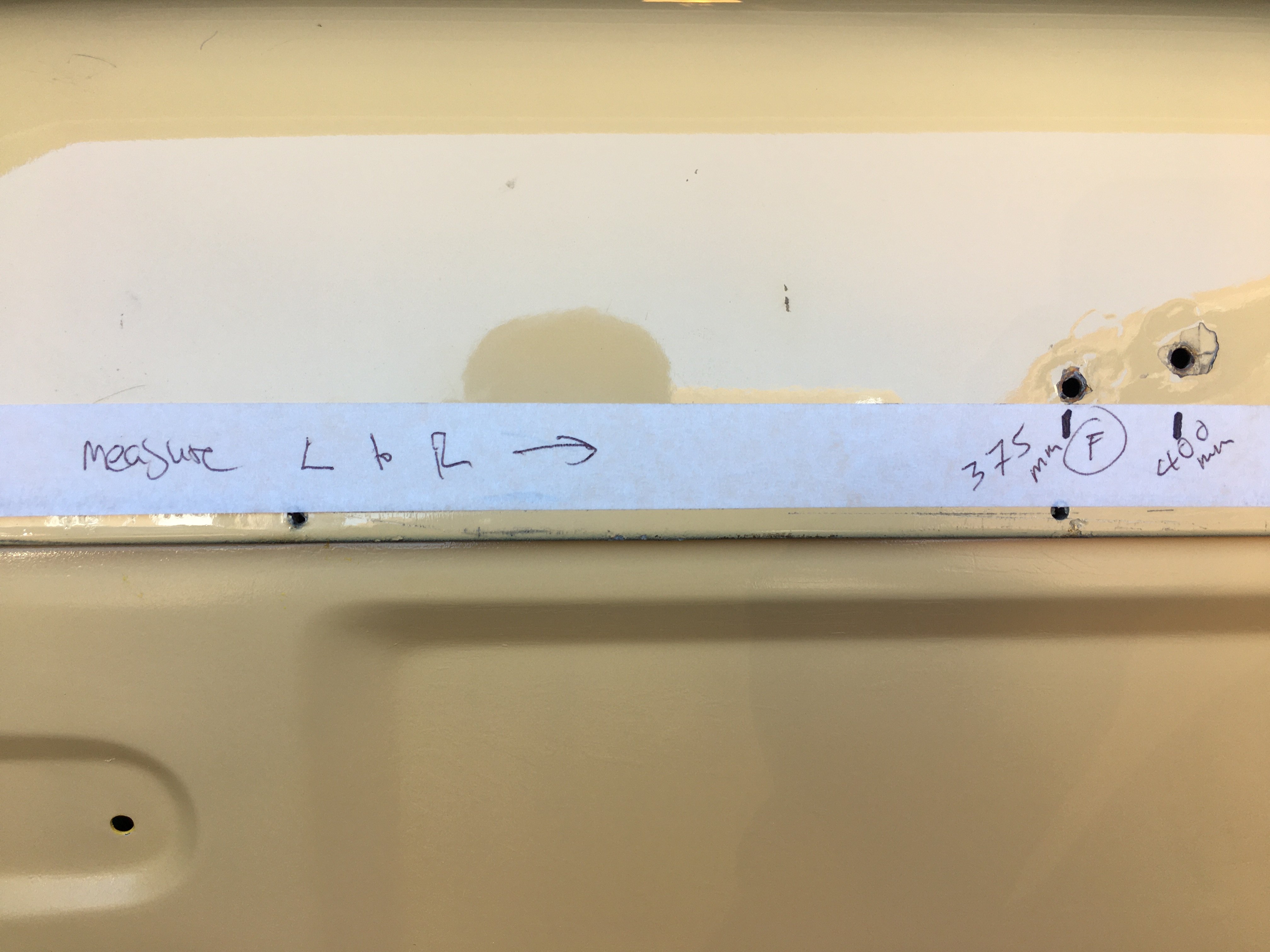

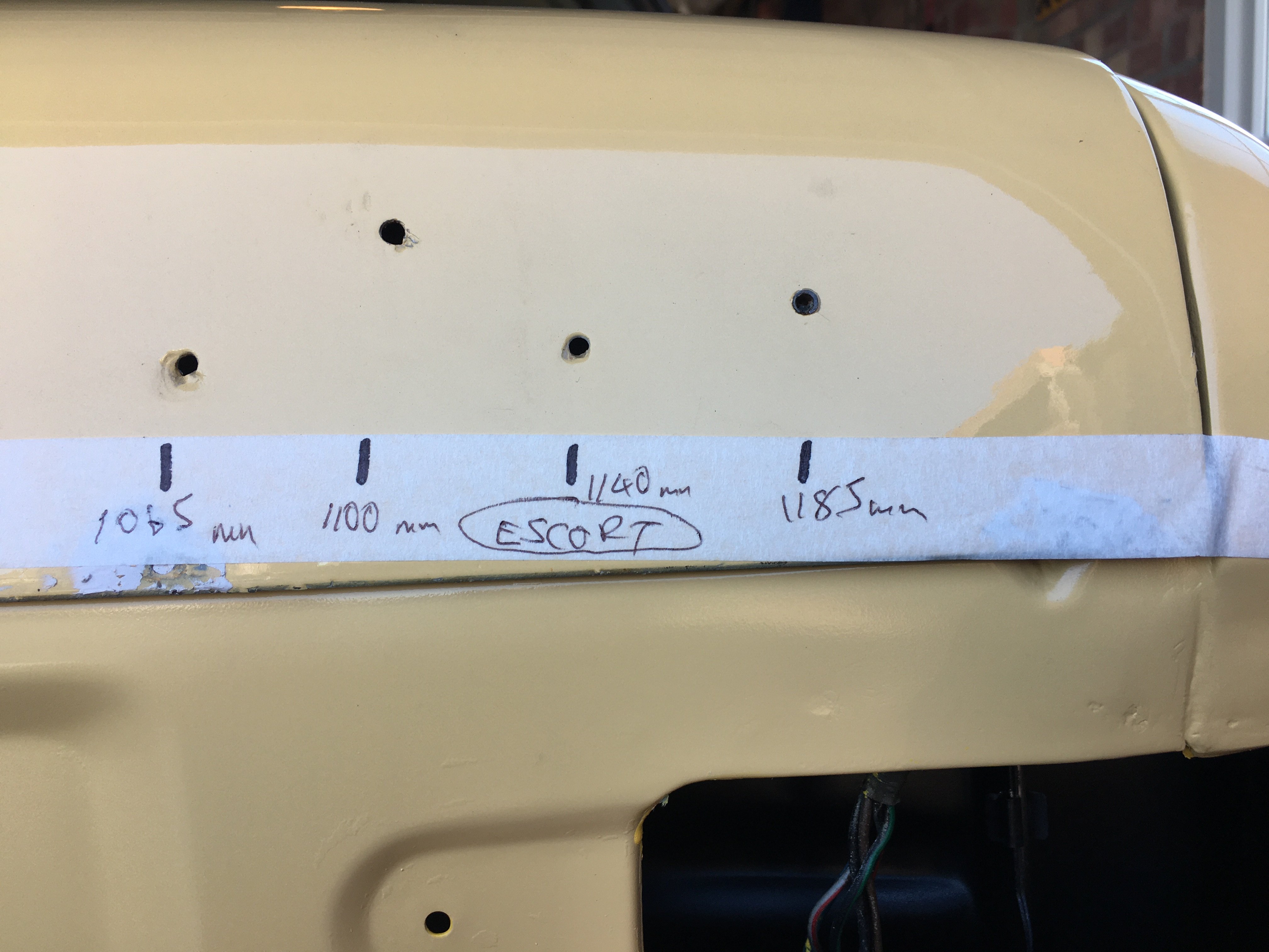

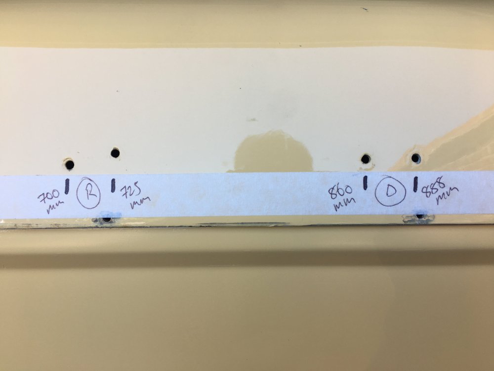

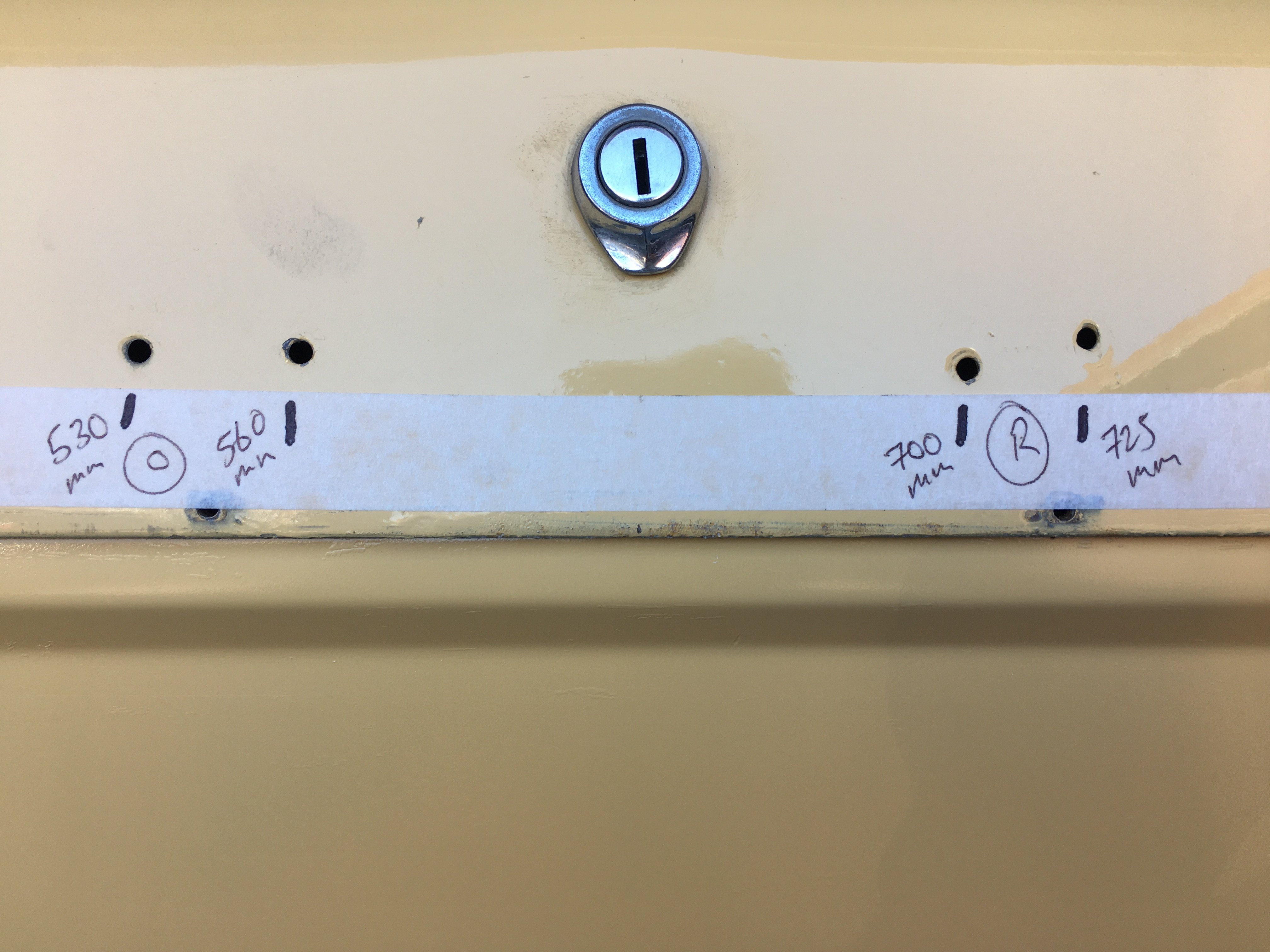

Huge Posted June 25, 2020 Report Posted June 25, 2020 Hi My boot is prepped for re-spray so I’ve taken the measurements if the pin holes b4 they get filled in - hope this helps. Measurements are in mm taken from left to right - Huge 1
Marti Posted June 25, 2020 Author Report Posted June 25, 2020 Thanks very much mate that's great information.

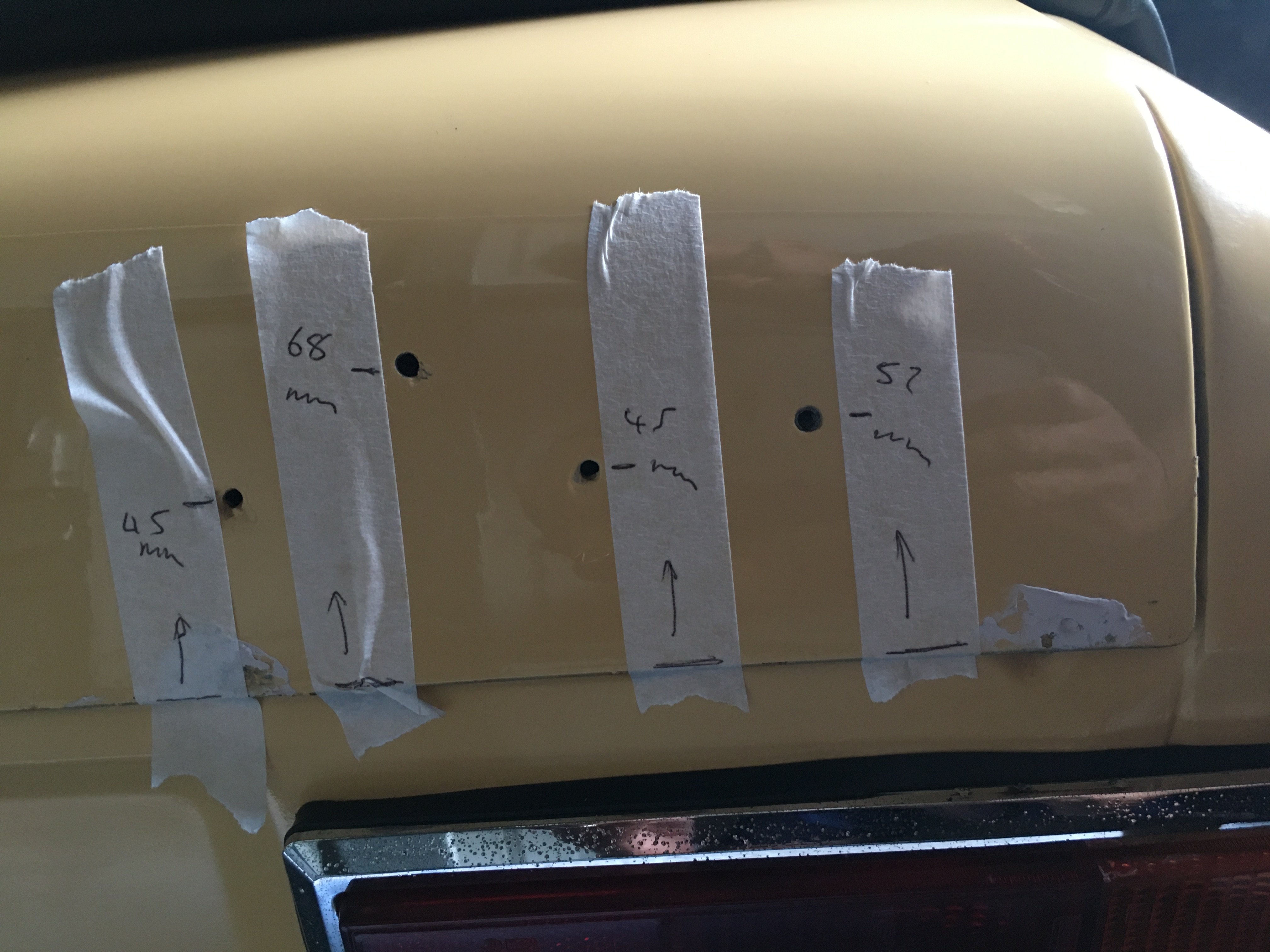

Ray Posted June 25, 2020 Report Posted June 25, 2020 6 hours ago, Huge said: Hi My boot is prepped for re-spray so I’ve taken the measurements if the pin holes b4 they get filled in - hope this helps. Measurements are in mm taken from left to right - Huge have you got some heights to go with that pls, looking really on the escort script badge heights, doing a car for someone and the spray shop filled and sprayed the holes by mistake
Huge Posted June 25, 2020 Report Posted June 25, 2020 My pleasure here ya go ....Huge Ps Sorry I don’t have a bonnet template 1 1

Huge Posted June 26, 2020 Report Posted June 26, 2020 Hello Marti I used the original letters & cut the pins off. I didn’t take a template of the bonnet holes b4 they got welded over & painted so I had to guesstimate where to put the F.O.R.D & thats y I’m not offering up my bonnet measurements cos they may not b exact! I got a specialist body repair chap to fix them on so don’t kno what he used 🤔 Good Luck!! Huge
